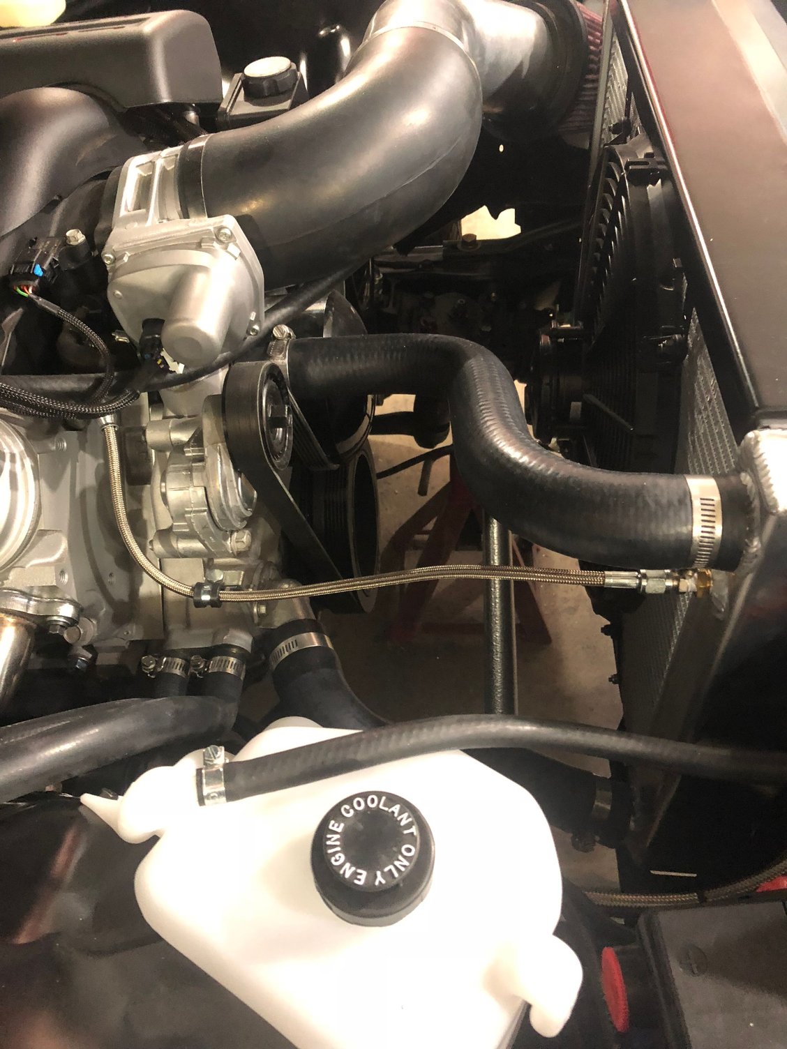

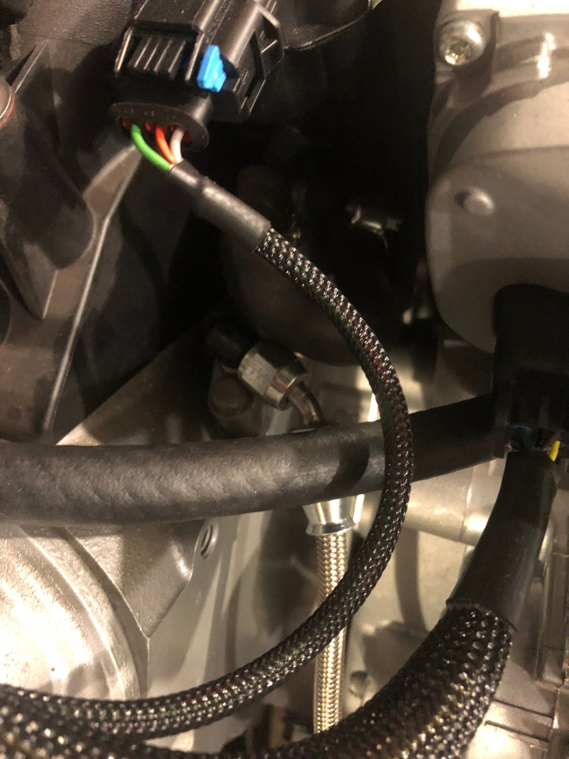

One more thing I like to do on my LS swaps. I use a -3 brake line for the steam line. I cut the nipple off the right side outlet of the steam line and drill and tap for 1/8" NPT.
Then using a 90 degree AN fitting and -3 SS brake line plumb that into a bung I have welded into the generic LS radiator.
Couple of pics.

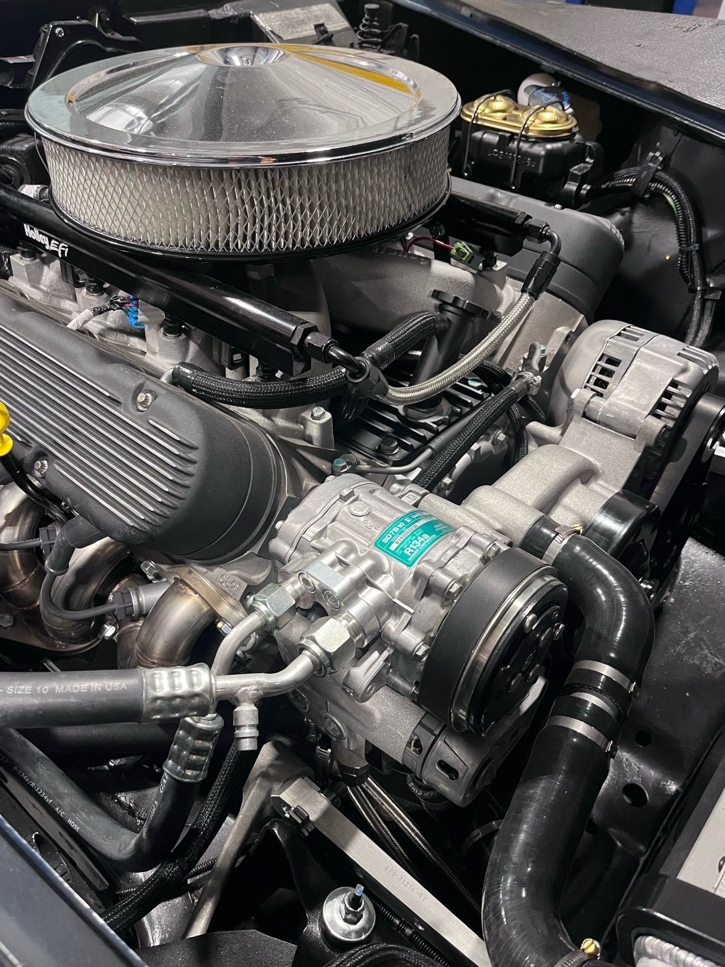

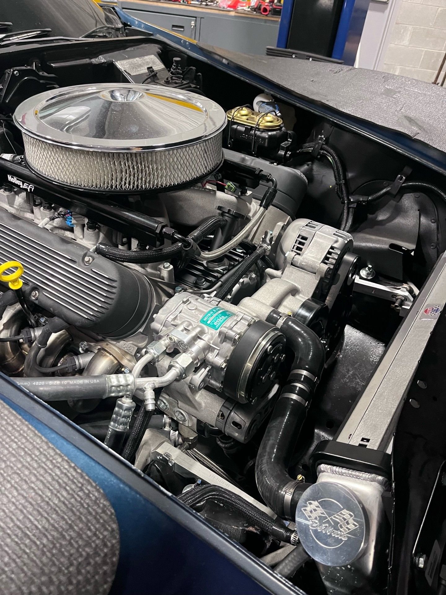

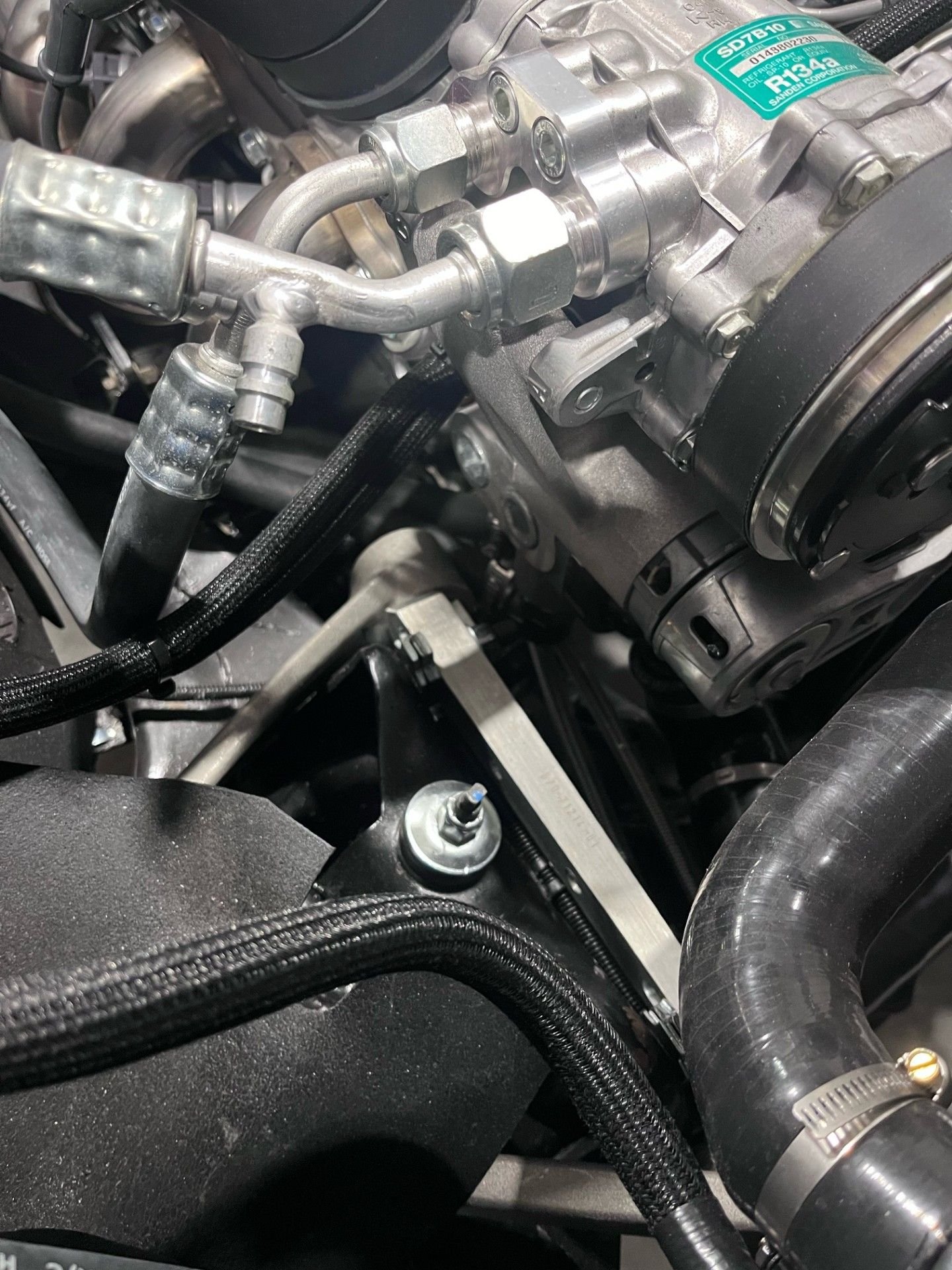

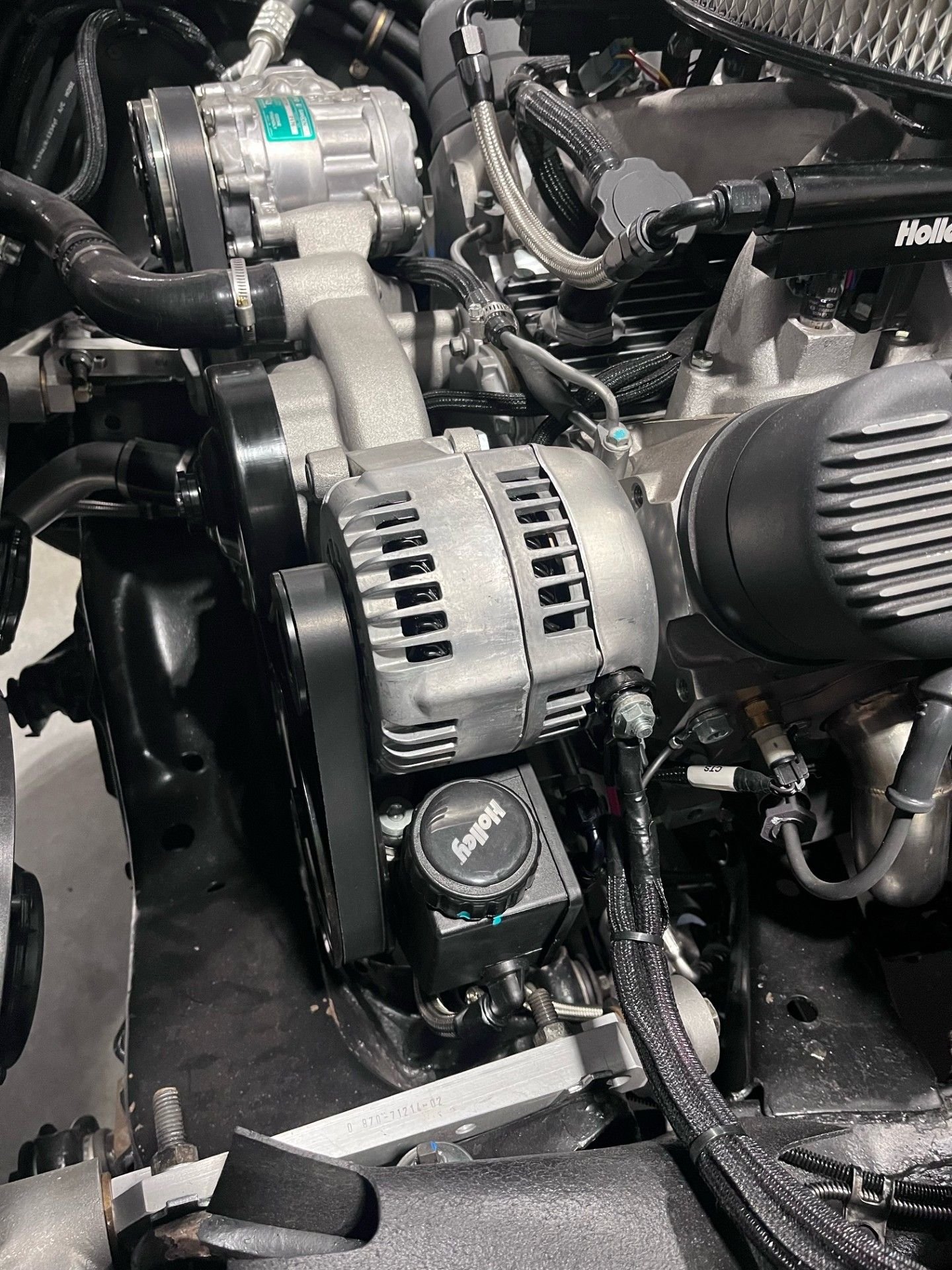

Sorry these pics are big but I wanted you to see them in detail so you could see how much clearance there is. Don't mind the A/C lines they have to be fixed.

J.Abbott
Wow. You have all kinds room with that underside tap! Looks great.
PS-By the way the pictures resize themselves on my computer to fit the screen so they look fantastic.
