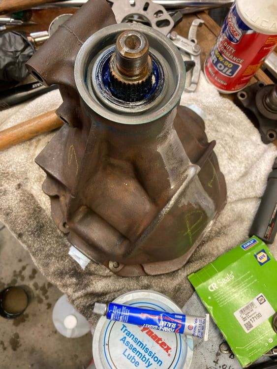

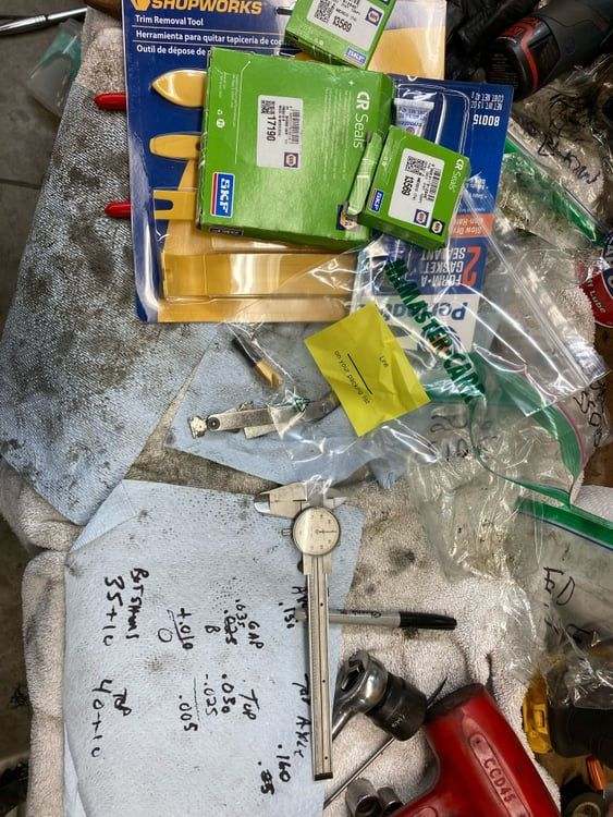

My rebuild here
https://www.corvetteforum.com/forums...#&gid=1&pid=79
skf was recommended, still leak free..

SKF 17190
Have you ever replaced a pinion seal on a C3?
Know the seal flange does NOT get hammered down flush with the housing. You need ~1/8” gap.
Be sure you mark the nut location relative to pinion so you don’t crush the crush sleeve further.
Be sure to seal the splines.

No I have not. I have read several forums and plan on reading a few more. I intend on indexing the nut. Then measuring how much the current one sticks out. Remove old, tap in new just so I can get the nut back on. Using the nut, I will gently press in the new seal until the depth is correct and my index marks are hopefully close. I will seal the splines.

Before reinstalling the pinion yoke, thoroughly clean the splines on the pinion and the yoke. Apply a thin coat of Permatex to both (not so much that you push the excess into the bearing rollers).
