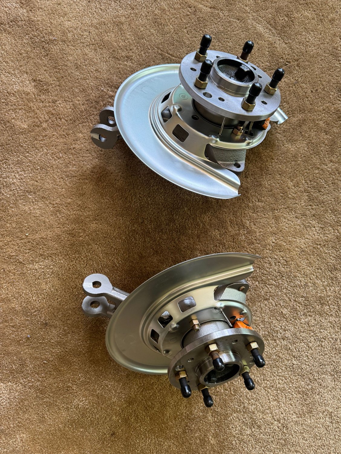

If you’ve never done the rear bearings before, they’re nothing like the front. Much more involved that requires more precision tooling. It’s one of the things I sent out rather than doing myself.
I was able to get my shock mounts out without issue after spraying every threaded connection with a 50/50 mix of ATF and acetone. No cutting, torches, or massive hammers. Unless something changed from ‘70 to ‘76 you shouldn’t require any special tools, just a punch to drive the mount out all the way through the strut rod.
If your rear wheel bearings need servicing I would also be checking the condition of your trailing arm and strut rod bushings. Chances are they could use replacing too.
