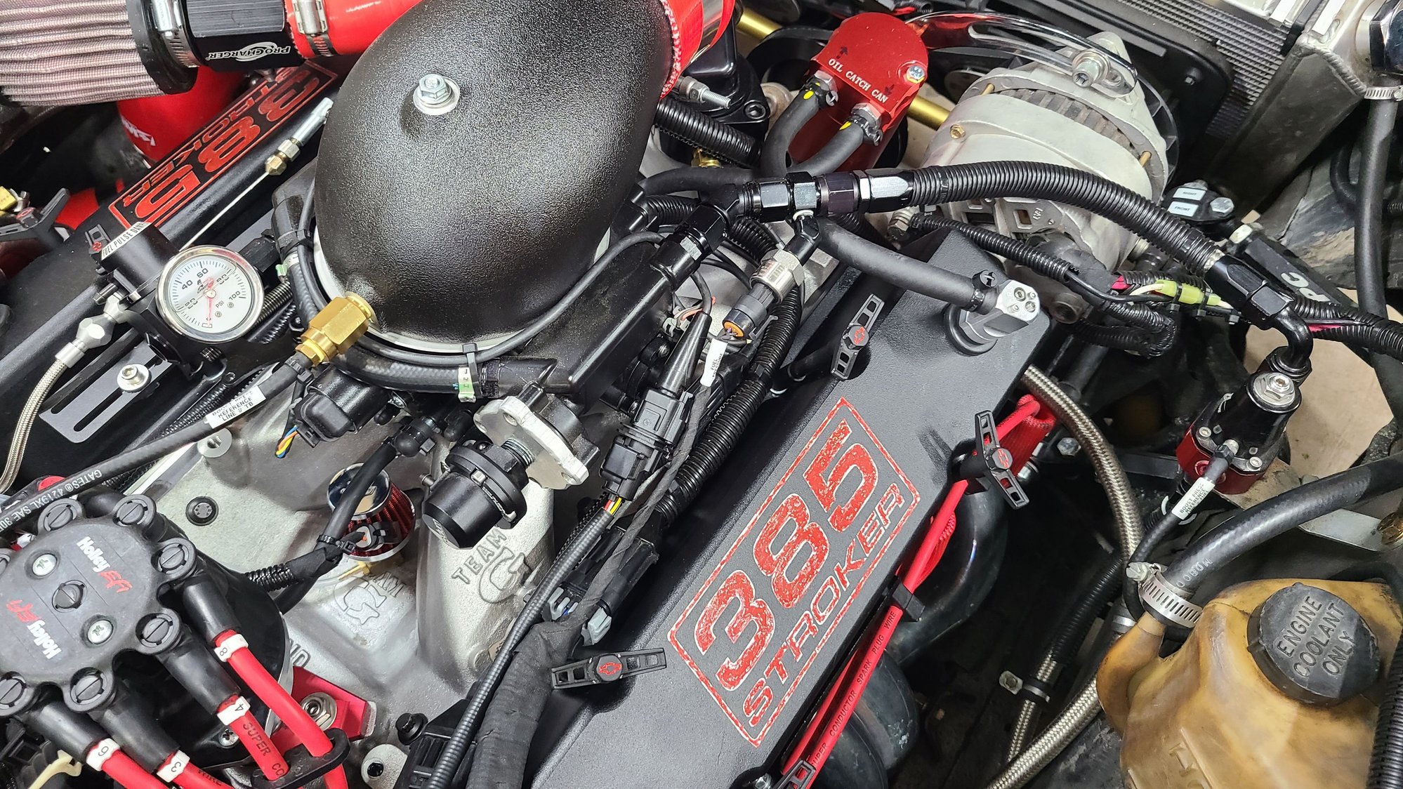

Yes, many have done the external regulator. In fact, the internal regulator in the Sniper 1 is considered junk by most. One of the first things I recommend to Sniper users (besides ensuring they run the main power leads directly to the battery) is to NOT use the internal regulator. I have completely removed the internal regulator and put a block off plate there and added a pulse dampener instead. I went straight to the external regulator due to my boosted application, but I'm glad I "accidentally" moved on from the internal regulator. In fact, the Holley abandoned the internal regulator for Sniper 2. That shows how reliable / effective the internal was.
A picture is worth a thousand words...
You can see the Aeromotive regulator (boost referenced) to the right. Then there is a Radium pulse dampener on each side of the fuel rail. Having two is overkill, but I had two because of a different project that ended up going in another direction. So I installed both of them.
I hope this helps!
