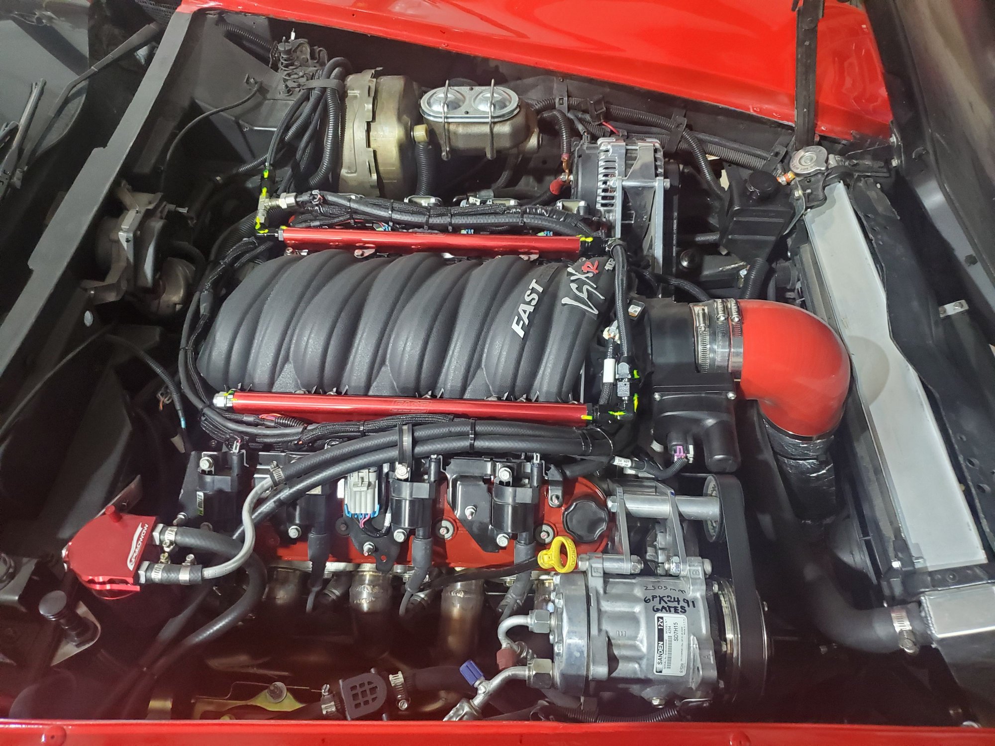

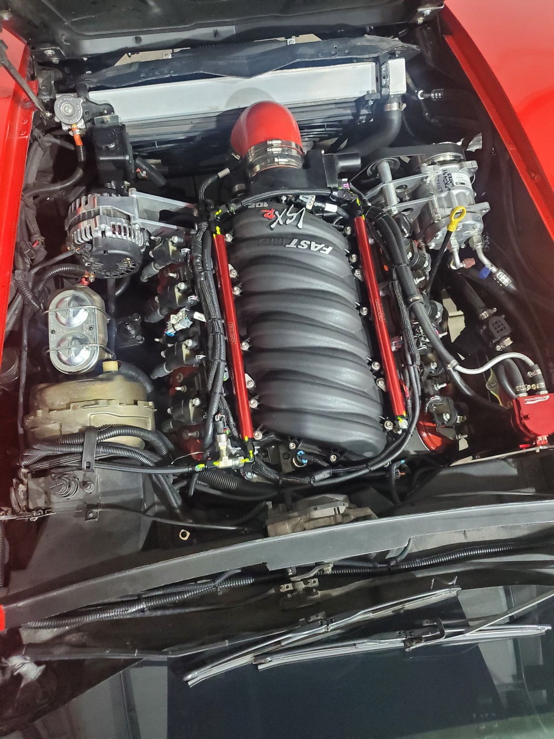

Share some pics of the engine bay!

Old Jul 25, 2024 | 01:42 PM
82LS7's Avatar
82LS7
Joined: Oct 2022
Posts: 90
Likes: 69
Old Jul 25, 2024 | 01:52 PM
82LS7's Avatar
82LS7
Joined: Oct 2022
Posts: 90
Likes: 69
Don't know if anyone is interested in the details but the new 570 Hp crate motor came apart at 1800 miles and sent the heads off to American Heritage Performance for new Mold star 90 guides, Titanium intake, Inconel exhaust, CNC port, mill .030, went with BTR stage 4 Cam Johnson Roller link bar limited travel roller lifters, 3/8 one piece pushrods, Titanium connecting rods, 102 MM TB FAST intake, custom equal length SS headers, and stuff, I write my own Fuel and Spark tables with the Holley Terminator X Max, currently at 12.2 to 1 compression with a top secret quench ht of...........032, ok, my secret is out of the bag.......

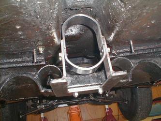

I was racing and had really high drive shaft rpm with OD auto tranny. I've never had a drive shaft problem or worn out the ujoints with billet caps. Chromemoly drive shaft
This hoop is sold through summit racing for like chevelles with it bolted to the floor pan. I just flipped it over and welded it up to flat bar stock and cross member. It passes NHRA tech inspection

Nice DL Loop, either way, accidents do happen, unforeseen failures happen all the time. There are a lot of folks going to carbon fiber for the safety aspect.
