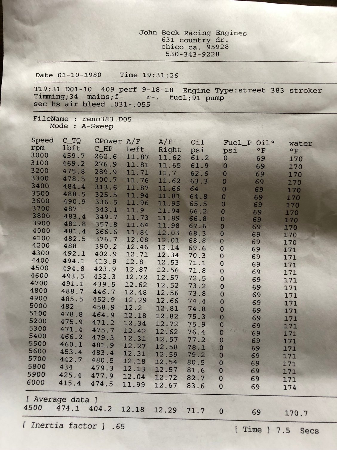

C2 of Year Finalist (appearance mods) 2019
Skip White performance puts together some really nice aluminum inexpensive heads that make great power. Here is my 383 with his heads and cam. This thing pulls like a freight train out of a slow turn maybe to hard
I know the date is wrong
these are the same heads as AFR sells as the enforcers... if fact I think they have transitioned to just carrying the AFR enfocers under afrs branding and machine work now..
I would but a cast rotating assy with hyper flat top pistons and 64cc chambered heads if I were the OP based upon what his wants and needs are. much better than whats been in the car for the last 50 years.
