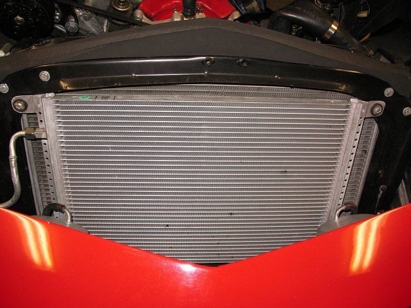

So to fix that I swapped the condenser out for a modern parallel flow unit and I installed a freeze cut-off switch that was OEM on late 70's GM pickups. It has a copper tube you stick into the evap box and then you connect the switch inline with the compressor clutch wire.

End result works well. Vent temps in the mid to low 40s. I rarely have to turn it on full blast, only when it's been sitting outdoors in the sun on a 100F day. Otherwise setting it to "Normal" with fan speed 2 is plenty.
