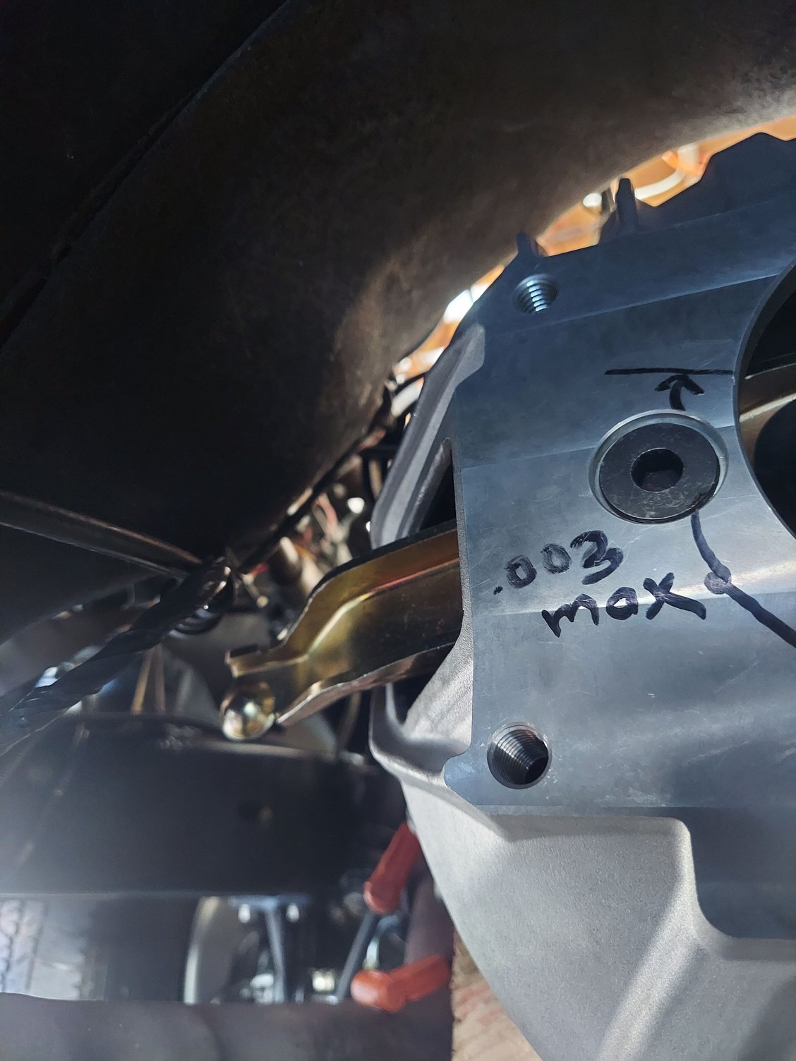

In converting from an automatic to TKO, I purchased a Bell housing that came with the clutch fork, and supposed to be for a Corvette, but the fork looks like it would mate to a "ball joint: rather than a pin/clevis. Does anyone have any insight? Is there an alternate linkage, or do I need to remove this fork and get a "correct" one. Some advertisements for the corvette fork show the same fork I have, but the linkage I purchased does not match.

From today, This help? Corvette clutch fork dimensions

It helps scare me further with buying aftermarket parts - Ha ha . But seriously, Thanks for the input/links. I'm going to have to do a "Deep dive on dimensions, etc. So far it's looking like the one I have is definitely wrong.

Looks like you have the incorrect clutch fork. This should be what you need...
https://www.corvettecentral.com/c3-6...k%26count%3d27

Thanks - My new - new one, should be arriving anytime now.
