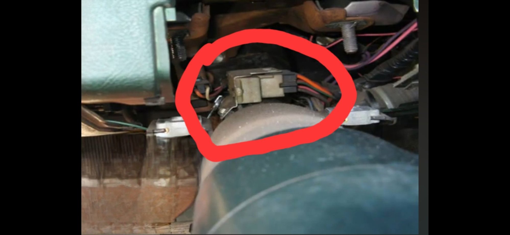

Hello everyone.
So the ignition switch is along the steering column. This switch is mechanically connected to the lock key by a small rod.
Has anyone already disassembled this part ?
Thanks for your help!

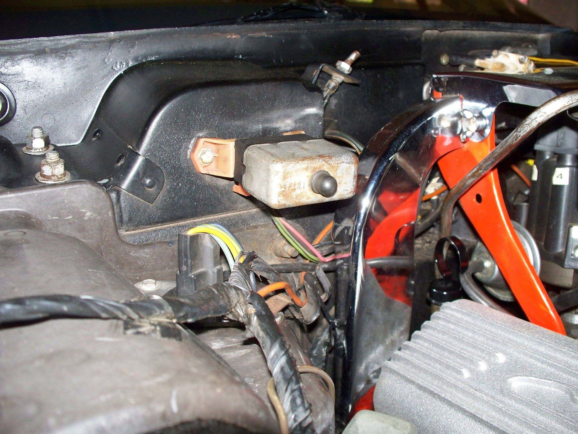

Originally Posted by bruiser
I think the 1974s have a starter interrupt relay on the firewall.
I hadn't seen this post, I'll look at this one before disassembling my steering column. Thanks Bruiser for your picture

Hello, this is not a starter relay but the seat belt relay.
It prevents the starter from working unless the seatbelts are on. Most people bypass it because it causes problems.
https://www.mamotorworks.com/corvett...tbeltinterlock
