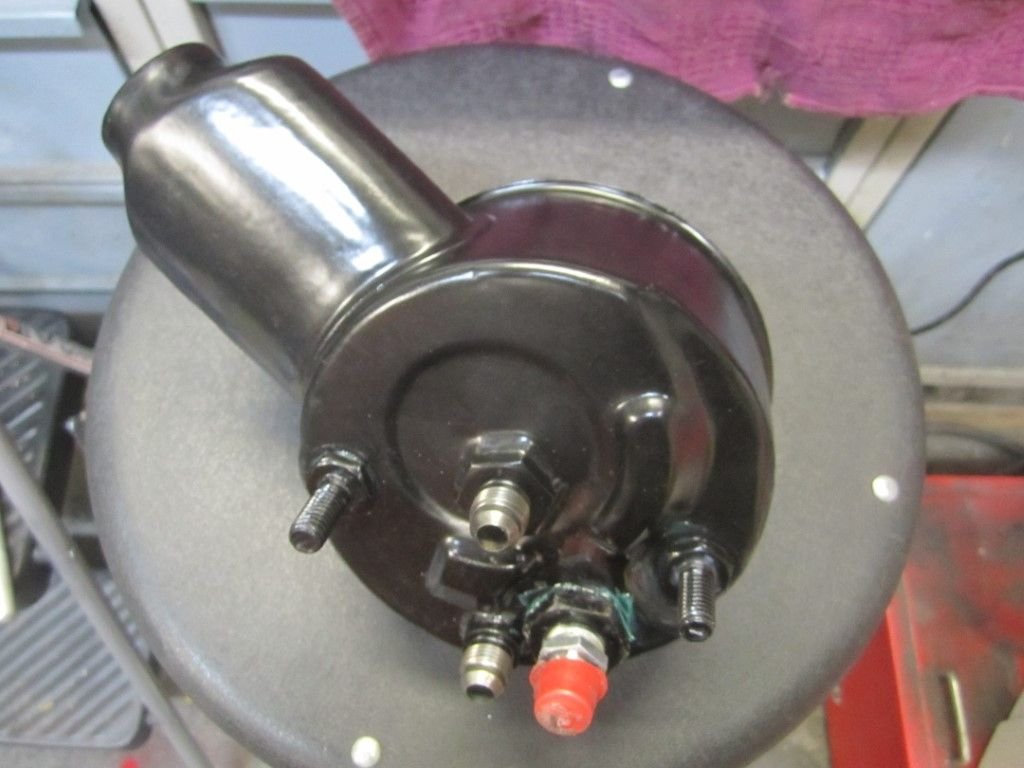

Originally Posted by danthony
Hi all,
2. The power steering pump looks like a replacement as well. Similar question but in addition, does anyone have a picture of the BB pump to compare the shape.
Thanks All!
ignore the extra fitting, I added it as a return for the hydroboost brakes
M
Thanks!
Looks like mine, it may be the original. I'm thinking either rebuild or just buy the pump and use the existing canister. Very helpful.
