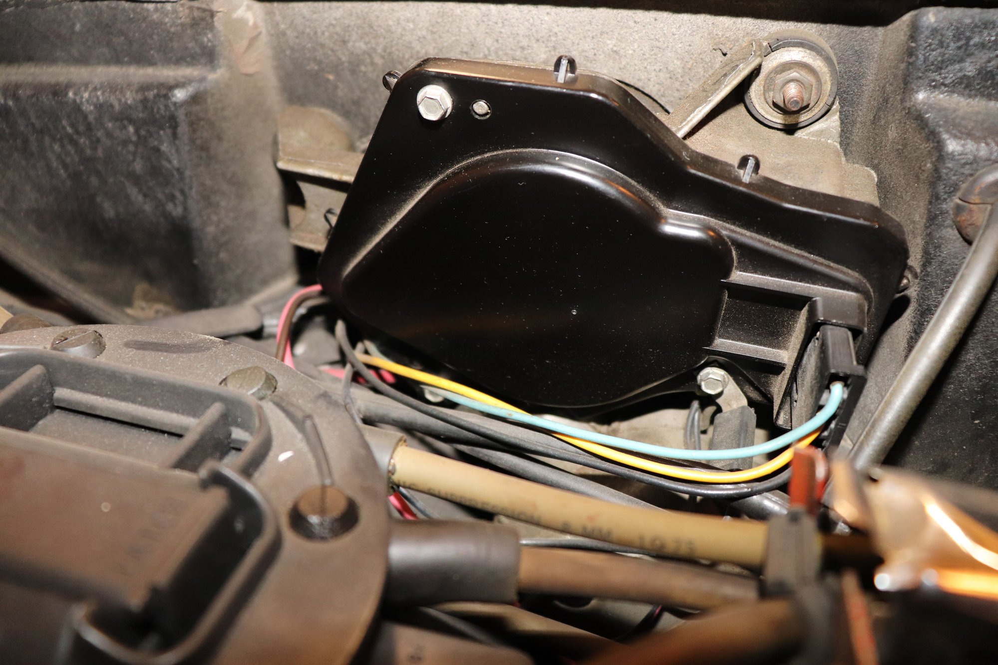

Hello Old CarBum,
1975 and newer C3 wiper motors do not have an attached washer pump. The pump was relocated to the bottom of the reservoir for Model Year (MY) 1975.
See if this might work for you. Pic is from my 1975
Wiper motor from my 1975
Hope this points you in the right direction

Originally Posted by '73and'75
Hello Old CarBum,
That's what I did on my '71 and I put an electric pump in my reservoir. Easy to do and works great.

Old Feb 15, 2021 | 08:12 PM
69ttop502's Avatar
69ttop502
Posts: 6,240
Likes: 1,013
From: Watkinsville, GA and Glen Cove, NY
Greg, I just pulled the washer pump off of my 69 motor and bought the 75 and up washer pump cover, the one 73and75 posted above. Perfect! I eliminated all vacuum as well.

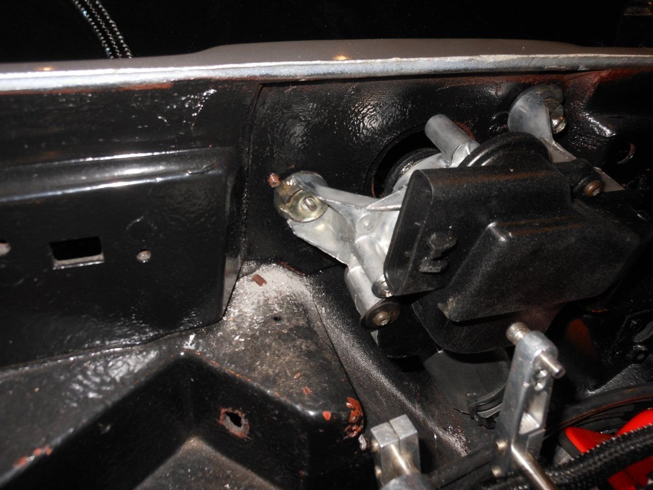

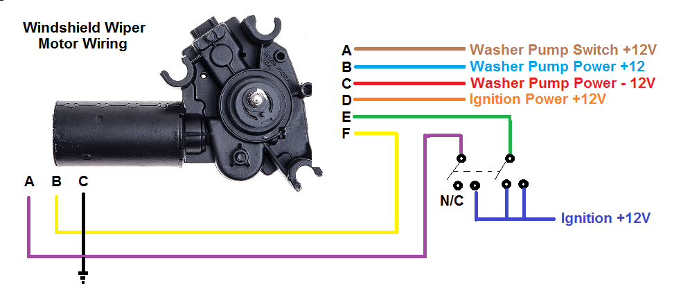

I sourced a late 80's BOP (Buick Olds Pontiac) wiper motor for $65 NOS. Clocked correctly for a C3. Smaller - more efficient and a better design than the old bulky motor.
Cardone part number 40-184- the original part number is 22072788 then superseded with 88961292
If you wanna find it in the junkyard you can get one with the board and motor for easily under $50- eBay listings say the motor comes from Buick Century- Olds Cutlass-Pontiac 6000-Chevy Celebrity
Instead of ground switching like the OEM - modding and running +12 through the OEM switch is pretty straight forward.
If no washer is needed- the wiring is further simplified
These motors have the park feature- and 2 out of the three holes line up as far a mounting- just requiring one extra hole.
Working-
Wiring-
Mounting-
Working-
https://youtu.be/jcv6laxIMTI
Wiring-
Mounting-
No wiper door I presume.
yep and nope 73 and 71 Will work w/ wiper door- using original vacuum or electrically as I have converted mine.
The wiper door is electromechanically switched to open-
When you turn on the wipers - the solenoid behind the dash on the tach - switches the vacuum for the wiper door to open.
The wiper motor doesn't see it's power till the door is fully opened by the switch on the firewall. See attached diagram.
And conversely not till the wiper's arm is parked- does the door go down via the mechanical vacuum switch.

Old Aug 2, 2024 | 08:26 PM
LINY Kevin's Avatar
LINY Kevin
Joined: Feb 2017
Posts: 75
Likes: 16
From: Holtsville NY
Back from the dead. What year is your car? Just bought the cardone wiper motor and the bolt holes line up on the 2 inside but not the passengers outside. Not a big deal. I can drill and use a nutsert on the outside passenger side, but the real question is, it appears the wiper motor rotating stud is much further recessed inwards (towards the engine compartment) then the original. Did you have to do any modifications there? Also seems like the motor itself hits the firewall before the lowest bolt can make the motor flush to the firewall. Also so everyone else knows, cardone does not ship the cover plate with the motors so it's an open gear box. The stock cover I have didn't fit but luckily a local guy has one that might work.
