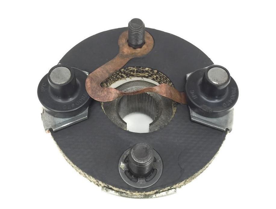

Do you have a 74?? if so I may have a nice original rag joint that will work. I can send a picture later.

Originally Posted by CiCiC3
Sure I'm a lover of original equipment. I'll take a look at it. thx
here is two that I have
as per NCRS dates
135.00 each shipped

Those look much like the one I just took off. Except new I mean. They look great but I ordered one before your message and it should arrive tomorrow. If it looks too goofy I may not use it but I’m in a bit of a hurry to get this finished up. I’ll decide later and let you know. There is another guy who said he is looking for an original’72 after he saw your message the other day. Thx for posting it though.
