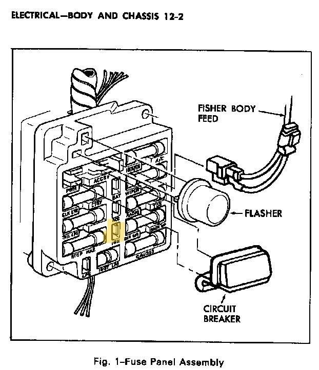

No power at the ignition pin in the fuse box with the ignition in the on position. Is that a clue or does it suggest a diagnostic route? Are there any fuses in play before this pin?
Old Aug 6, 2024 | 09:05 PM
Peterbuilt's Avatar
Peterbuilt
Joined: Aug 2006
Posts: 7,427
Likes: 1,560
From: mount holly NC
Do you have 12 volts on the IGN terminal and if not is the fuse on the left side of the IGN terminal good?
Old Aug 6, 2024 | 09:26 PM
Floydy's Avatar
Floydy
Joined: Sep 2019
Posts: 239
Likes: 31
From: Nashville, TN
The fuse was NOT good. I replaced it and now have 12v on the ignition pin on the fuse box but the car still does not start. My next step is to test the coil / spark plug. Its weird that the engine died exactly as I shifted into reverse.

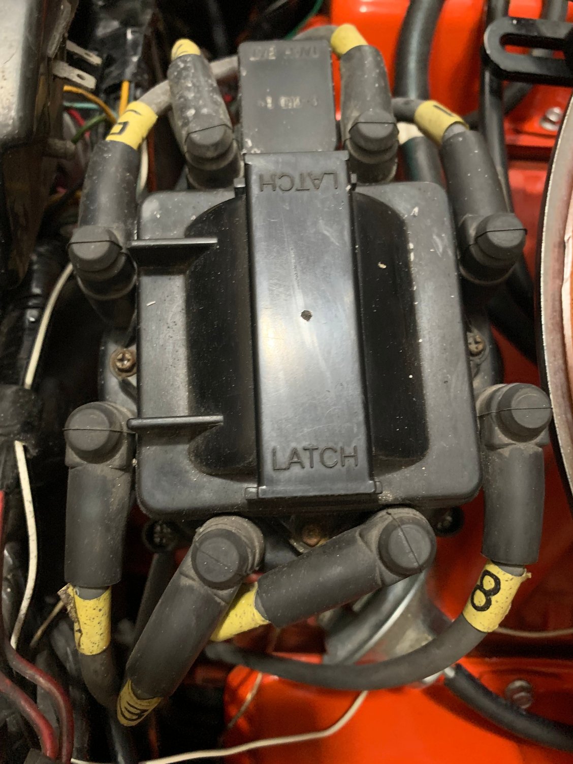

Feeling totally flummoxed at this point. I have a well charged, new battery and 12.4V at the "BAT" terminal of the HEI ignition module with the ignition on. I used a cheap plug tester inline between the distributor cap and the #1 plug lead and can see a flickering glow in the test tool when cranking the engine but still no start. Plenty of fuel flow (I can see it pump and smell it) and the high performance starter is cranking the engine strongly (enough to see movement on the Tach). Not sure where to go from here??. Is it possible the output from the HEI is present but weak? What else can prevent the engine starting? This is a relatively fresh motor that has always started easily and run strongly.

Hi Jerry, thanks for the idea. I've established with high confidence that I have a reliable 12V to the input of the coil. Upon testing the output of the coil with a plug tester inline between distributor and plug I see a weak orange flicker in the tool which suggests to me I have a weak spark. I'm now leaning towards believing I have a faulty coil or a fault in the HEI module. Its the timing of the fault that has me concerned. The engine quit exactly as I entered reverse which is making me wonder if there is a short (perhaps in the reverse switch) that triggered the failure of the HEI module. The concern being that if I install a new HEI unit without finding the root cause I may destroy the new one. Reverse lights don't work on this car now (and not sure they ever did) but I can not locate a short in that circuit so I don't really know. Perhaps the timing of the failure was just pure coincidence?
