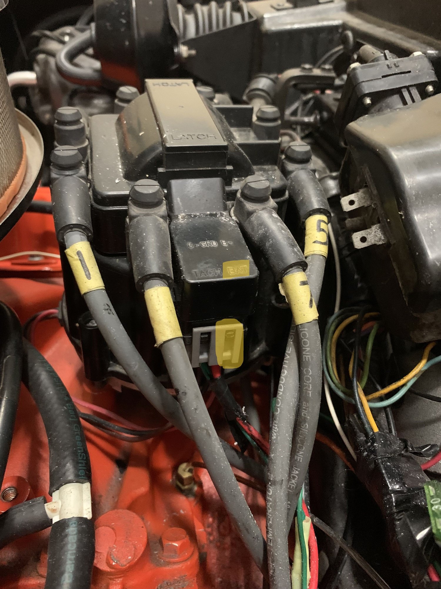

Thanks for the detailed response. In terms checking the 12V supply to the distributor I am checking this pin (see photo below). I am also checking the output of the distributor by inserting a plug test tool inline between the distributor cap and a spark plug lead. I see a flickering orange glow when cranking. My understanding is that I should see a bright blue/white glow for a healthy spark and orange signifies a weak spark. So I think the no start problem is that the spark is insufficient to ignite the fuel. It seems to me this is suggestive of a fault in the coil, fault in the HEI / rotor / cap, or a voltage drop under load. My next step is to check the 12v input to the dizzy while actually cranking and see what it drops off to. I also want to try a different plug tester to see if the result is consistent. I don't think its the leads as I think its unlikely that all leads would go out at the same time(?). I really like your suggestion to double check the timing and also plan to do that.

Hi, Thanks for your ongoing help. Here is my voltage data:
- Fully charged battery with no terminals connected: 12.99V
- Battery with terminals connected and everything off: 12.99V
- Ignition pin in fuse panel with ignition on: 12.7V
- Distributor BAT terminal with ignition on: 12.58V
- Distributor BAT terminal while cranking: 9.96V
- Inline plug tester while cranking: no glow at all now
So.... looks like the resistor wire is still in place?? I do have a wire coming off the IGN terminal in the fuse panel but it is light gauge (16 AWG) and runs up behind the speedo somewhere. It is not the same wire that runs to BAT which is 12 or 14 AWG.

I meant some sources drop voltage completely during cranking (I think the wipers is one). Sounds like you still have some voltage while cranking.
Not sure about how low is an issue. I know I've seen someone state on here that an HEI will fire with a little as ~6 volts. But, I'm guessing everything else in the system - wires, plugs, coil, Module, would all have to be in tip top shape for that scenario to work.
To find out, get another good, fully charged battery (steal it from the wife's car), and ground the negative to the car frame, and run the positive to the BAT terminal on the distributor. But connect it in such a way that you can disconnect it easily, since that is how you will shut the car off if it does start.
This way you are separating the cranking power from the distributor power and supplying a good 12 volts always.

Its good suggestion, I plan to try that this afternoon with a new 800CCA battery. However because the output test went from a weak glow to nothing under the same conditions and voltages, I suspect that there is also a failure in the coil or HEI. My HEI distributor looks older and is a "no brand" of dubious quality. It's a good opportunity to replace the whole distributor with something of known quality (what's another $250 at this stage of the game?). I just want to figure out the battery and voltage drop first so as to not fry a new HEI. Not sure what to believe with respect to acceptable voltages for an HEI. Some say must be 12V in order to work. I do know that based on Ohms law if the voltage drops the amperage has to increase and its amperage that can fry electronic components and wiring. My hope is that a ne battery reveals just slight voltage drop during cranking and if so I'll put in a new dizzy.
