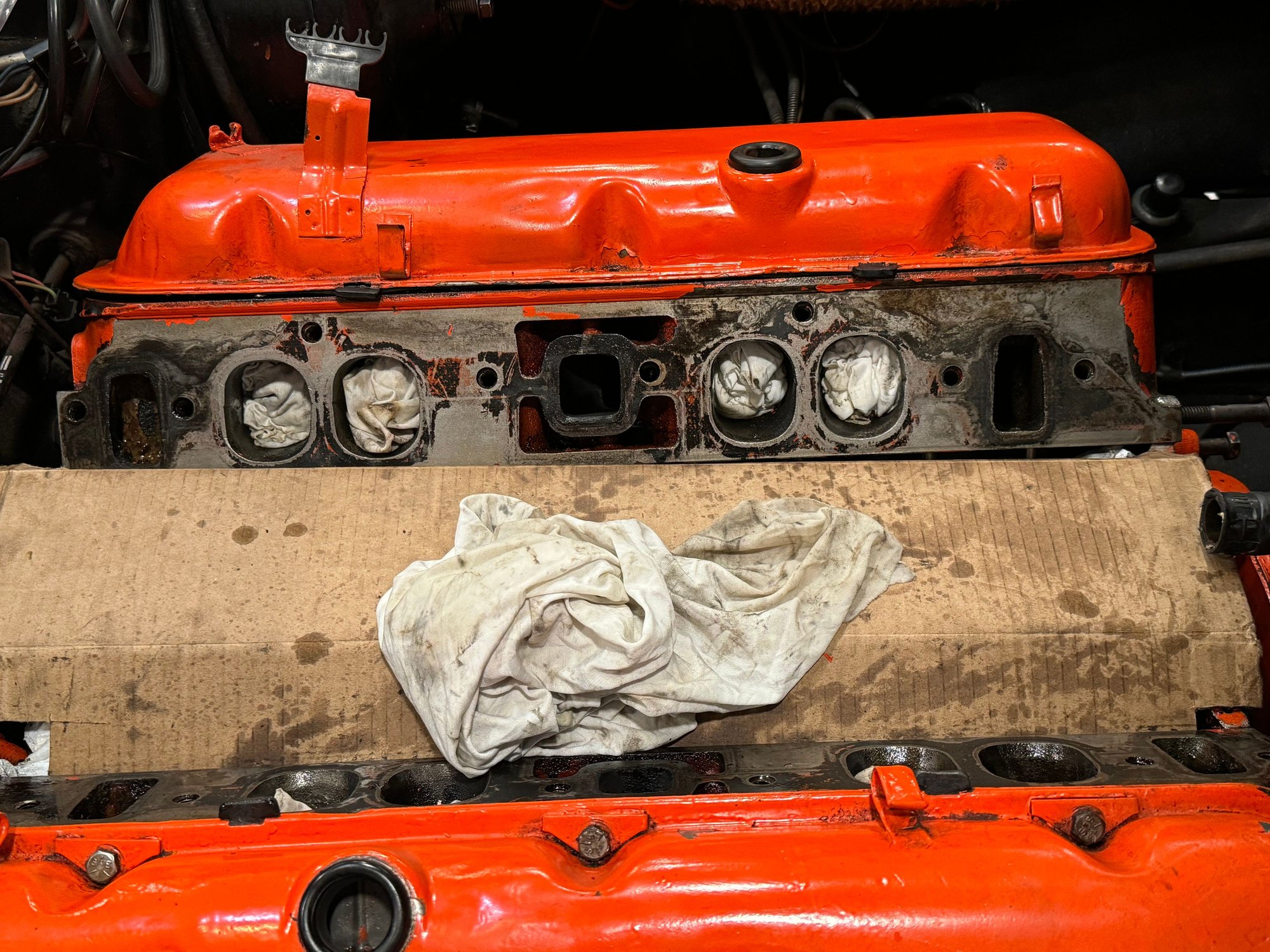

So my question is how clean is clean? I can get a little bit more off the head mating surface but some of that black is baked on and perfectly smooth. I don’t want to go at it with a wire wheel snd risk getting particles thrown all over the engine. I carefully scraped while following the blade with the vacuum head.
Here’s where I am right now. Gonna give it another scrape in a while.

No where near clean enough. 3M makes these little wizzer discs that work really well. Sorry I don't have a part number handy.
otherwise go in the kitchen and see if the Mrs has some of those green scotch bright cleaning pads. They work really well just a bit more effort.
How clean is clean?
That cast iron should look as new. Nothing short of that.

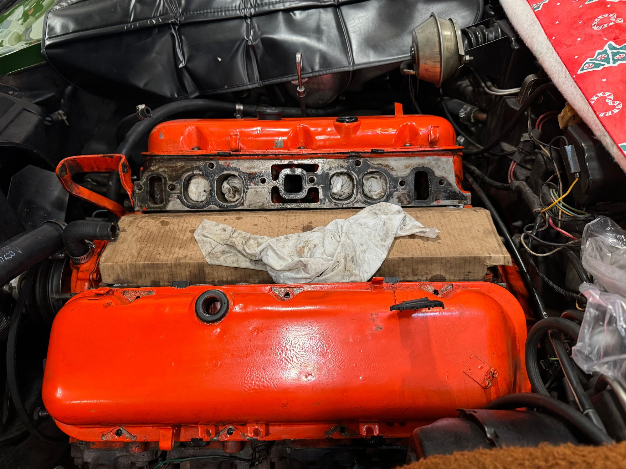

So I went digging for a photo of my engine the last time I had my intake off. Feels like yesterday. But it isn't. Took some digging. So here's my engine. Just ready for final clean up then glue intake manifold gaskets in place.
Zoom in on the gasket surfaces , keep in mind they will still get a final wipe down. Now you know what level your looking for.
Yes, scraping gaskets suck! But it's got to be clean, and straight and flat!

Thanks. Yeah that’s what I figured. I haven’t built an engine in 30 years. Ive continued to work on it and letting it now soak overnight. It looks alot better than the pictures now. I did use green scotch brite and hopefully that with a fresh pack of razors should do it.
