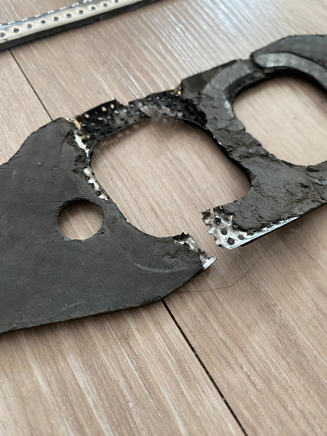

I would check your exhaust manifold gaskets. I had a similar sound coming from my car last year and I found that one of the ports literally blew through the gasket.
