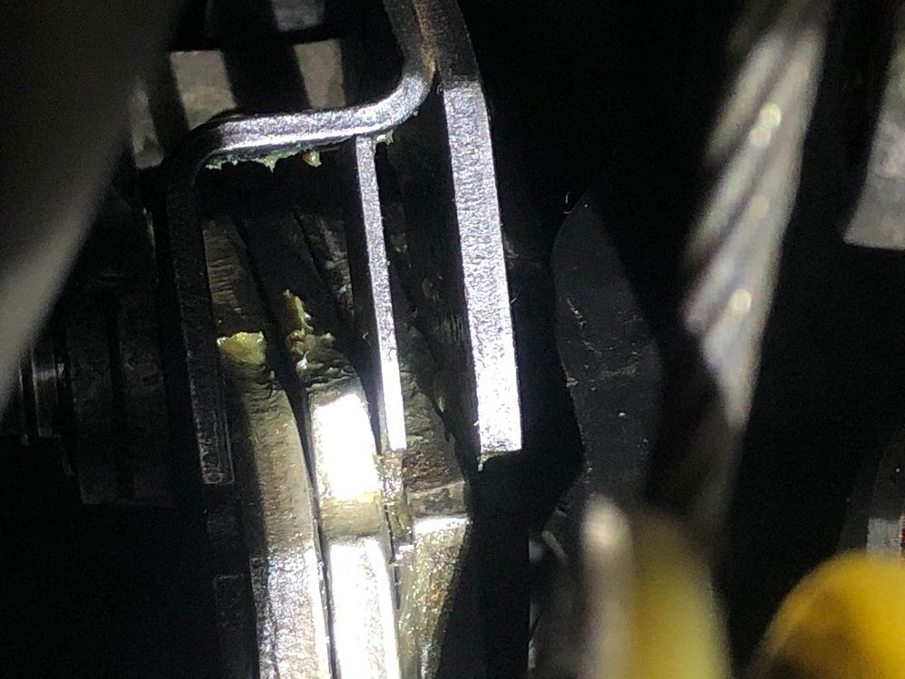

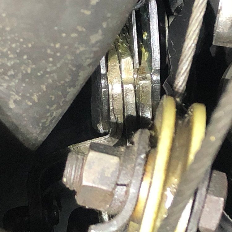

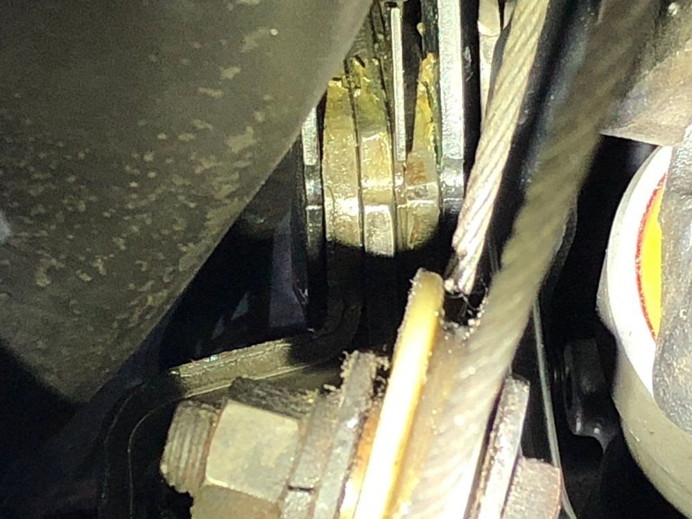

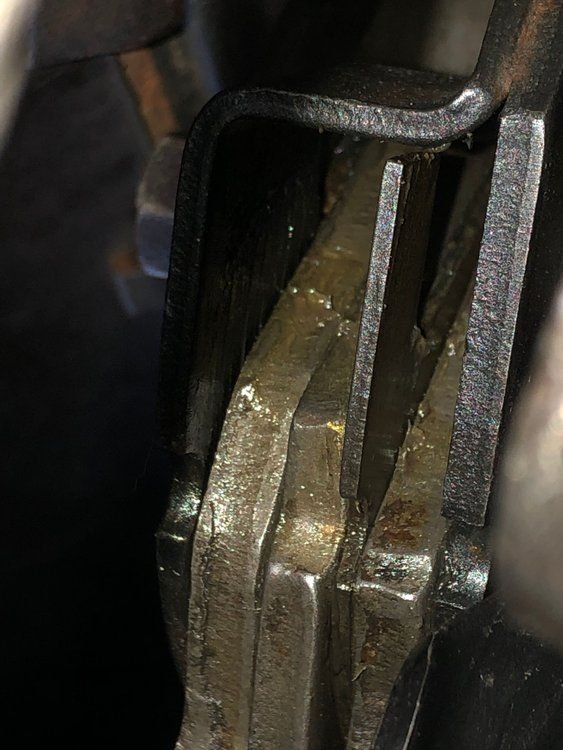

Check for loose bolts on shifter base and or linkage rods ..
take a look under shifter in neutral .
are half moons aligned?
post 69
https://www.corvetteforum.com/forums...etc-diy-3.html
