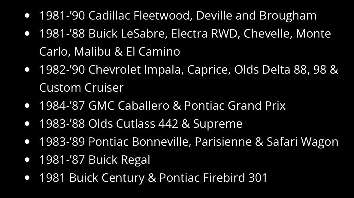

Look for an 80s Monti Carlo ss an 80s olds 442 of a Buick regal. They used the 2004r theres also a Caddy that used them in the 80s but I cant remember which model.

From: Minnesota

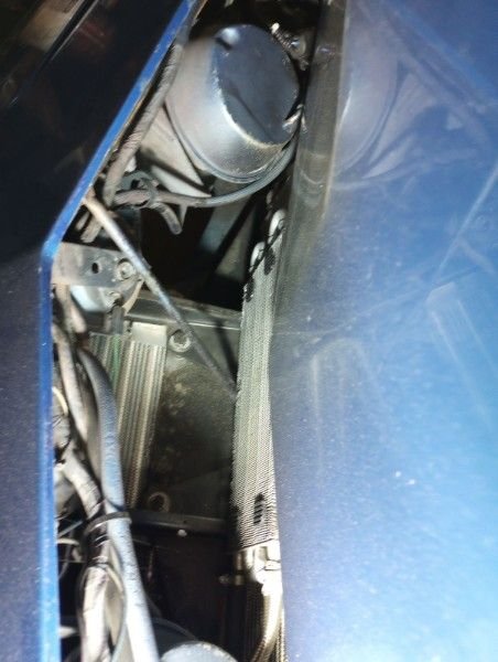

The cooler is no big deal. I used 2 coolers. 1 down behind the license plate and the other, short & wide, in front of the a/c condenser (so the hood can open without touching it). I'll see if I can find some pictures. I used braided SS hose and easily routed it.
I found 1 picture. The larger cooler down low came with my tranny but if I placed it against the a/c condenser then the hood would hit it when opened, so I bought a short wide cooler and plumbed them in series. The one against the a/c condenser gets air drawn by the rad fan. I had a temp gauge on the tranny pan for at least 6 months and it always stayed cool.
