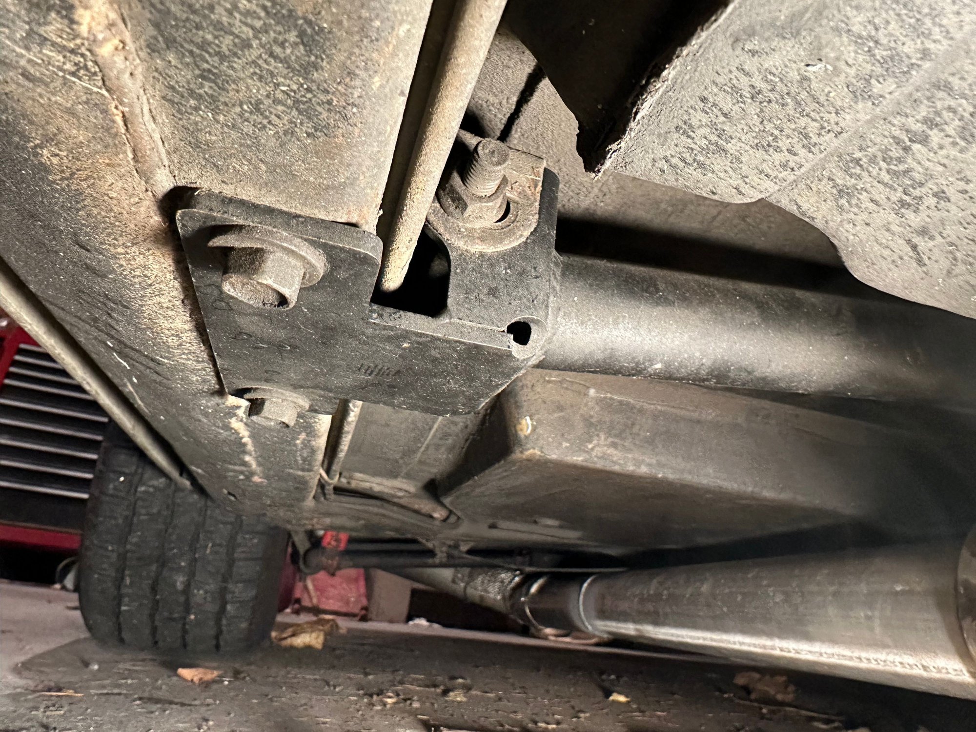

I got the BTO crossmember for my TH400 so i could run 3" exhaust easier. the BTO crossmember does have the pulley for the parking brake. look just above the vband clamp and you can see it.

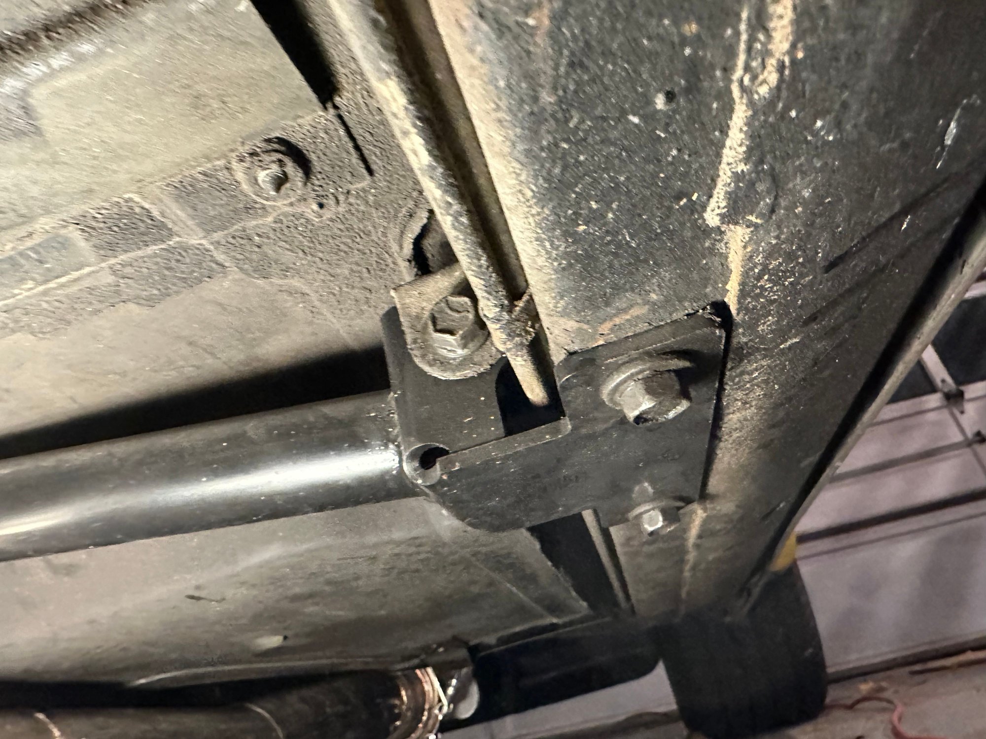

Could you get some pics of the attachments to the outboard frame? If my crossmember fabrication goes south I'd like to see how difficult it would be to modify this BTO crossmember to attach the manual crossmember stubs on my manual frame.

this is all I got for pictures - these are with my original 3" exhaust and previous TH400. the picture in the other post was with stainless spliced in with vband clamps. I had someone straighten out the bends comming off the collector. If you want I can take a couple close pictures when I get home tonight. car won't be on a lift but I can jack it up a little if necessary.

When you get a chance and are up to it a couple of close up pics of the outboard attachment for that tranny crossmember would be appreciated. Many thanks,

Here's a picture of the passenger side mount looking from the from and back.

Many, many, many thanks! Great view and I'd been looking for close-ups of that for years.
Seems to me that if my home-made crossmember ends up FUBAR than I can buy one of these and modify it to make it fit the manual "stubs" on my manual frame.
