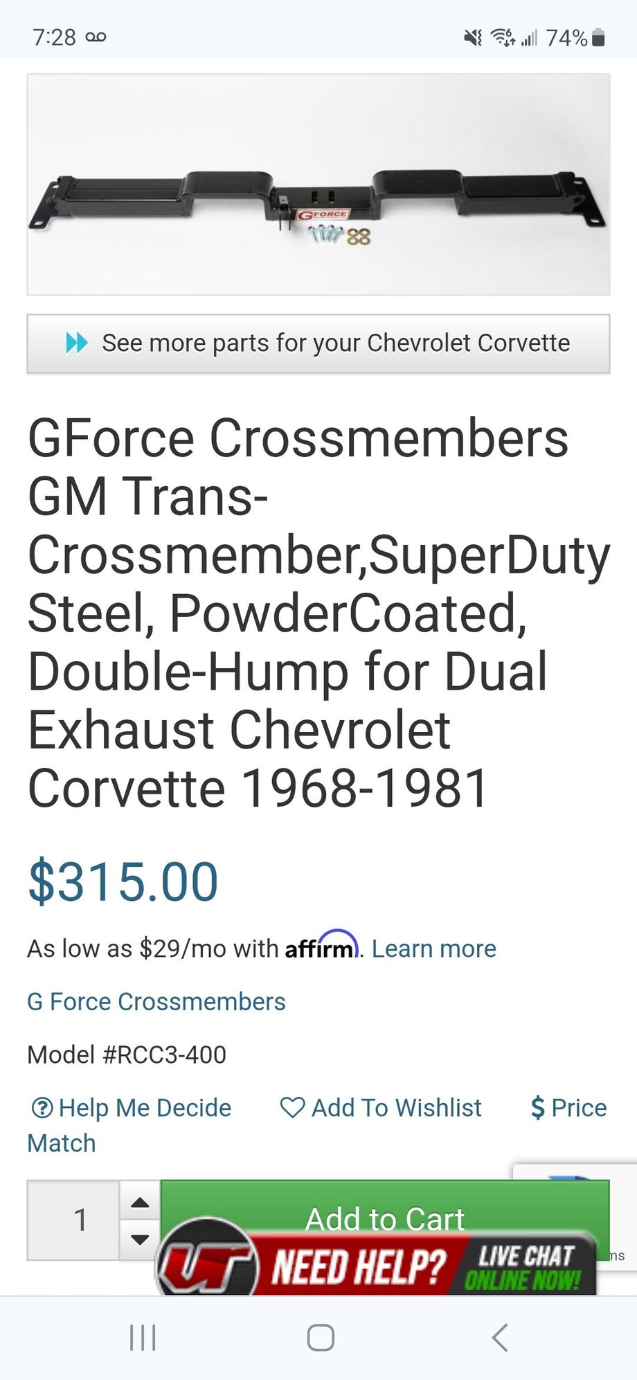

Thanks guys... just got the email that crossmember is no longer available

Check out www.bowtieoverdrives.com. Its where I got mine,also has e brake

Thank you, they do have one but it doesn't have the attachment for the parking brake, might have to buy one and fabricate the bracket, doesnt look very stout by the photo

yep, I was just replying thank you again, at closer look from your link I can see the bracket, will order one in the morning, thank you.

I did actually email them a few minutes ago but according to Vivid the manufacturer isnt producing it nor taking any future orders, i will see how they respond to my email and keep posted but looks like I can get one from Bowtie if not... I will fabricate if needed

Correct me if I am wrong but if memory serves me the 2004R using the same mounting location as the T350 right? If that is the case then try here. They show t have 2 in stock.

thank you... no the 2004r mounting is about 7" further back from the th350... its actually at the end of the transmission but on the 79 and earlier C3s you can remove the th350 mount bracket off the crossmember and the 2004r bolts to the bracket bolt holes on the crossmember
I knew the 700R4 and 4L60 was longer regarding the mounting location but thought the 2004R was the same as the T350. I looked on the G-Force website and they show the one for a T400 and 2004R are the same.

thank you... no this is the one I need for 2004r and th400 short tail, it appears everyone who sells Gforce is out of them, I have a backup with Bowtie overdrives
I corrected my above post and see what you are saying. Looks like they are showing backorder unless there is one floating around somewhere.

Monster transmission shows they have one but it is pricey....
https://www.monstertransmission.com/...0_p_12030.html
Top flight shows it is in stock but I have my doubts about that.
https://www.topflightautomotive.com/...=TH400%2F2004R

yep I reached out to them too but your right... they sure are proud of that one, i will know more tomorrow for sure, thanks again so much
