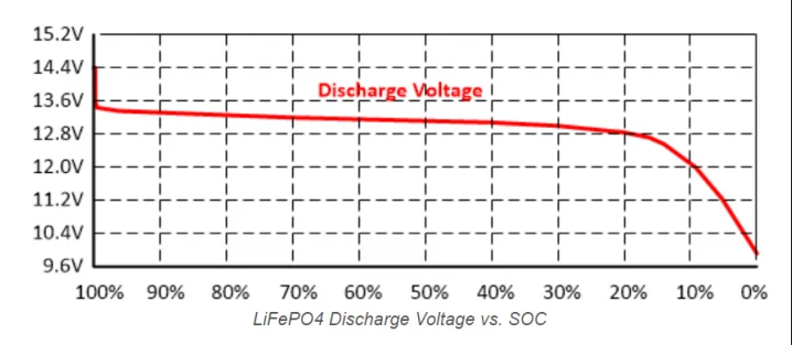

No one is talking about LiPo (lithium-ion polymer) batteries, or 18650s, except for you. That is not what the vehicle battery replacements are using.
Here's the curve for a LiFePO4 (LFP) battery. Cell voltage of 3.2 (20% SoC) to 3.32 (80% SoC). 4 cells puts it at 13.0V at 50% SoC. Couple that with a DR44G alternator (default 13.7 output voltage, tunable with a PWM signal), and you're all set.

Wrong battey tech... tesla uses the same 18650 lithium ion batteries as a laptop battery. (4.2v fully charged per cell and 3.7v nominal...)
Lifepo4 is completely different chemistry.. 3.65v fully charges and 3.2v nominal per cell.
Also no cobalt and nowhere near as volatile. You can stab them with a screwdriver and they typically still wont catch fire and they wont explode when over charged either like lithium ion.
I do agree the voltage regulator in the car is likely not setup for the lifepo4 battery though. probably ok if the battery never really gets discharged much but when discharged they pull a LOT of amps from the alternator and may over heat it. (again unlikely in this type use use scenario though)

Well Augie, I certainly can not post up entire classes from my employer. However, my take on it is this.
Yes, they love selling these overpriced lightweight batteries.
We make money selling them.
I personally have seen a VERY high rate of warranty.
Yes, a load like leaving your lights on they handle well.
starting events they DO NOT handle well.
These are 20amp hour batteries.
Not 8. We're not starting scooters here.
Old Aug 26, 2024 | 07:40 AM
augiedoggy's Avatar
augiedoggy
Joined: May 2007
Posts: 5,025
Likes: 1,120
From: North tonawanda NY
I cannot comment on any of that, I am only pointing out that lithium batteries do not typically give up the ghost and crank slower on each sequential starting attempt becoming useless in starting like lead acids can The discharge curve is pretty flat and a lot more consistent right up until the bms senses they are depleted and cuts off the voltage to prevent damage to the cells.
Since you brought up scooters yes those are a good example of a High amp load scenerio where they far out perform any lead acid battery in its size class by delivering more current, for longer periods. This is why more and more scooters, golf carts bikes and electric vehicles use them over lead acid tech.
The key is having the correctly sized lithium battery for the application.
BTW that said you and I are in agreement that a lithium battery is not ideal as far as being practical for this particular application in most cases. That is why despite building many lifepo and lipo batteries myself for multiple applications, both high and low load bearing I use a $45 Blem lead acid battery from my local interstate dealer in my corvette. More and more High end gasoline powered vehicles are using lithium starting batteries though because when sized and built correctly and paired with the proper charging system they can work very well. They just arent actually cost effective for this yet.
