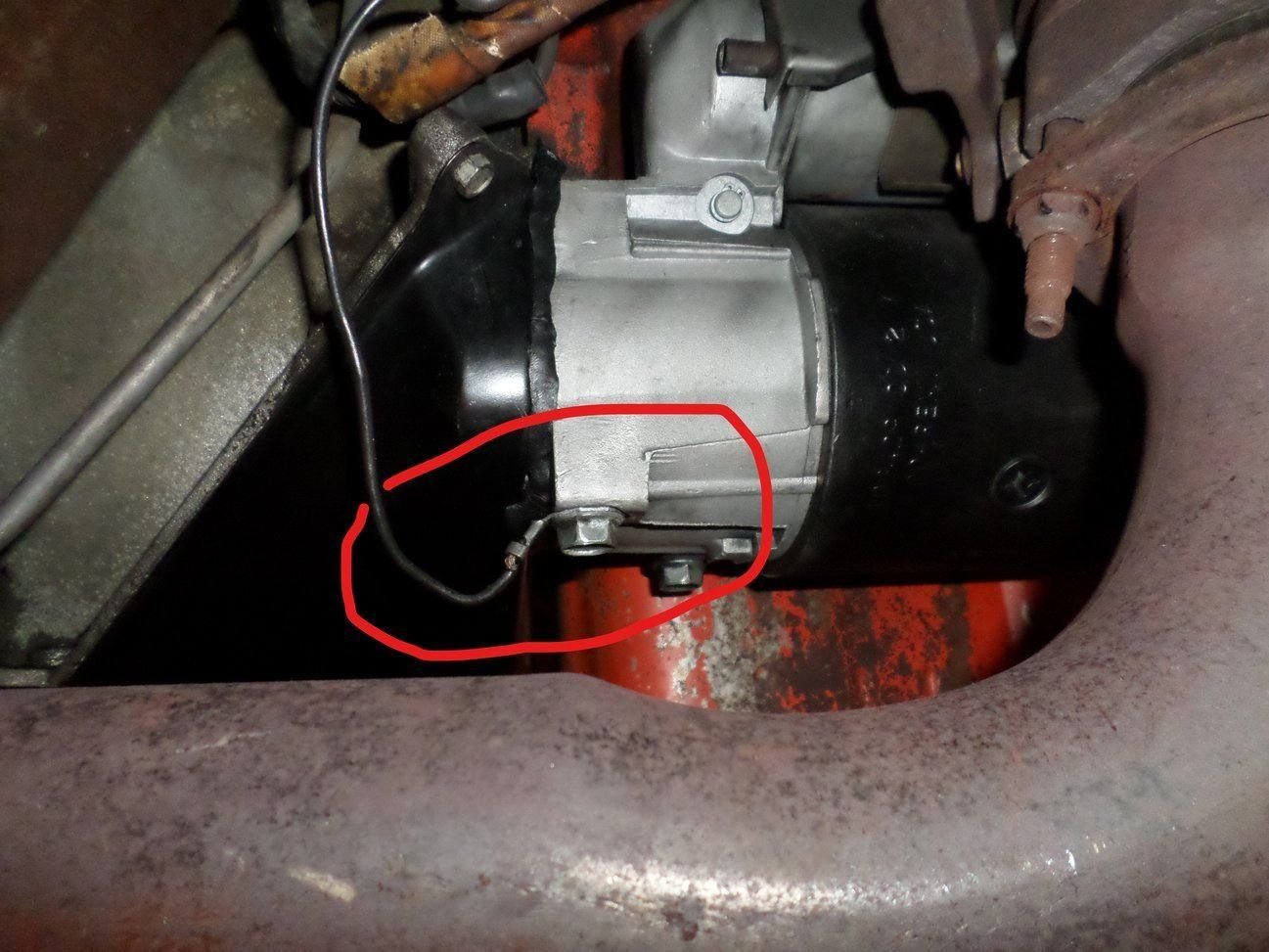

The original ground for the heater motor and the wiper motor is a BLACK wire connected to a starter bolt or bell housing bolt.

Peterbuilt
Am I to assume there are two grounds, 1 at the wiper switch and 2 at the starter? I'll check for the starter ground, does anyone know where the other end of the starter ground gets secured to "ground".

Yes, the switch is grounded and the motor itself also has a ground. The motor ground should be on one of the 3 or 4 cover small bolts and is an L-shaped spade connector. The switch provides a ground path for the different wiper motor operations through the 3-prong harness connector.

I don't see a ground on the starter or bellhousing, and the ground that is shown in the previous photo goes in through the firewall, into the dash. I'll assume that it goes to the gauges?
At this point, I know the wiper motor works, as I grounded the motor to the engine block and it works on low speed.
