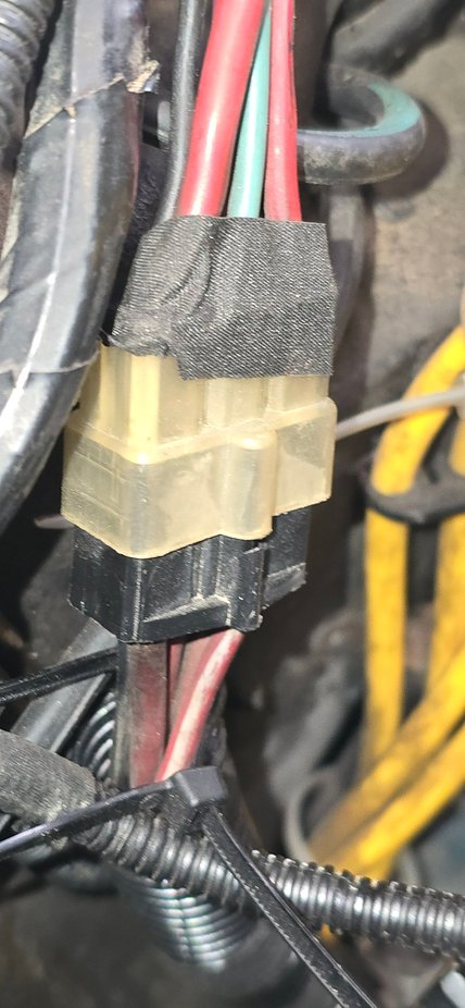

Anybody know where I can get the plug(white connector) that feeds into the starter on the bottom. I know Eckler's sells the bottom wire portion that feeds into starter. But where can I find the one that connects to it?
Top part of connection that feed to the starter in the bottom.

Please include your model year...
Different years different Packard/Delphi part numbers
Looks like a 6 cell to me...

1980 corvette with a manual tranny. L48, yes I believe there are 6 wires.

The F/M housing is #2977044
The Male housing is #2977042
https://www.ebay.com/sch/i.html?_fro...7044&_osacat=0

Do you know if I need a special crimping device?

If the terminals and crimps are in good shape, no need for new terminals.
If you find you need to replace one or more then a crimping tool would be necessary.
