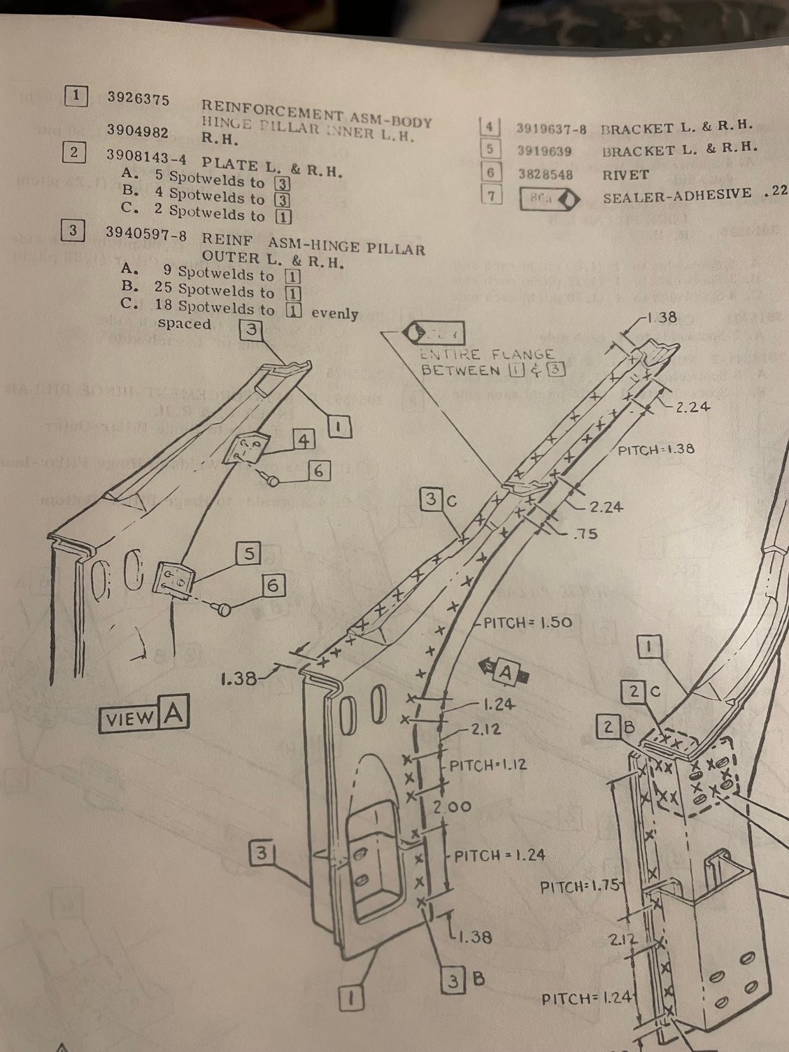

Hi,
One of the side brackets that attaches the the lower dash to the a-pillar has fallen off due to corrosion in the aluminum rivets. I thought I'd replace both of these brackets but for the life of me, I cannot find where to buy them and which rivets sizes are needed. Anyone knows how the part is called and what rivets are needed?
Thank you,
-Yuval

Assume you are referring to items 4 and 5?
I’d clean up and reuse the brackets and either use blind rivets or screws/nylon locknuts.
that’s what I’ve done thank you
