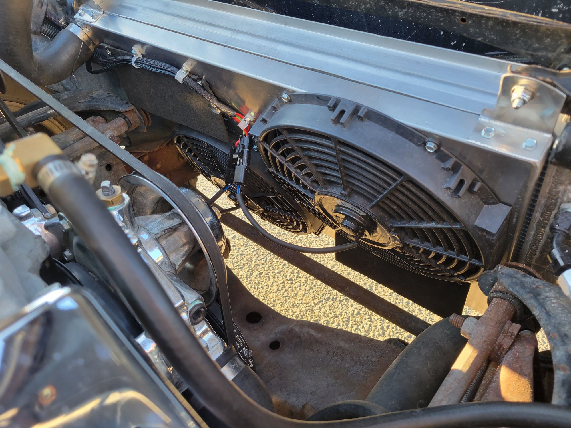

Id venture to guess its overheating at both speed and idle since I can see a huge gap and the top almost like the rad doesnt even fully fit the mount and theres no seal. I dont think the shroud is the issue here I think sealing up the rad and better flowing fans would do the trick as long as the rad can support enough cooling.

I'm late for the party here, but the first thing I see is that the flaps on his shroud are hanging in the open position while the car is obviously not moving. The fans are not pulling air through the radiator but through the flap openings. This would lead me to believe his problem is at idle or low speeds, not at highway speed.

For reference the flaps on my spal clone setup also hang open like that while sitting until the fans kick on and suck them in closed. This is due to the angle of the rad in our cars. I did wonder if that rubber was thin and pliable enough for that though. It does appear the engie and fans are off in the photos so..
It may not be easy to see but there really is an unusually large open gap between the top of the rad support and the top of the rad.(I see like 4-5 inch tall opening as the shroud bracket appears to be filling some of the space) like some sort of smaller universal radiator was installed here that gap allow much of the air to just bypass the rad.

Originally Posted by 79C3Vette
Since I went to electric fans I can not keep this thing cool. Any suggestions would be much appreciated.
It appears that the fans are positioned in the wrong locations. Let me try to explain, the inlet to the radiator( top hose) is the hottest part of the radiator with the most coolant flow, yet there is no fan there. I think the cooling will be increased with a fan placed in that section. Also the fan on the passenger side should be placed near the outlet of the radiator. And then there is the problem with the shroud not covering the entire finned area of the radiator. There is probably something to be gained there. And finally, like others have posted; radiator seals to direct the air stream thru the radiator. The air will take the least path of resistance, meaning it will find gaps in the frontal area of the car as opposed to being directed thru the radiator. The radiator has a higher resistance to air flow than a gap in the frontal area so the air will seek out the gaps because they have less resistance than the radiator. These gaps need to be sealed so all the air is directed thru the radiator. The flaps on the shroud need to be addressed also. With the fans running, they should seal the shroud. When the airflow thru the radiator exceeds the fans' air-flow, they should open. If all that doesn't work, you may have to increase airflow with stronger fans or put the factory setup (clutch fan) back on.

As long as theres a fan over both the upper and lower core tubes to cool the fluid as it passes across it shouldnt matter from how I understand it but I could be wrong especially since theres a shroud to pull from the whole surface area and not just where the fan is located..... Also this is setup the same way the dewitts shroud works and I think other use it without this issue.
Either way we need more info. that pic shows a short unknown rad and we dont even know how well the shroud is aligned with the actual rad. wealso dont know if the lower hose has the spring in it to prevent collapse under vac pressure
The fan placement is the way it is because the left side A arm interferes with the fan housing. It just doesn't fit the other way.
