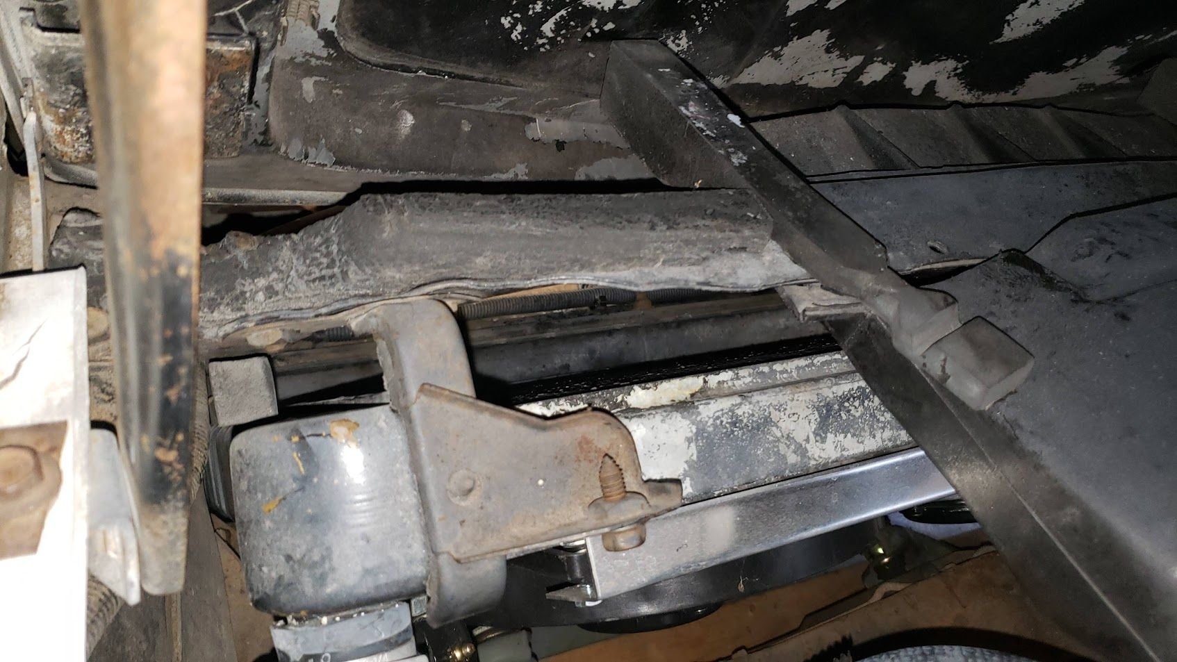

That flat shroud is going to create a little bit of restriction to airflow. And because of that, the air will flow over the top of the radiator instead of thru it. At speed.
You ABSOLUTELY need the large FOAM SEAL on TOP of the radiator that seals to the HOOD. So the air can not go over the rad.
4 vettes has one in his pic.
You almost have to stick your head in there where the headlights go and thin like air. Where could I go that is not thru the rad?
That should solve your at-speed issue.

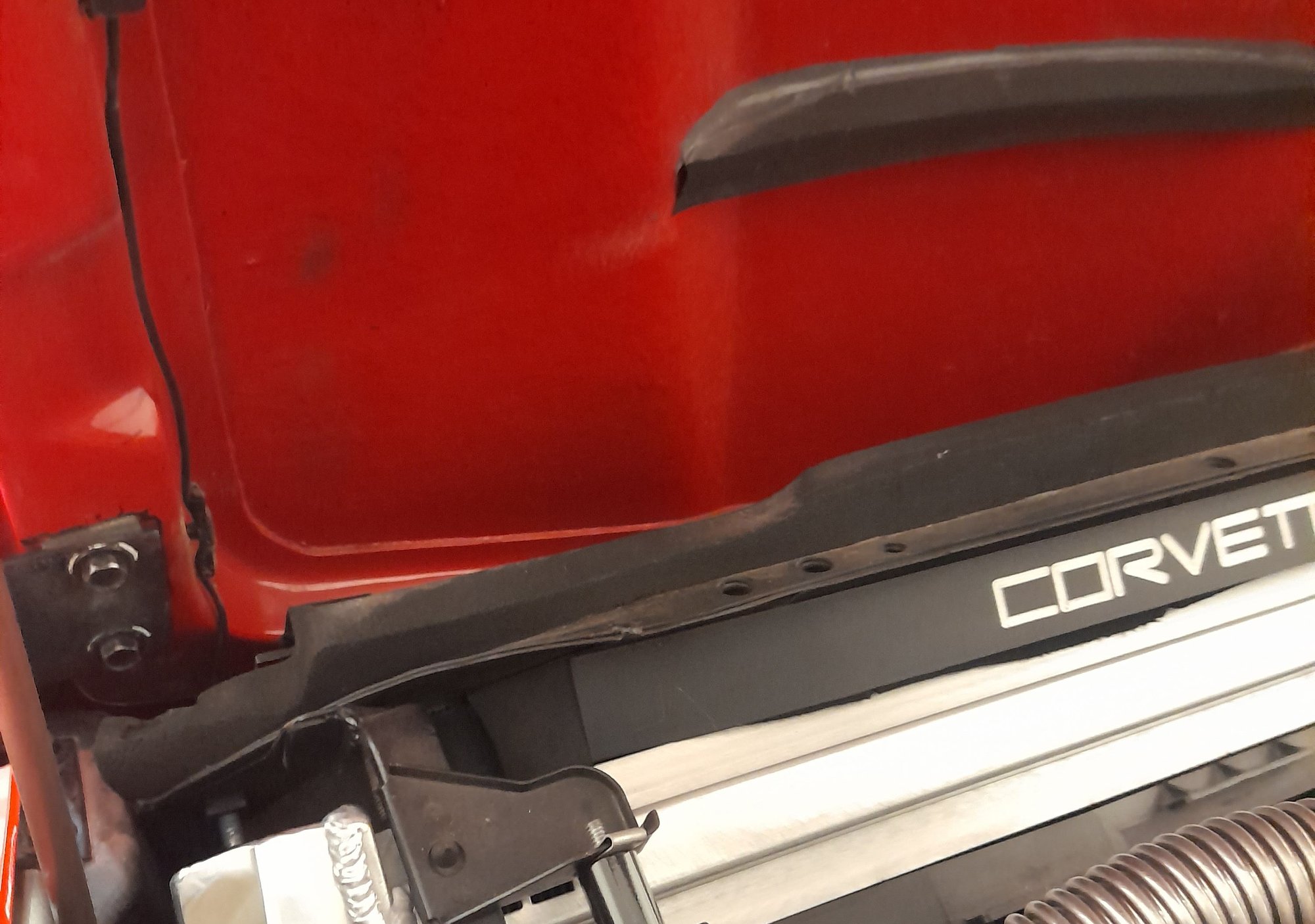

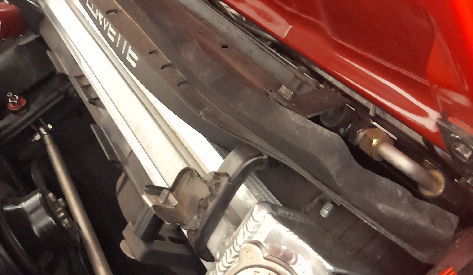

As I'm sitting at home healing as it were. I thought I'd walk out into the garage and try to take a better picture of that upper seal that seals to the hood.
Note the unusual shape to this foam seal so it matches up perfectly to the hood. Also note the section of foam seal glued to the underside of the hood. I actually purchased 2 of these seals, cut the center section out of one and glued it in to match up with the lower as I have a aftermarket high rise hood. And it works.
Right hand side of the seal
Another angle of the right hand side upper seal. Note how it's not just a consistent thickness it entire length.
And Yes, Leigh is correct, stick your head up in there just in front of your front spoiler. Look! See any gaps! Fill them!
I really did try a flat pan style shroud on my car. I really have had 3 different types of fans. I really have gone through ABSOLUTELY EVERYTHING when it comes to keeping my engine cool. I did finally win the war. My car keeps it's cool in tropical Queensland heat! But Boy oh Boy was it a learning experience!
So, I really am trying to point you in the right direction.

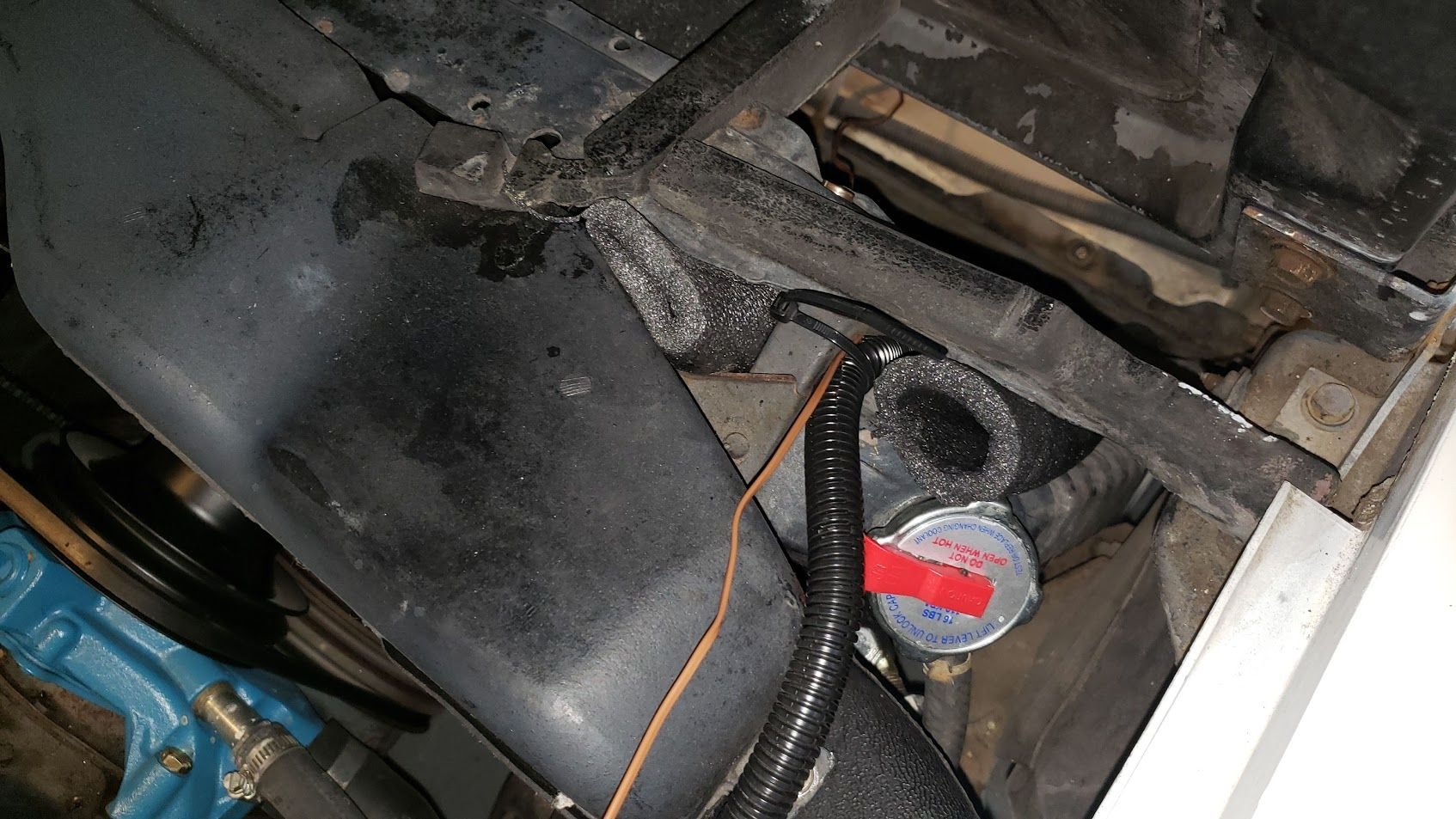

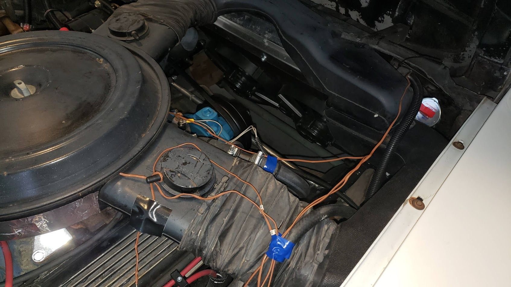

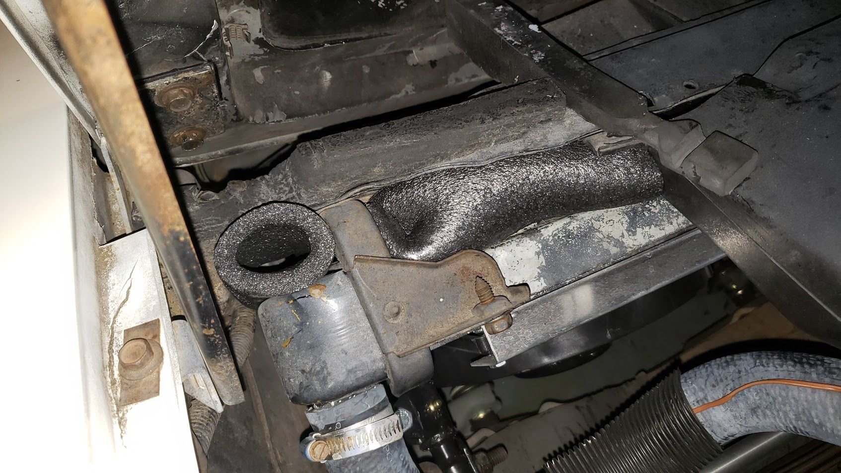

These photos are from some experiments I ran a few years ago. Turns out I used pipe insulation from Home Depot (which is like a Bunnings, but orange). You can see the dual-snorkel CAI inlet over the center of the radiator, and some of the car's original 40+ y.o. foam, original radiator, and dual-Spal fan.
https://www.corvetteforum.com/forums...d-control.html
Originally Posted by Bikespace
Here are the thermocouple wires, the condensor-free air gap, and the foam-filled radiator surround for the experiment in Post 2.

As for that gap or gaps between the hood and radiator, I will be addressing that for sure. I have added foam around all 4 edges sealing it to the radiator. And closed off the cutouts.
