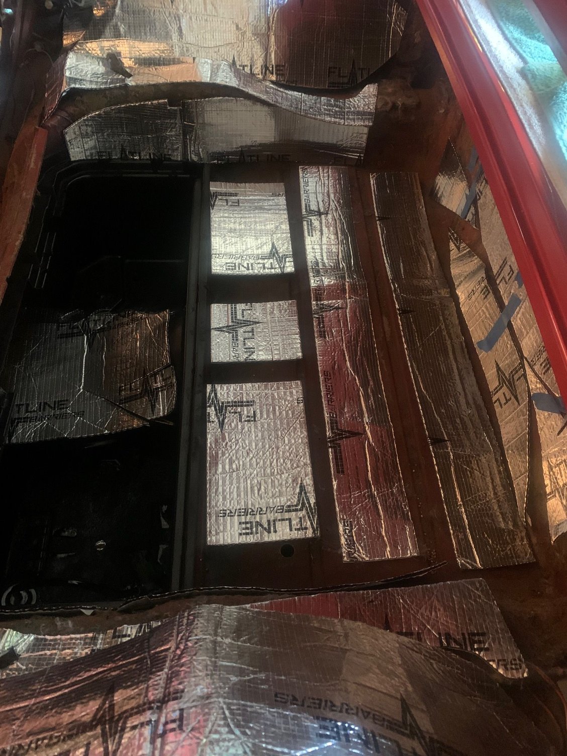

Hello all, I’m in the process of installing a custom kit form Flatline Barrier specific for my 1968 corvette. I started in the rear cargo area and laid out based on the installation diagram...when I lay out the pieces (dry fit) there is all sort of non-covered area (perhaps 8"~) all around the pieces. Not sure if this is the way it was designed to fit? Was hoping someone out there had some experience w/ this product.
Thank you

Yes I purchased a kit just like that one from Zip Corvette products when I was sound deadening my car about 2 years ago. Being overseas it cost me plenty. What with the exchange rate and cost of overseas shipping. And Zip didn't have it in stock when I ordered so I had to wait almost 2 months before they got it, and then finally shipped it to me.
I found this Flatline Barrier pre-cut kit to be a complete and total waste of money! Just awful! And absolutely no instructions whatsoever. I complained to Zip LOUDLY. They finally put me in touch with the Flatline barrier company. Who didn't return emails!
In the end, I purchased sound deadener locally. Was MUCH denser and higher quality and lower cost. But I had to cut it out myself. But having that many gaps under the carpet just simply can not work! Or look good under the carpet!

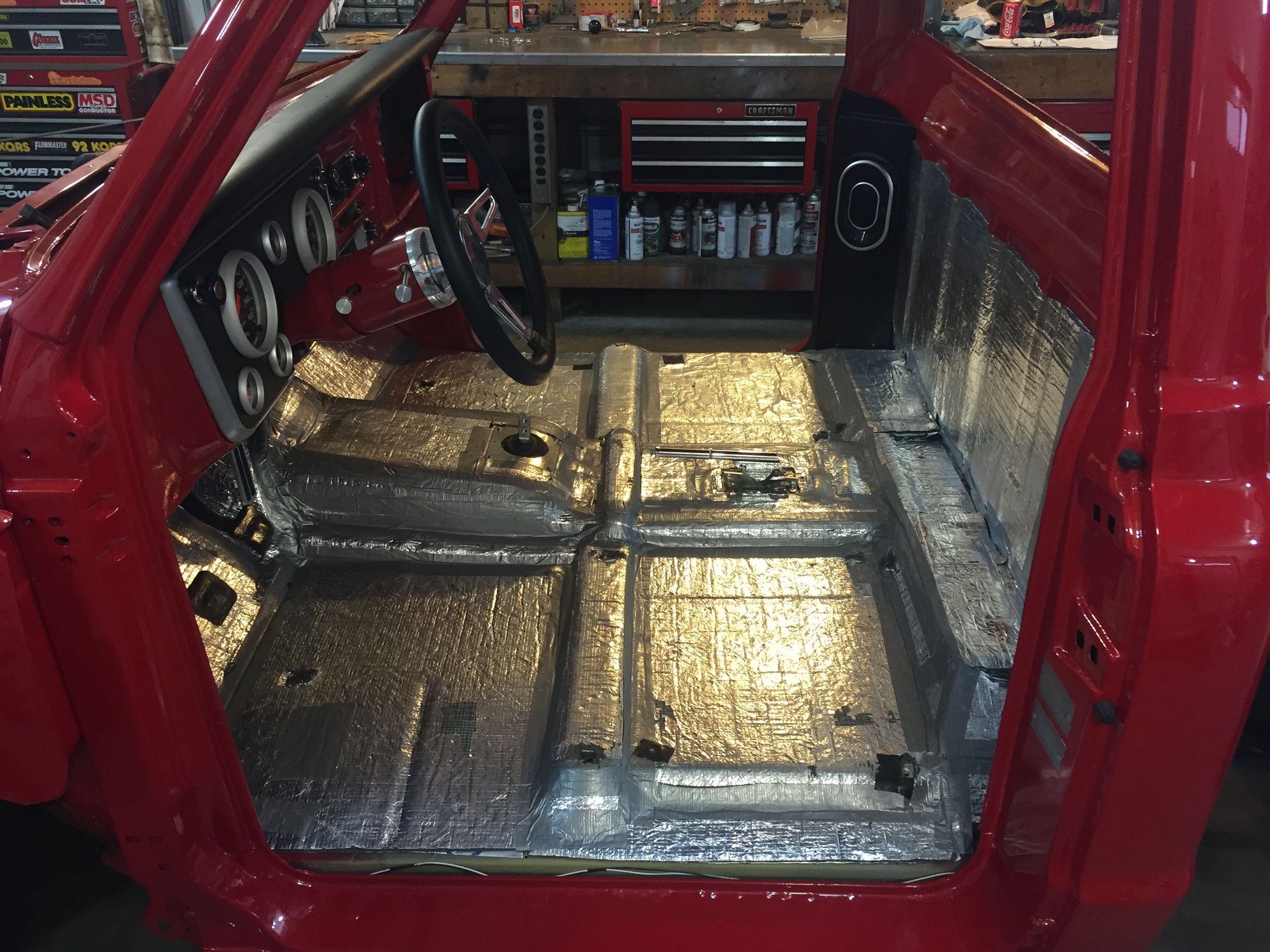

On my hot rod projects I used Dyna Mat "like" insulation from Summit. Cut and paste to cover every inch of the interior floor pan. Then the double sided foil insulation with about 3/8" fiber insulation. I use the universal kits because I'm cheap. LOL.
The Dyna Mat "like" is self sticking. The 3/8" insulation I use 3M spray glue to glue it the first insulation.
Don't have a pic of my C3 but a pic of my 68 C10 before installing the carpet.
On the under side of the floor pan I use a DEI product that has glue on one side, fiberglass insulation and then some kind of a waffle SS or alum material over the header area.

Thanks, guys, for the feedback... I had also called Flatline directly... Spoke top Dan (owners son).. His response was they have made the product for years like this? and that’s it! ... Ok i guess they been doing wrong for years
Seems they really are no interested in feedback from their potential customer base… Great business model
