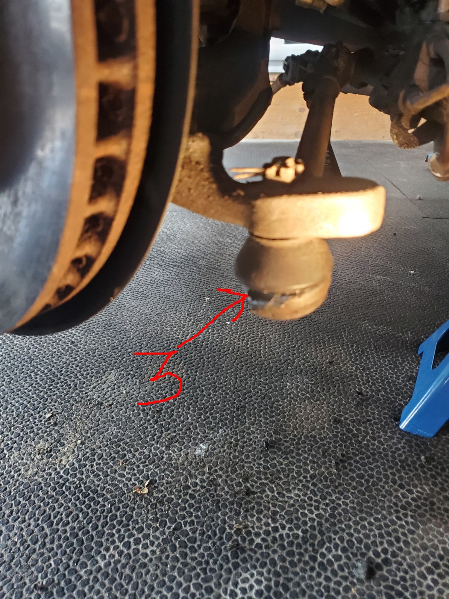

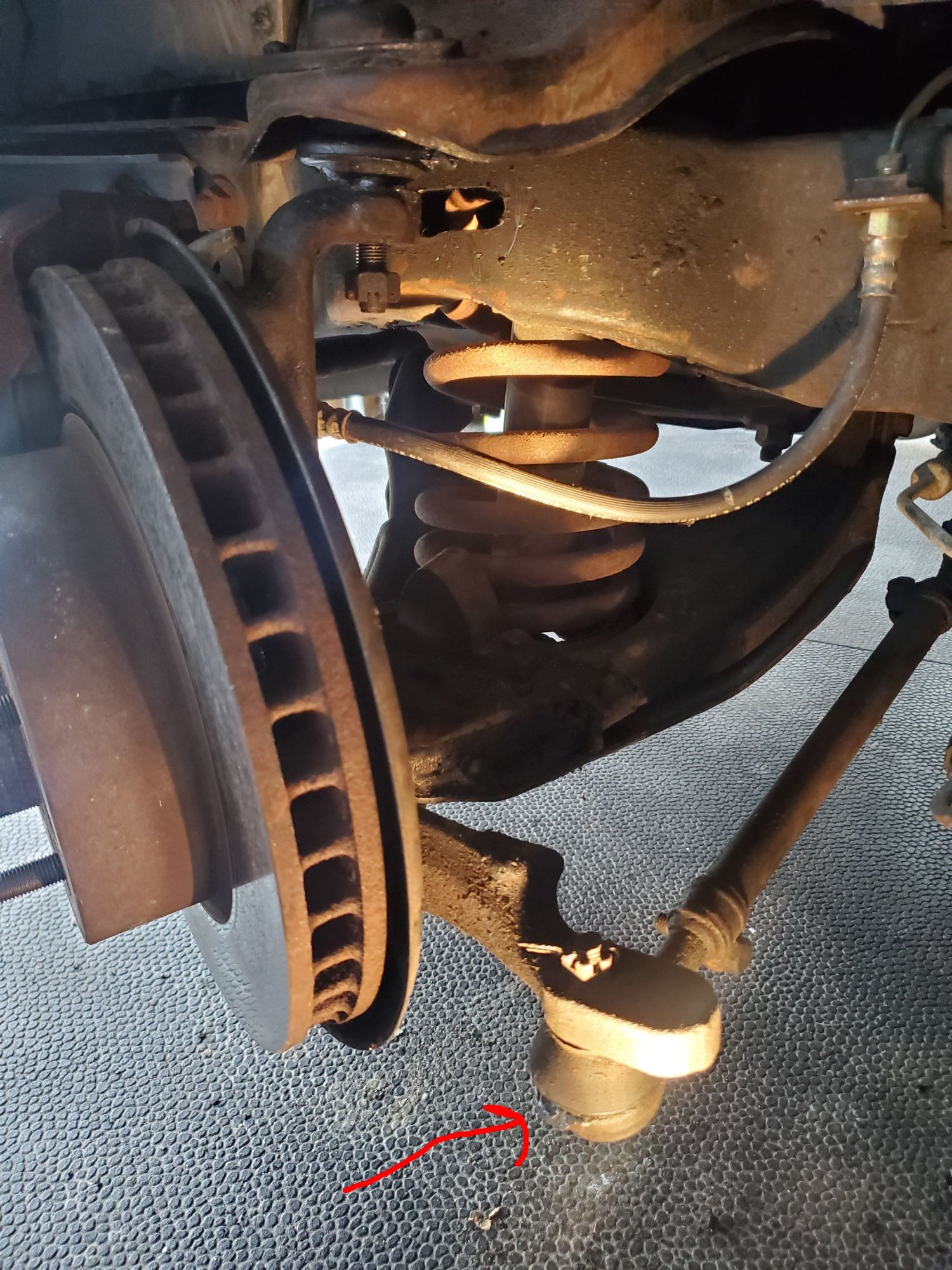

Hello C3 people, few questions for you experts:
  1. The boot on the upper ball joint is splitted in the center, so not retaining any grease. I have remove the castle nut but the thing is not moving. Do I need to remove something else (lower ball joint, steering joint, stability bar) to break it loose?
  2. The ball joint assembly is riveted to the upper arm. So I need to change the whole arm???
  3. The steering joint boot is leaking at the top, is it because there is too much grease or because it needs replacement??
Many thanks!
It's a all the same thing on both side of the car. It' a pretty stock 81 by the way. Only 14k miles!

1. Just wack the steering knuckle on the side with a BFH. PUT A JACK UNDER THE LOWER CONTROL ARM/BALLJOINT! The coil spring could kill you or at least ruin your day.
2. grind the heads off the rivets and drive them out with a punch.
3. The tie rod end boot looks to be over filled.

The joint is held to the spindle with a taper friction fitting -- i.e. both the joint stud and the spindle have matching taper angles. Tapers have fantastic holding power against separating. You need to either shock the side of the spindle with an impact gun or 1-2 pound hammer, or use a joint puller/separator. The boot can be damaged using the separator tool but that's not a concern in your case.
If you are changing out the ball joint, then yes, you need to drill out or grind off the rivet heads. The joint is only held by those 3 rivets. A replacement joint will have 3 small bolts to replace the rivets.
Excess grease coming out is fine and shows that it's full. Wipe off the excess to keep it from dripping or accumulating road grit.

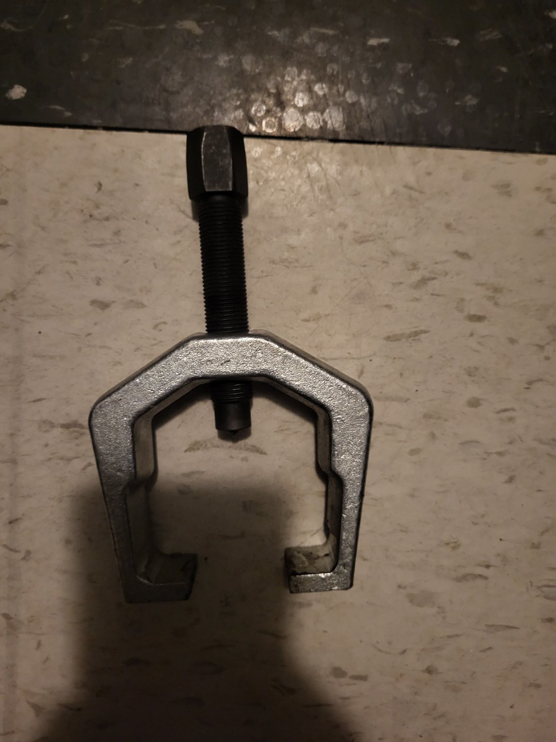

I use this pitman arm puller on the upper ball joints and it splits easy... as others said if removing the ball joint rivets need to be ground down flat, use a chisel between the A-arm and the ball joint base... hit it with a hammer and it will show the rivet location on top and punch it through

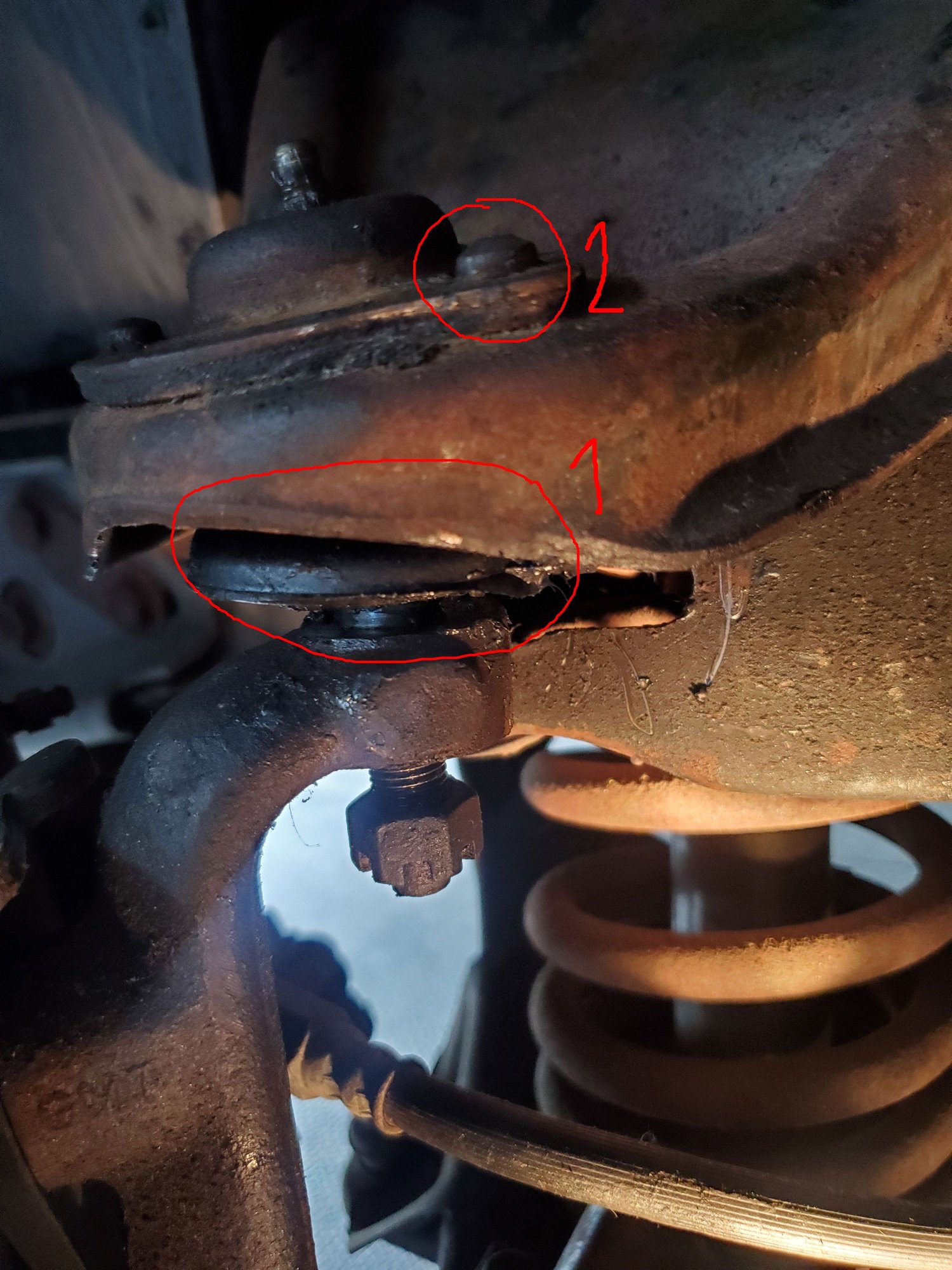

Do as the others have told you....put that jack under the lower ball joint, but keep a very slight gap....1/16". The gap will allow the spring pressure to assist in separating the joint. Keep the upper ball joint nut right where you have it in the pic, or maybe tighten it a few turns so there's only about 1/8" gap, then hit the spots circled in blue with a good sized hammer....the vibrations created will separate the joint.

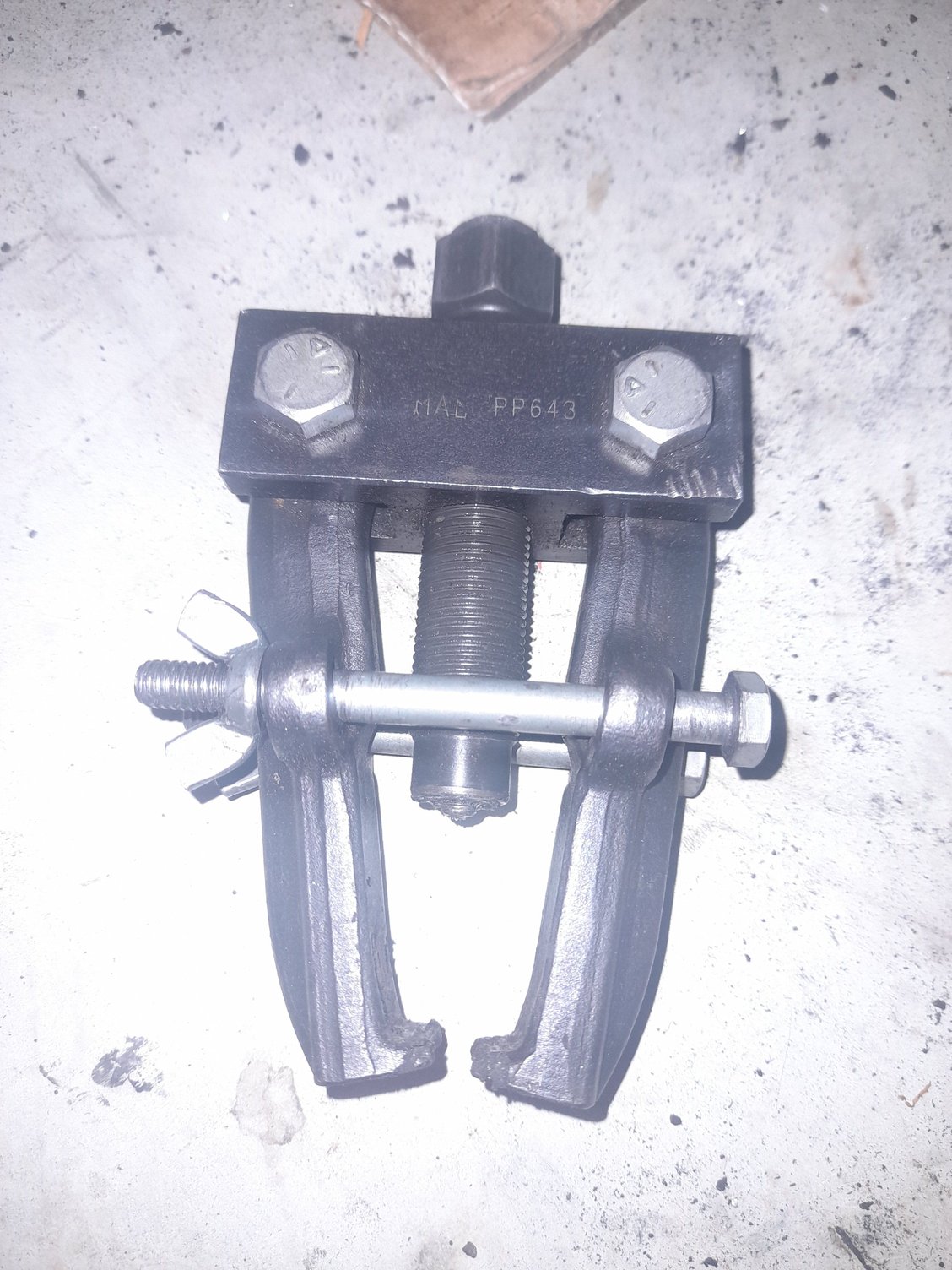

The ball joint tool you want looks like this. (I bought a kit that included it with some other stuff)

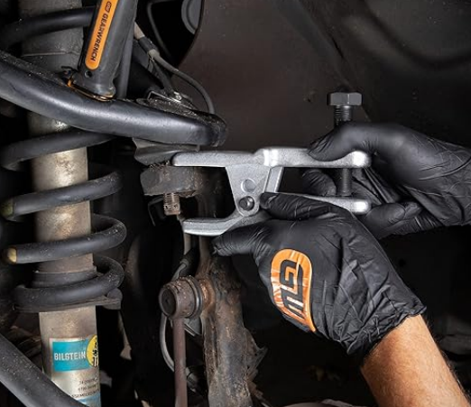

No, THIS is the tool you want to separate that taper!
