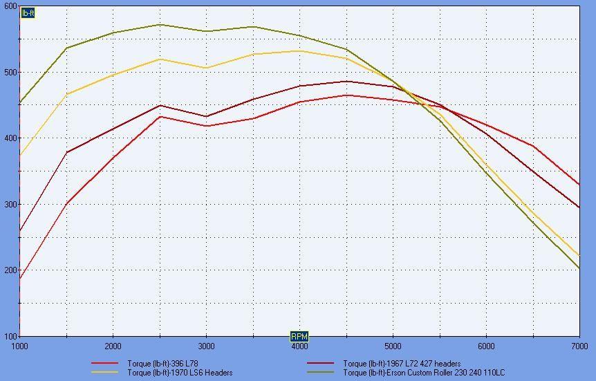

Here I backed my real dyno run of my custom cam into the simulation software. And compared it to the TQ curves of a normal LS6 cam, a 427 L72, and a L78 396. Factory but identical cams on those three. The numbers above will not be exact, but the trends are real.
Low end TQ comes from cubic inches!
Lorenzo has dyno'd many of these, and going from 396 to 427 to 454 adds 30-40# TQ for each size increase.
But only the simulation software can show what it looks like off idle to 3000. They don't like to start dyno runs below 3000.
But where are you actually going to drive it? 90% of the time? 1000-2500 right?

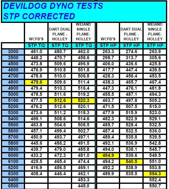

When talking big blocks....or even healthy small blocks.....lift should usually be in the mid 500's on small blocks and low .600's at least with any decent head.
I did a nice 388" with 525 HP for a buddy. Basic 11.0 compression, old unported Dart 215 cc as cast heads and a custom high 240'ish solid roller cam. It honestly drives incredible and has been running for over 10 years with regular flogging into the 7000+ RPM range.
I love 427's....ran mine in many combinations over the years and was never scared to jump on 454's.....but I shifted it at 6500 or so with oval ports and closer to 7500 with rectangular port. The ovals are a much better combo on the average street motor with a little work on them.
Doesn't sound like you need to go crazy with heads....but if for whatever reason you end up buying a crank...go straight to a 489-496 combo and have lot of easy HP and drivability.

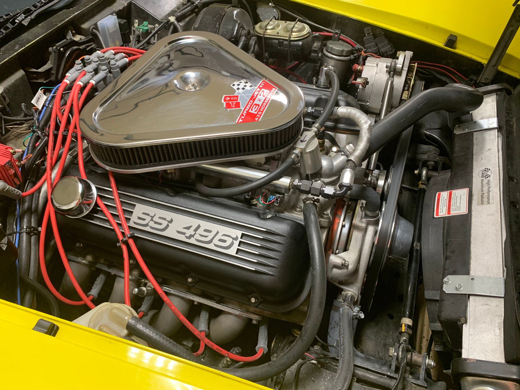

The cam in my 496 is 240/245@.050” hydraulic roller. 10:1 496 with Dr J’s heavily ported Edelbrock heads. The car will idle at 850 rpm in neutral no problem. I do have EFI but the Hooker sidepipes are probably costing me 50+ hp even with the STS baffles.
Here is my rear wheel dyno from 2014, running a T-56 Magnum and Toms 12 bolt diff. (3.73) so I am sure there was some drivetrain loss. (Ignore the 427 on the chart, it is a 496).
