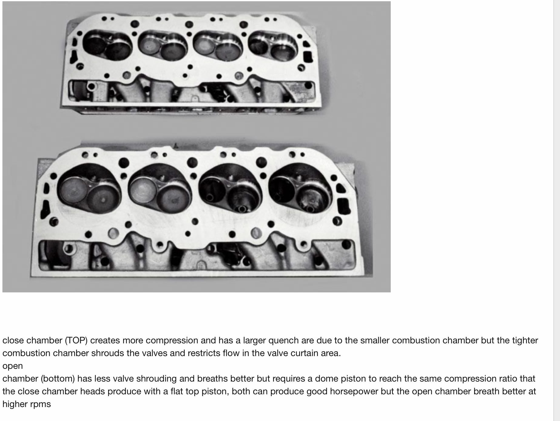

I am using a set of the BB heads made by GM and they have been great for making compression and power. The heads I am using are the large Oval Port closed chamber heads and they have a 100.9cc chamber cylinder head. They are listed as the GM part: #3931063 and both were cast in 8/67 and the heads were used on 396 and 427 engines back in the day. The closed chamber keeps it from pinging as badly as the early open chambers did. I have pushed the overall timing up to 38* and still no detonation or pinging with my engine. The pistons I am using are L88 pistons and the valve pockets in the pistons match the ones in the head.
I think you have that backwards. The closed chamber heads were the earlier design (my '67's are similar to yours: oval & closed) but my '72's are rectangular & open. The open chambers were, in part, a way to lower compression.
