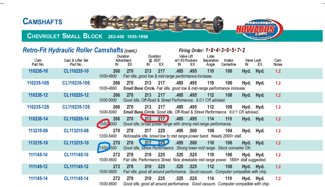

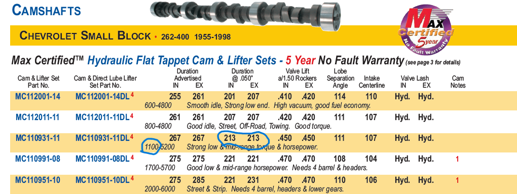

On the cam it has decent .050 specs 218/224*, but I do not like the 309* advertised. That is a very lazy ramp old school cam, with low TQ output.
You can do much better with this Howards: Same .050 but 50* wider on advertised. Fast enough to improve low speed TQ but still gentle on valvetrain.
Here is a Howards Hydraulic Roller which will make more TQ, and more power:
The red one will drive like a ***** cat, but be stronger than the flat t cam. The blue one will snort or lope a little at idle. And is about as big as you should go for a good driving street cam.
I like Howards cam specs and cam cores better than many of the other guys, for longevity (first) and power (second).
All of the cams mentioned should pull real hard between 1500 and 6000.
