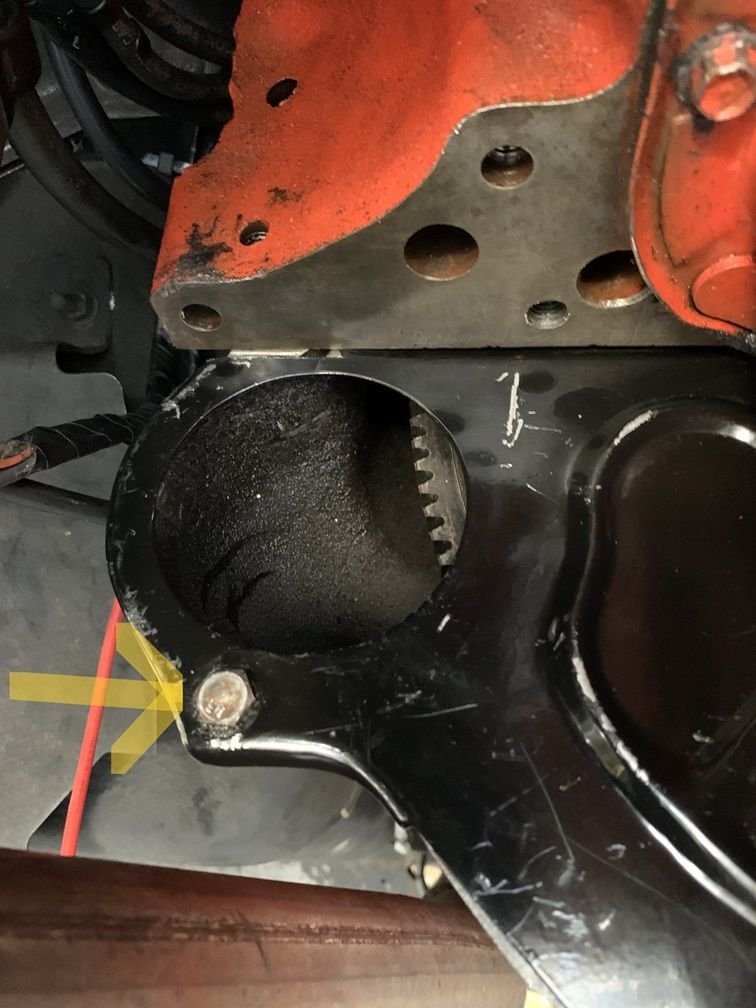

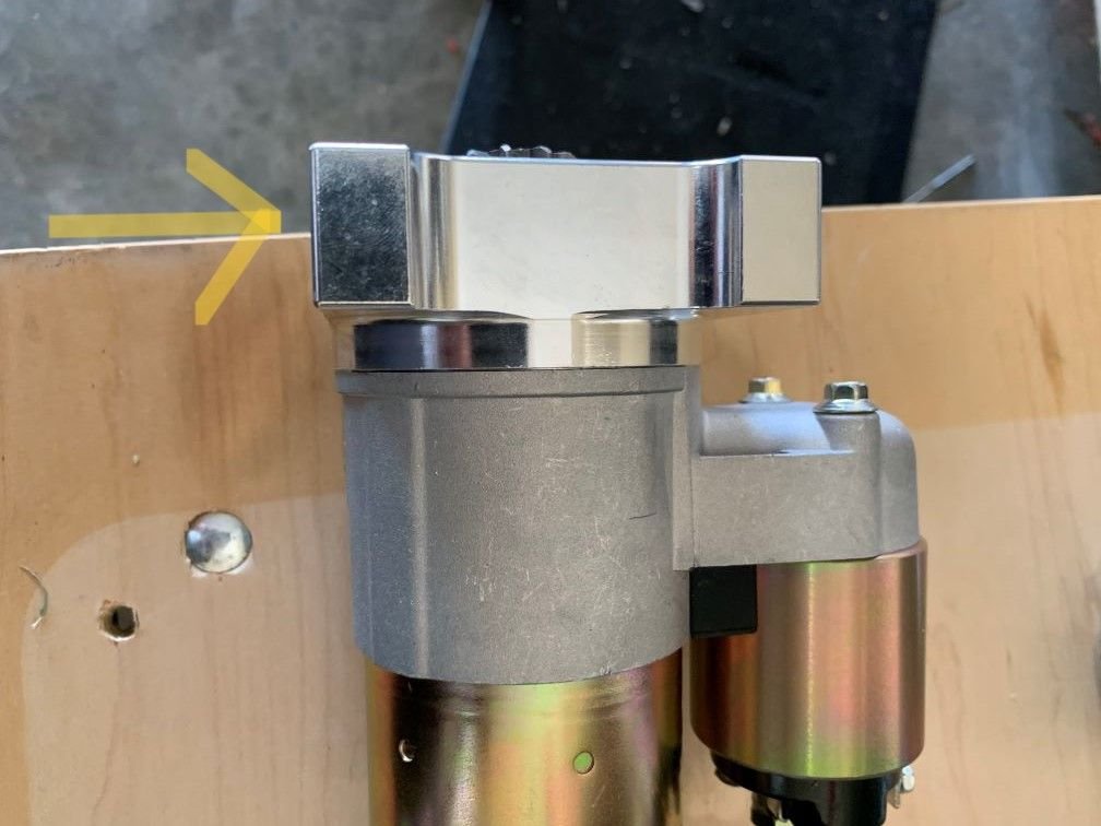

Good Morning,
I'm installing a new Power Master mini starter and the lower bolt on the bell house cover is obstructing the lower left part of the starter mounting plate by about 3/32". See pics. Any issues just eliminating that bolt and letting the face of the starter motor mounting plate hold that corner of the cover in place? I don't really want to grind the starter motor to fit around that bolt if I can help it.

I had the same issue with my Power Master mini starter on my big block.
I ended up purchasing a new Lakewood inspection cover from Summit Racing.that is totally flat around the starter area and there is no mounting bolt hole.
It was a perfect fit to the bell housing and gave me plenty of clearance for the starter.
I’m sure you could just remove the bolt and you’d be fine.

Looking at it with "What I would do".
I think I'd take that bolt out and then use my counter sunk drill bits and make that a countersunk screw. I have the countersunk screw big enough in my "big box of hardware".
That cover is thick enough and rigid enough that I think it would be fine if you just left that bolt out.

Hey, its a decent idea! That inspection plate is pretty thin (about 3/32") so I think you'd have to countersink into the block and flare the inspection cover into block in order for the countersunk screw to be flush. Other potential problem is that you'd have to remove the starter in order to remove the inspection cover moving forward. For me a new $35 inspection cover is an easier "lazy mans" approach
