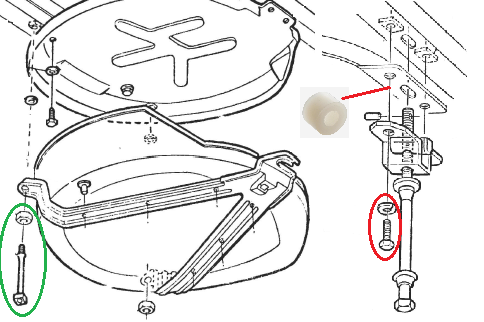

I have a 69 and the original tires were on the narrow side compared to today. When I put a wider tire in I loosened the nuts on the front bolts of the carrier and backed the bolts out a bit. Not too far or there won't be enough to hold the carrier, but the threaded part is fairly long.
Tightened up the lock nut and then bought two spacers at Ace Hardware and a couple of longer bolts and lowered the Tray Bolt assembly. I think I used a 1" spacer, but Ace has different sizes that you can try. I don't think anyone will ever know that it sits a little lower than original.
Plus the later cars used much wider tires, so I will guess that they also sit a little lower.

That is encouraging that you got a 255/60-15 in the carrier. I may need to pull one of the tires off and test that theory to see if I need to get longer bolts for mine. the few years difference between the us may be the difference as to whether I can get that size or not without modifications. thanks for the information
I was thinking that someone in one of the old posts I went through had just extended the rear bolts. I see you put a spacer on the front also. That makes a lot of sense if the back of the tray needs to be lower, so does the front. An inch shouldn't make much difference in looks.
thanks for the illustration and the information. that helps a lot

I too am running a 255/60 R15 as a spare.
As shown in robertea post above; I lowered the two rear pivot bolts enough to accommodate the tire
but, instead of placing a spacer in the lock bolt assembly, I simply lowered the swing bolt until I was able to latch it into the carrier hook.

255s fit easily in the carrier. If yours did not come with 255s you will have to lengthen the rod or get longer rods. No biggie.... All here: https://www.corvetteforum.com/forums...post1607753624
