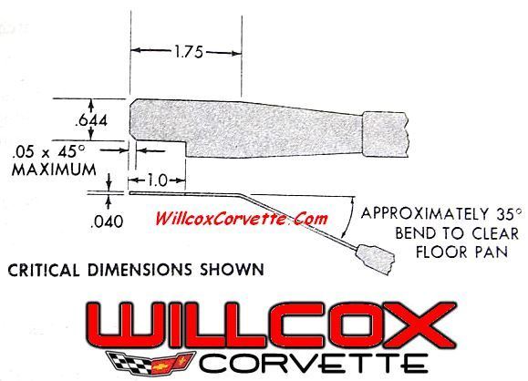

Here is the adjustment procedure:
You'll have to make an alignment tool that goes into the shifter while adjusting:
I suggest taking the shifter out and get a rebuild kit. Rebuild it and lube it up real good then install and adjust.
