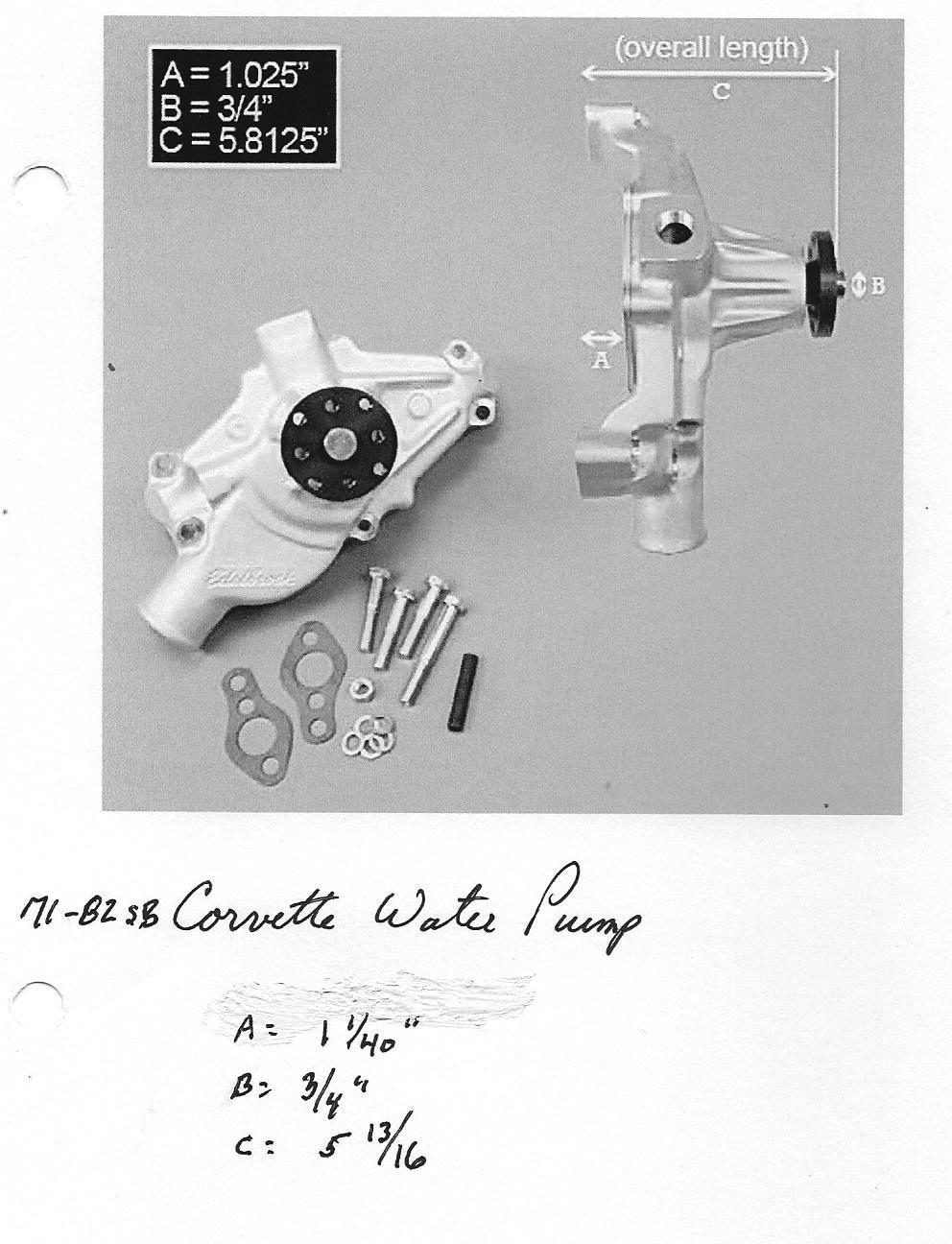

Originally Posted by Mikey1958
Thanks
I wish I still had my Chevy parts books..The parts stores are not showing a difference
You want a pump with a 3/4" shaft and a height of approximately 5.8".

Old Sep 29, 2024 | 11:55 AM
sunflower 1972's Avatar
sunflower 1972
Joined: Sep 2016
Posts: 2,232
Likes: 984
From: Wauconda IL
Credit to Peterbuilt for the illustration.
