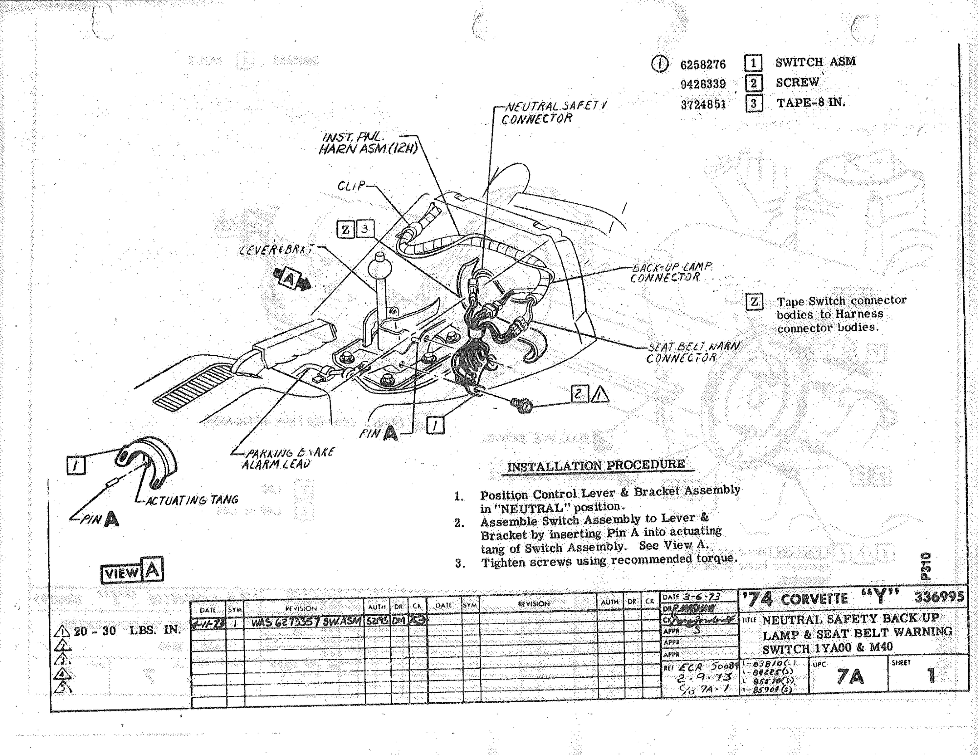

Default Do this help?
Confirm that the switch is GOOD and adjust as above.

Default 1973 Neutral Safety Switch (check & adjust)
thanks so much.... thinking we are just gonna get a new switch...... the installed switch seems corroded at the terminal hookups.....
