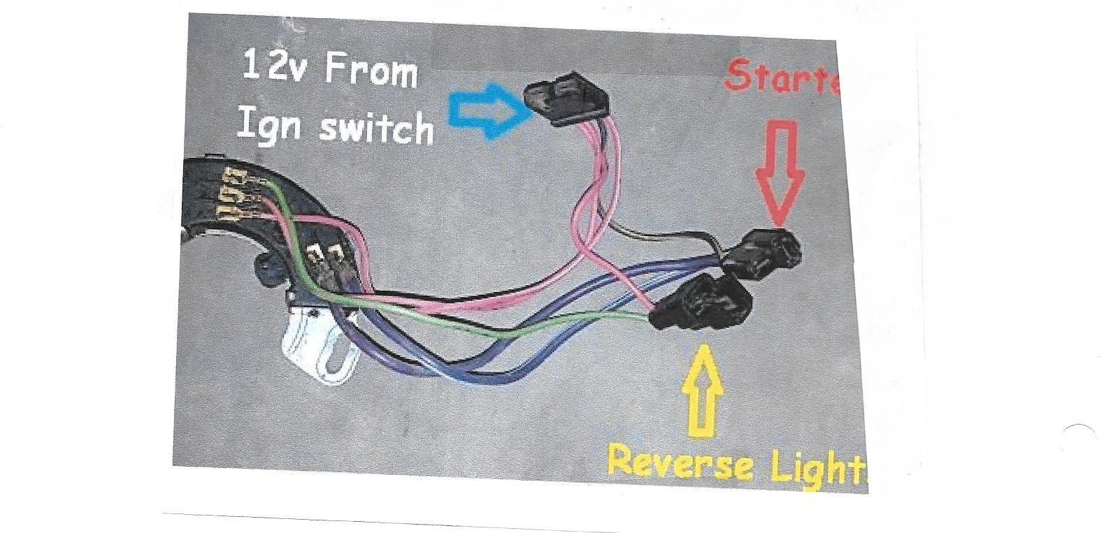

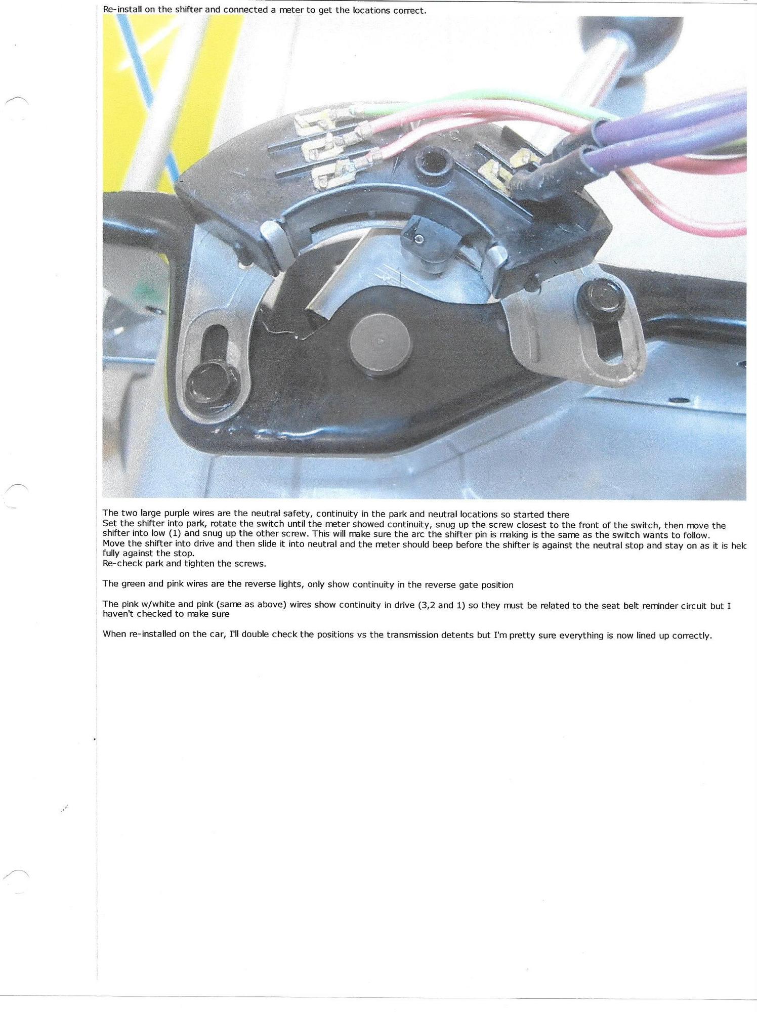

Default Does this help?

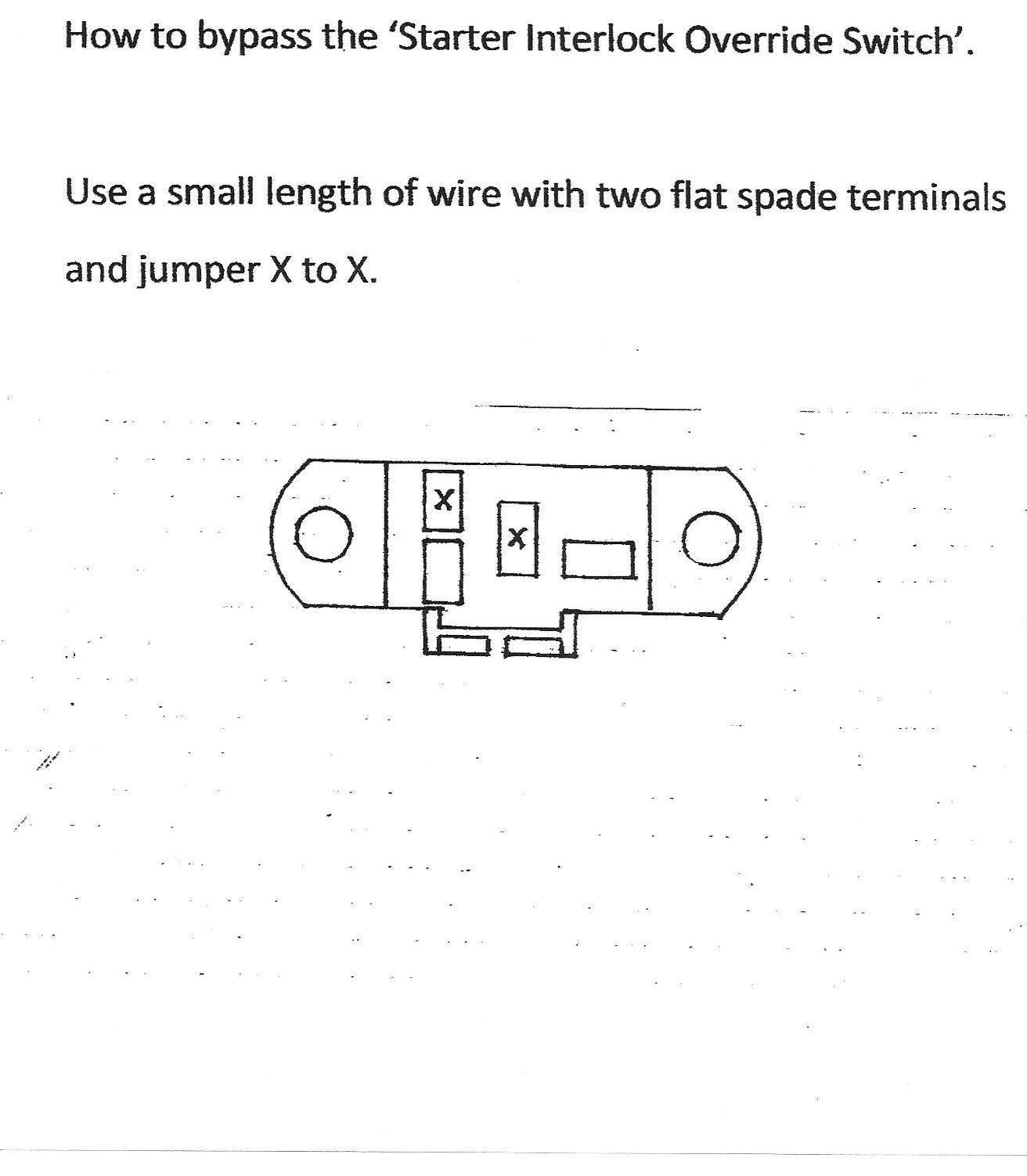

Do you have this on your firewall?
Remove the silver relay and by-pass like this:
This is the same as splicing the light green /black to the purple.

Bypassed the starter interlock relay per the diagram… still doesn’t start

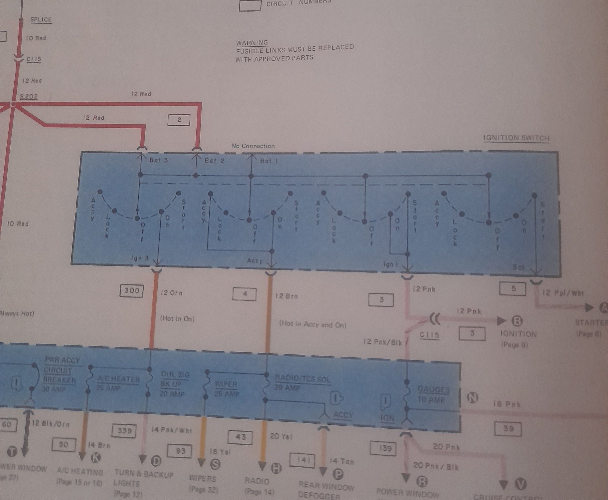

Red, from power distribution. Which I do not have a schematic for but I believe that is on the horn relay on a 74.
Old Dec 21, 2024 | 03:27 PM
4-vettes's Avatar
4-vettes
Posts: 13,227
Likes: 7,823
Cruise-In VIII Veteran

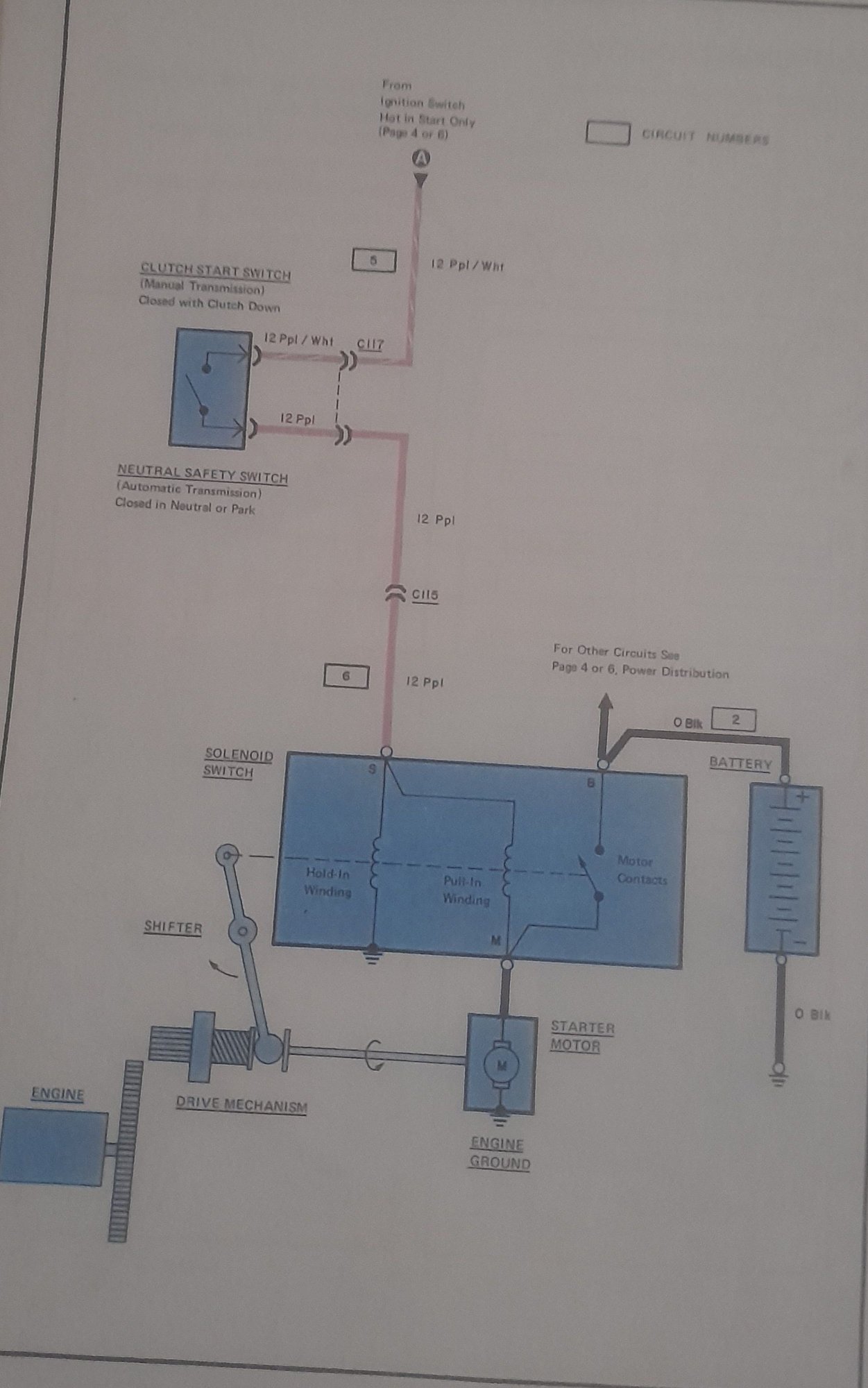

2 Red wires coming into the ignition switch. From power distribution. Do you have power on both of these? Then see purple/ white wire to clutch safely switch.
The rest of the start circuit.

Thanks 4-Vettes. Just saw your response
Old Dec 21, 2024 | 04:31 PM
pbennett's Avatar
pbennett
Joined: Apr 2006
Posts: 52
Thanks 4-vettes - that diagram was helpful. Turns out the purple wire out of the clutch safety switch is fried and doesn’t have continuity out to the starter interrupt relay in the engine compartment. I ran power to the purple wire and it also turns out the out from the relay - brown I think - doesn’t have continuity to the starter solenoid. So basically looks like both wires are fried.
