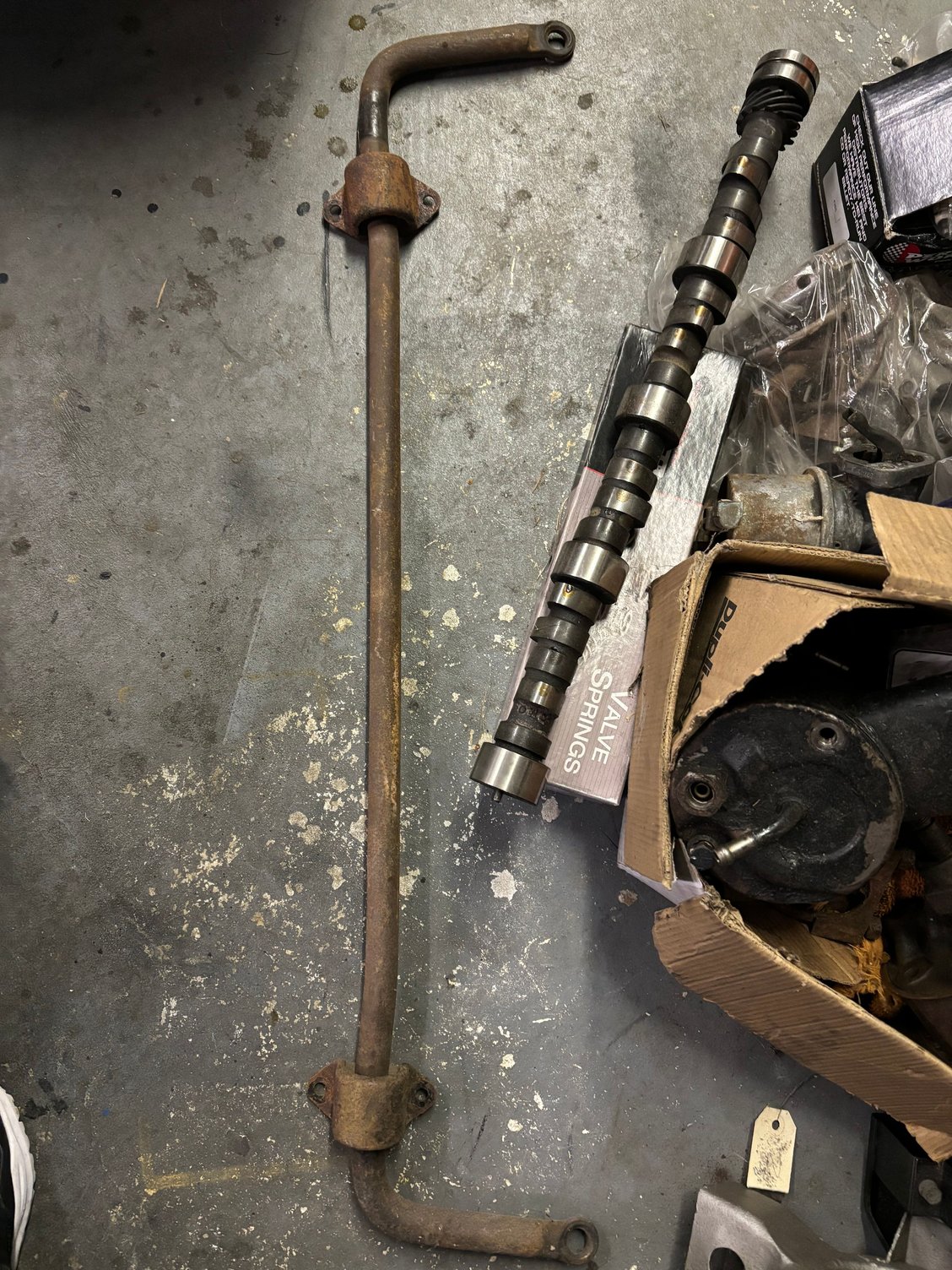

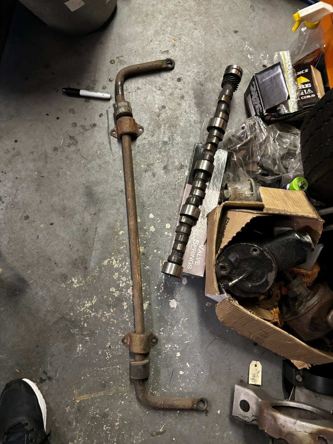

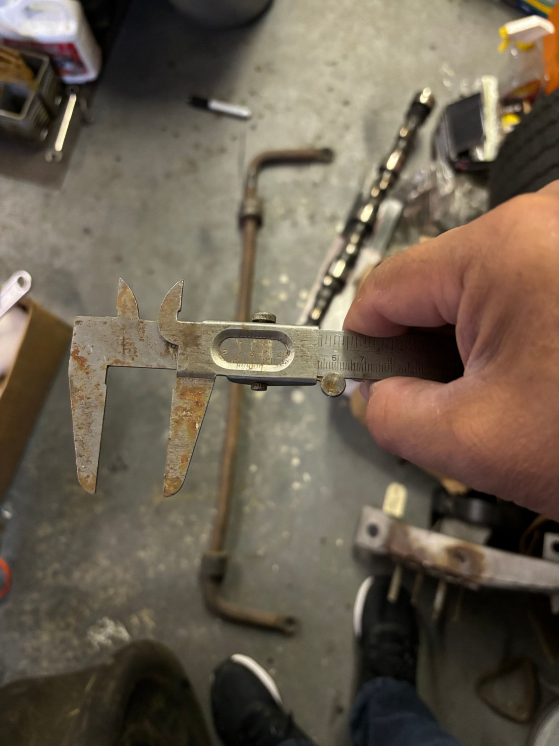

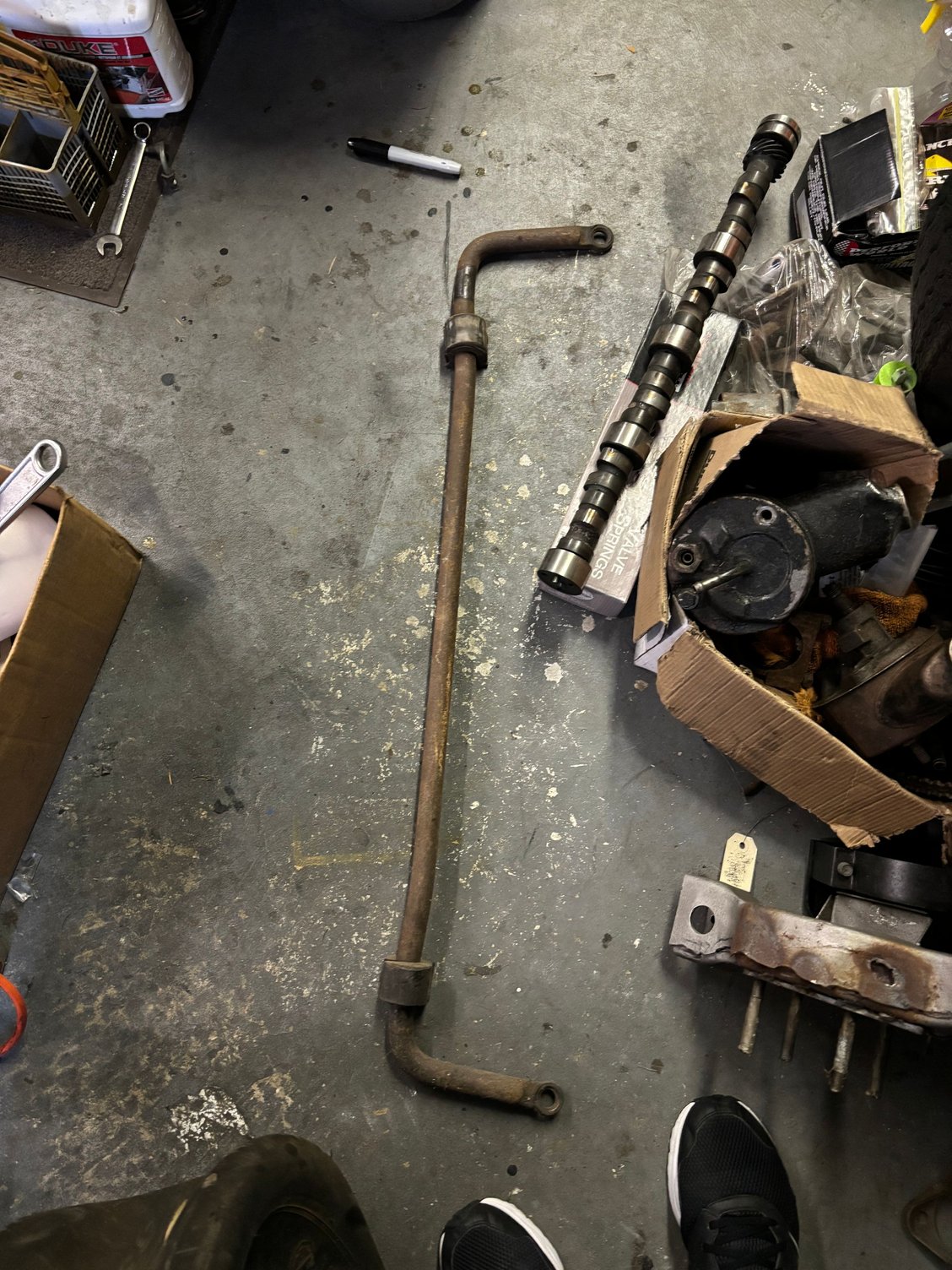

Originally Posted by Biff454
My front sway bar is missing. what size should it be? I have a 9 leaf rear suspension and 9/16 rear bar. The car still has its orig eng so I know its a real LS5 car. I found a post here that said all BB cars came with F41 suspension standard but that would mean a 7 leaf rear spring. Its a auto car. Its been off the road since early 80s. pretty unmolested car
here is a front sway bar with bushing and sway bar clamps
15/16
385.00 shipped for everything
extremely hard to find rubber bushing
i may or may not have the bolts but will look
I can restore 100.00
pm me if you need it
i also have a 71 454 auto that is 95 % restored
FYI ebay has just the bar for over 400.00
Thanks
grant
