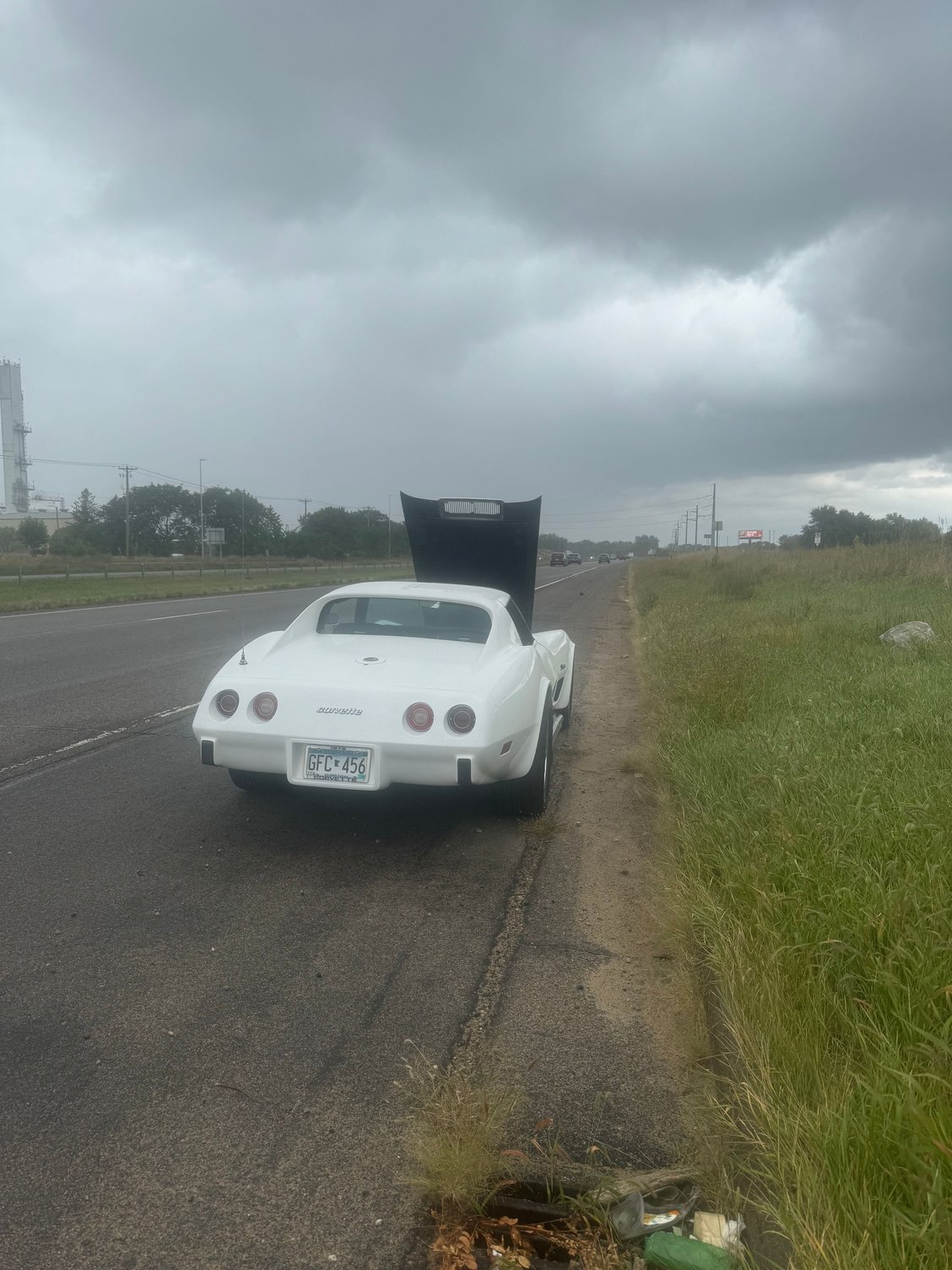

That is the case with classic car ownership, there will be occurrences like this. I always keep a small selection of tools in the back at all times, and if you don’t have it already I would consider getting a AAA membership.
On the side of the road because a cooler line came off and dumped ATF all over my headers.

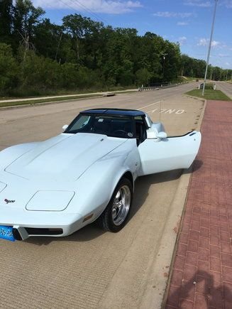

mine has been pretty reliable lately. My wife drove it to her work when battery died on her DD. I was out of town working. She said the 79 ran great. And got plenty of looks.

As long as they’re fixed and back on the road. It goes to show that small setbacks aren’t the end of the world and shouldn’t deter you from classic car ownership.
Funny enough right before I took that picture there was a 1971 Roadrunner broken down in the same spot. Freshly rebuilt engine going on a test drive, but had a bad ignition module. He got a tow out of there, I just limped mine home.

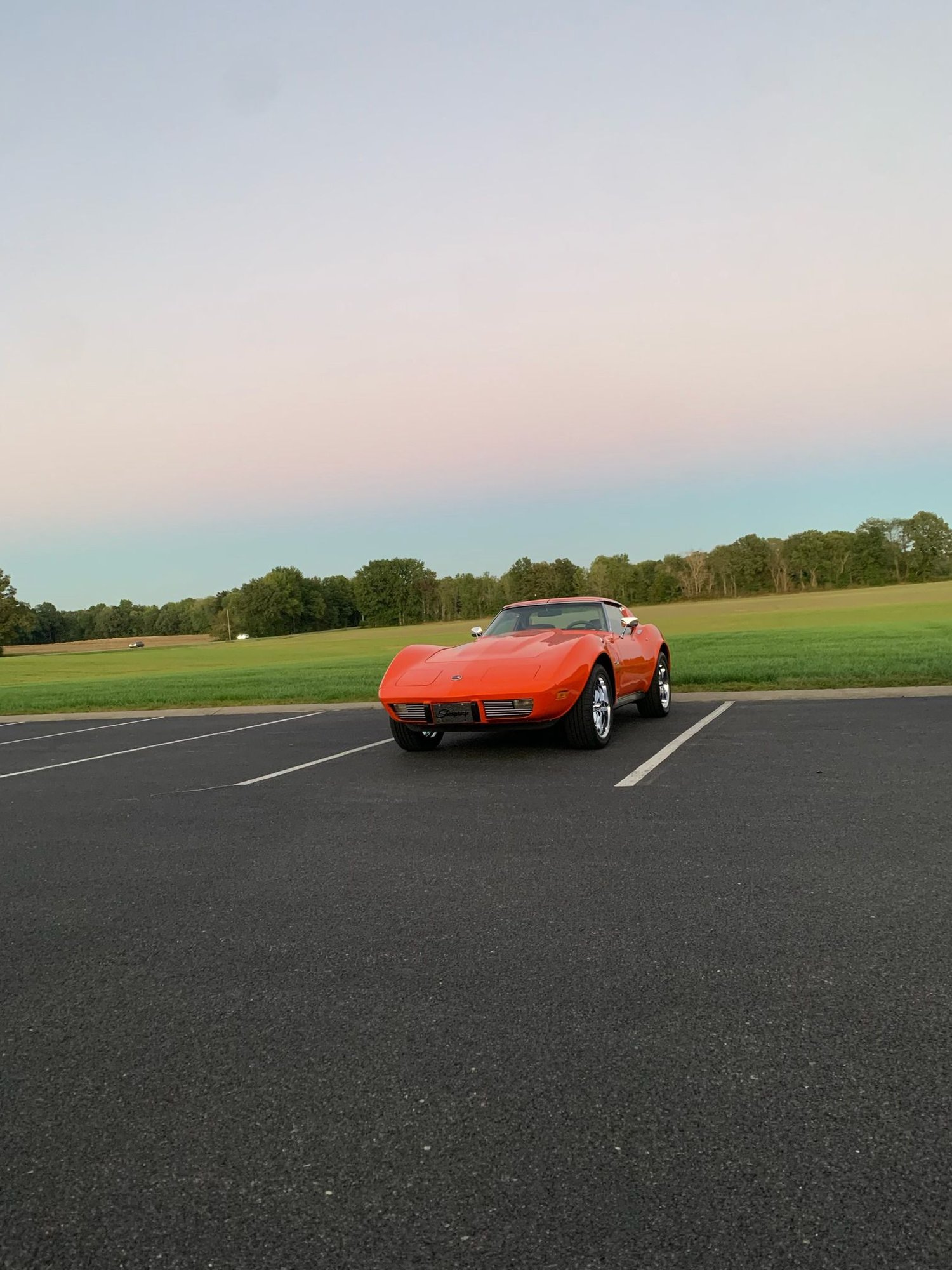

Ironically, my son took this pic right before we new it had a problem. Ive watched a few videos so I'm gonna go see if its a simple cable problem or not.
