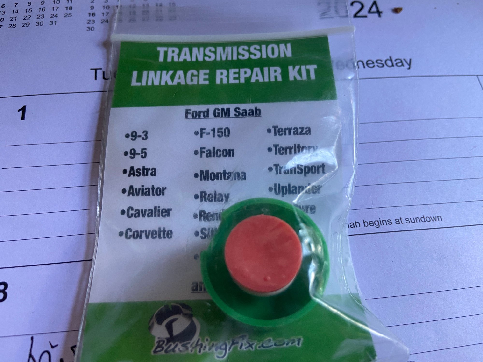

Welcome to the fun world of owning an old vette. In a year you will be surprised what you can and will fix on this car. Thanks in most part to this forum. And if it is any comfort to you, C6 automatic corvettes also have shifter issues with cables. this is my $10 repair kit that I carry in the car. Along with some tools to remove the center console bezel. I guess that as of 2012 ( my year) they still hadn't figured out how to do it correctly.
Interesting that my state of the art sports car in 2012 shared a part with Falcons.
