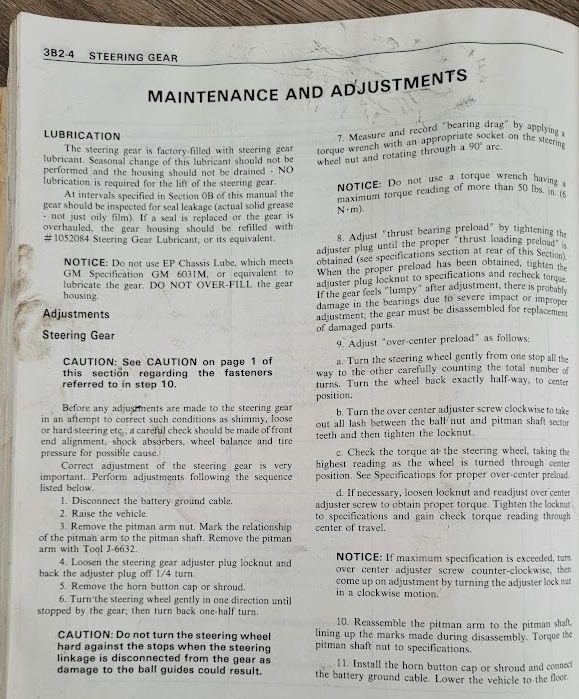

Anyway, a lot of us on this Forum are great at repeating the "correct" answer, without explaining why. You said:
Originally Posted by Chagjr
No one should be challenged when sharing information here at The Corvette Forum.
There's a place to post bad advice and not get called out on it. Facebook! There's a mix of good and bad advice on this Forum (and I know I've given bad advice in the past), but hopefully the "best" solution for the OP is also presented, and they can find it.
So here's the why of my advice. While not the be-all, end-all reference that some might like (I'm looking at you, stock timing specs), here's what it says in my 1979 Corvette shop manual. I'll type it out so it's easy to search:
Originally Posted by 1979 Corvette Shop Manual
Before any adjustments are made to the steering gear in an attempt to correct such conditions as shimmy, loose or hard steering etc., a careful check should be made of front end alignment, shock absorbers, wheel balance and tire pressure for possible cause.
Read the whole thing, there are lots of ways to screw it up. But the takeaway is that even the Shop Manual suggests doing anything else first.
