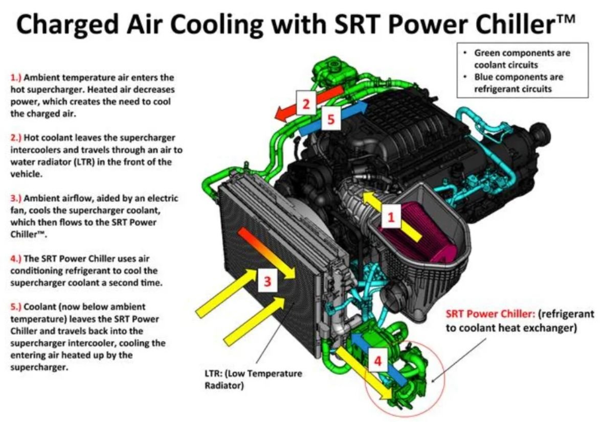

I think I get what you’re saying. I’m not a physics major like some people on here, but the law of conservation of energy would be what I imagine being the limiting factor on it though. Using the engine to make cold air with the AC system to feed itself. It sounds like a really cool concept though.
Reminds me of how the Dodge Challenger Demon uses its AC system to lower the charge temperature for the supercharger.

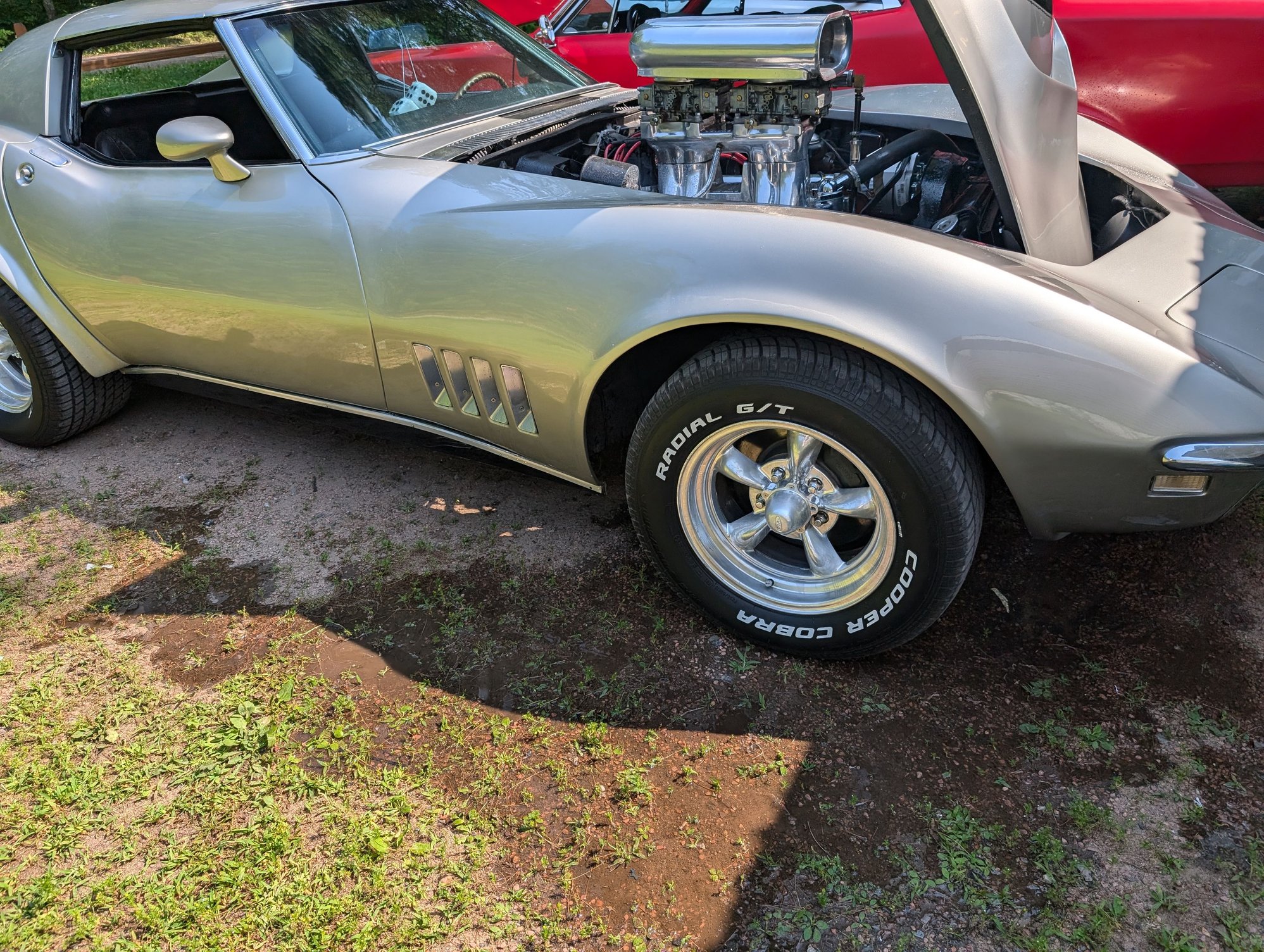

Actually reading this, I reminded myself that there sort of is. I did this test once with my particular hood and things went pretty well provided I was moving.
https://www.corvetteforum.com/forums...n-my-69-a.html
And as a bonus I got lectured on converting C to F!
I sort of remember somebody making airflow measurements at the gill area.
Here is a better picture of my hood
Back when life was really fun!

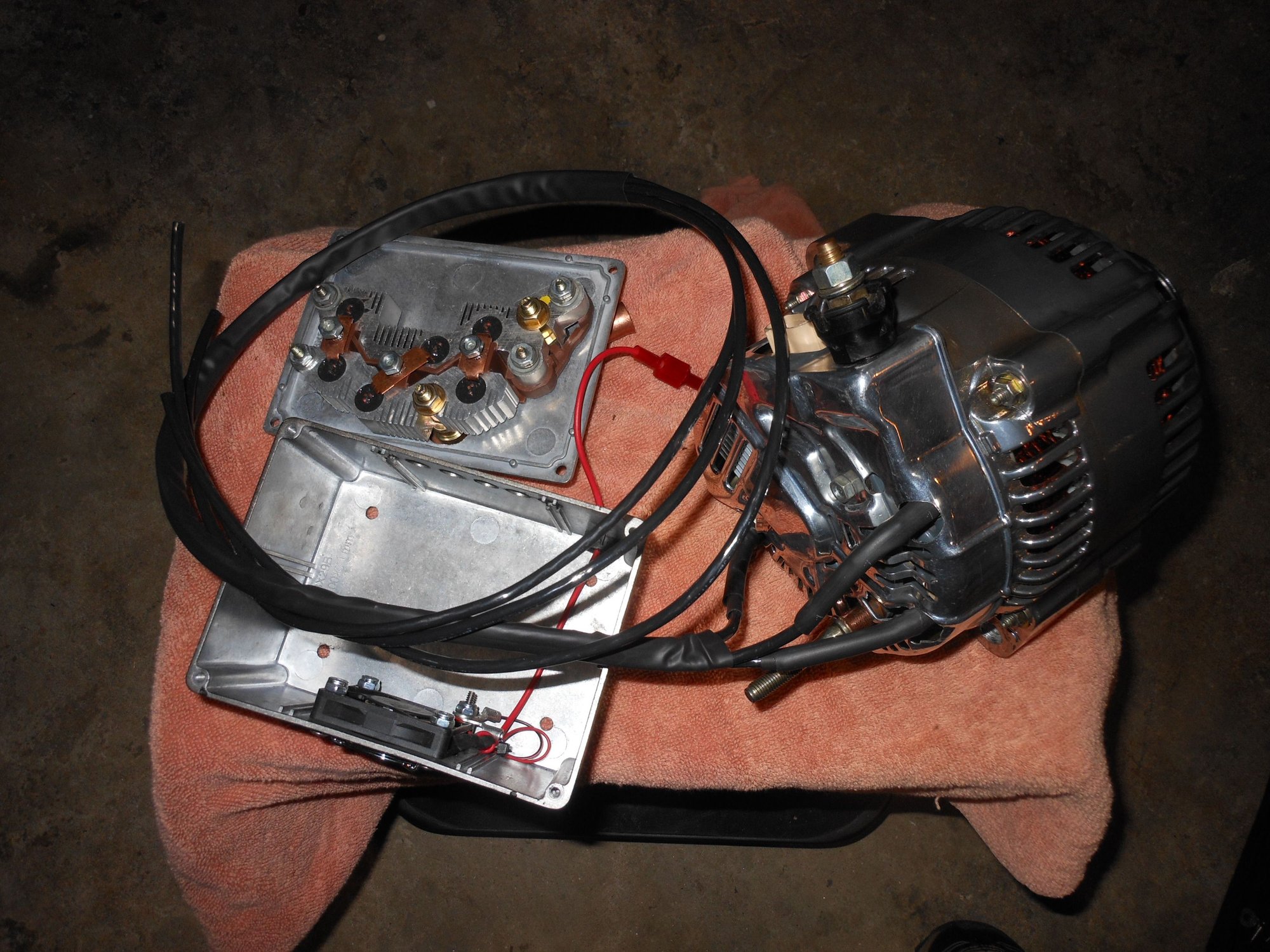

This is what I am running- I had no room on the front of my engine as I'm also running a 3 stage dry sump pump.
Here's an electric AC compressor- designed for 18 wheelers to run AC in no-idle states-
Has an inverter- and draws about 30A full tilt
My alternator to run it - has an outboard fan cooled rectifier- and it's a flat wire Nippon Denso 190A- with just under a 100A at idle ( smallest pulley I could find!)
This is another thought- cooling your fuel with the AC system- much easier than trying to cool the air
And to me makes more sense as in cooler temp you wouldn't be running your AC.
I'm currently just using a fuel cooler on the return side as it was heated up by running around underhood-

Since you requested.
