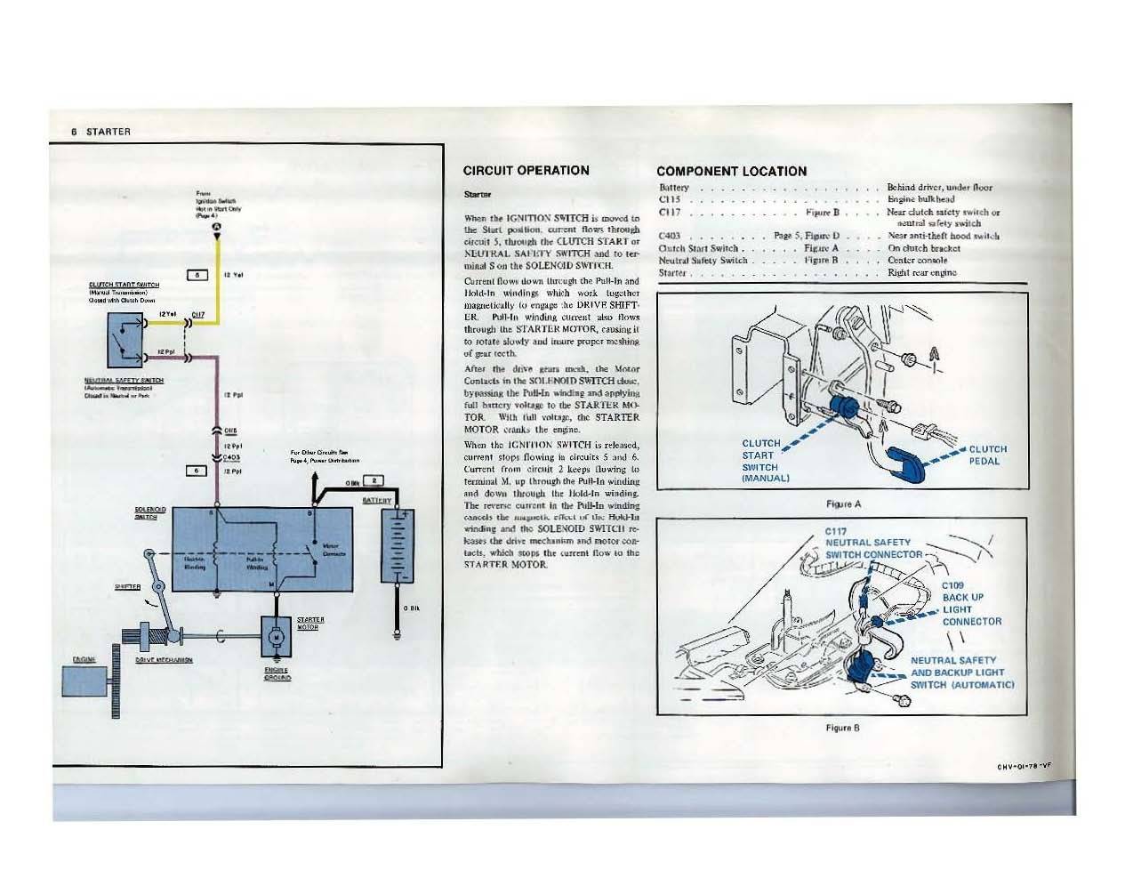

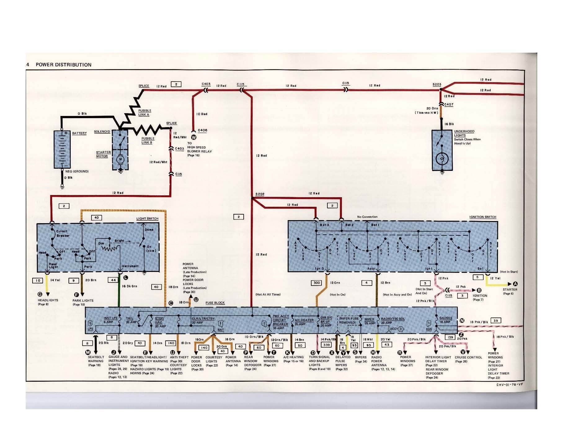

Here are 2 drawings for your 78...

And in combination with above you can also get a wiring diagram from Papawana by writing him, believe he needs your email address. The diagrams are great to keep on file. !:

Thank you for the diagrams. I will be replacing the ignition switch today and let you all know.
