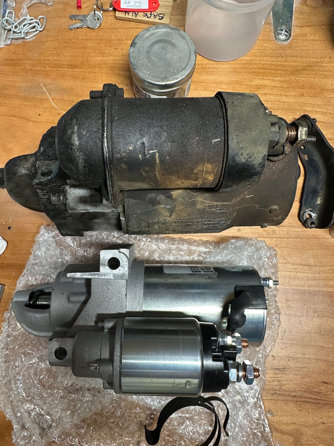

Hi All, just to put a close yo this issue: I ended up purchasing as starter motor from Quality Power in Yucaipa, CA. It was a very straight forwards swapout and good support from the guys there. The car has been starting flawlessly ever since on the very few times I was able to take it out since then. Today was my big heat soak test, taking the car up the mountain in 95F heat. Started just fine when I got to the top. I'll still have to follow up on all the other great suggestions, but for now I'm happy to have a car that starts when I want it to, not when it it pleases the car . Thanks everyone for your help.

I bought their in 6562N. at USDc125.00 + shipping. The guys were great at helping me identify the right one for My L-82 Pace Car. Old one popped right off, new one right in. As 'plug and play' as it comes the bracket that supported the old one at the back is no longer needed with this smaller and lighter one. See comparison of the two motors in photo attached.
