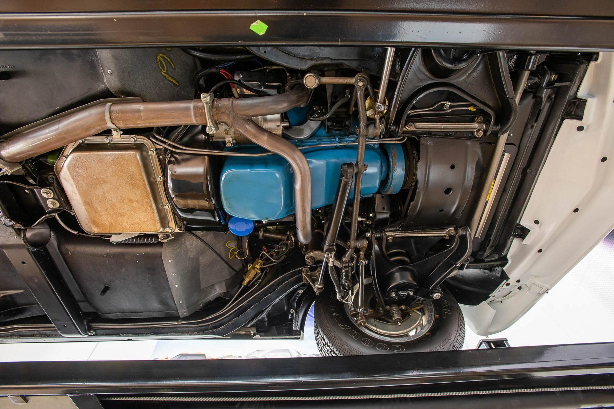

Hi All, My '78 L-82 pace car suffers significantly from heat soak hot start here under the Spanish sun with most days in the 90's. Having read a lot on this forum about causes and solutions, I've for now wrapped the exhaust a few days ago. Still burning off the smoke and still early days to find if that did the trick (bit of a scare at the gas station yesterday when my wife yelled 'there's smoke coming from under the hood, we're on fire', to learn later that the smoking is part of the process of curing). The original Delcro starter has taken a beating over the years though (see photos) so I decided to replace it with a mini/gear reduction starter. Most posts I read are somewhat older and I'm wondering if any of you want to way in on what options to go for: Tuff Stuff, Powermaster, CVR-5323, etc. Your insights are as always invaluable and appreciated.

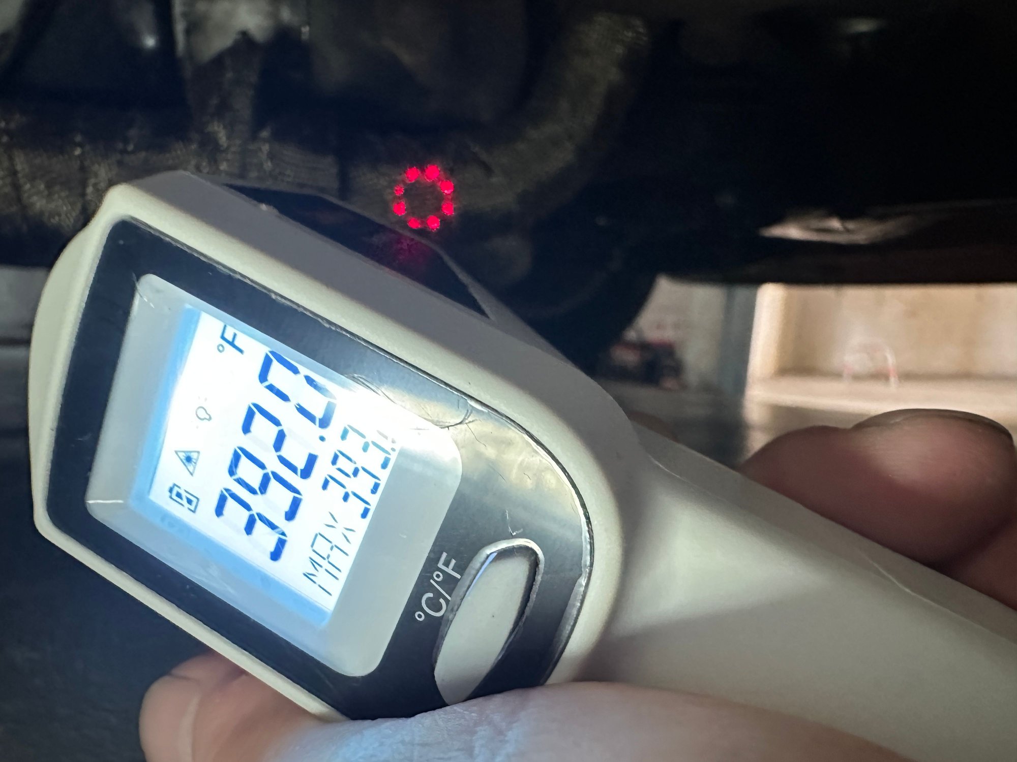

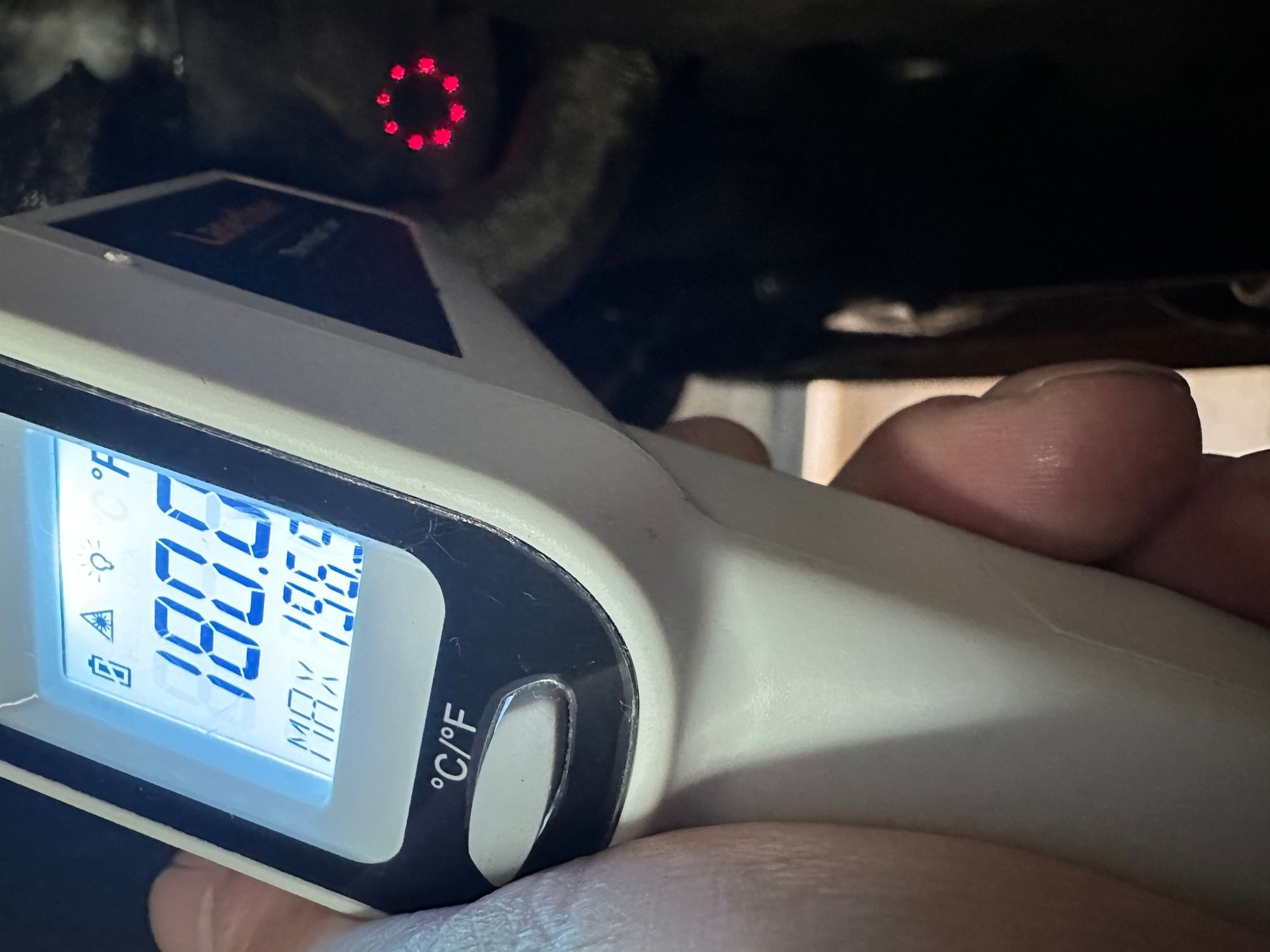

Hi, The car seems to be running fine. It's new to me and I have nothing to compare to in a V8 version. I did find the heat in the engine bay significant, especially compared to my little Alfa Spider of same age (half the cylinders, half the car weight, but a heck of a lot of responsive drive fun. the engine water temp gauge indicates a temp of well below the 200 mark, around 180 I would say. Oil Pressure just below 40. Car runs smooth at correct idle speeds and accelerates fine, albeit somewhat more sluggish than I had hoped for (the Spider has the Vette beat by quite a bit in terms of throttle response).
After a 30 minute mostly slow city start/stop drive this morning with a 3km faster bit and 1km uphill section at the end this morning I measured the temps: 556-624 at the manifold, 392 at the heat wrapping in the bend around the starter motor and 180 on the starter motor itself (which I found surprisingly low considering the other temps). That's with the heat wrap in place and I didn't actually measure any temps prior to installing that so can't compare. Outside temperature probably in the low 80's at the time.
Does that all sound reasonable?

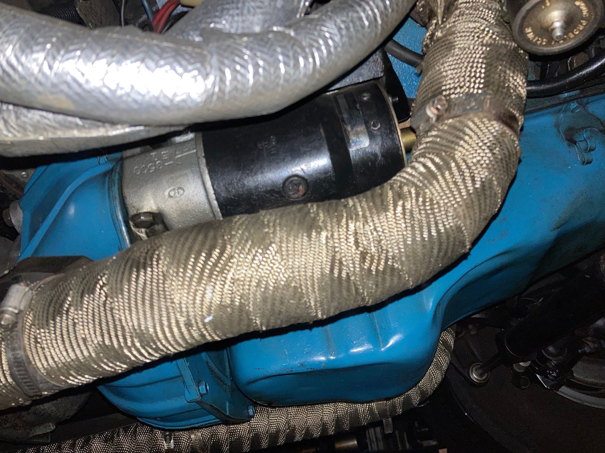

wow, your car is nicely original, very nice. you even have the oem solenoid heat shield.

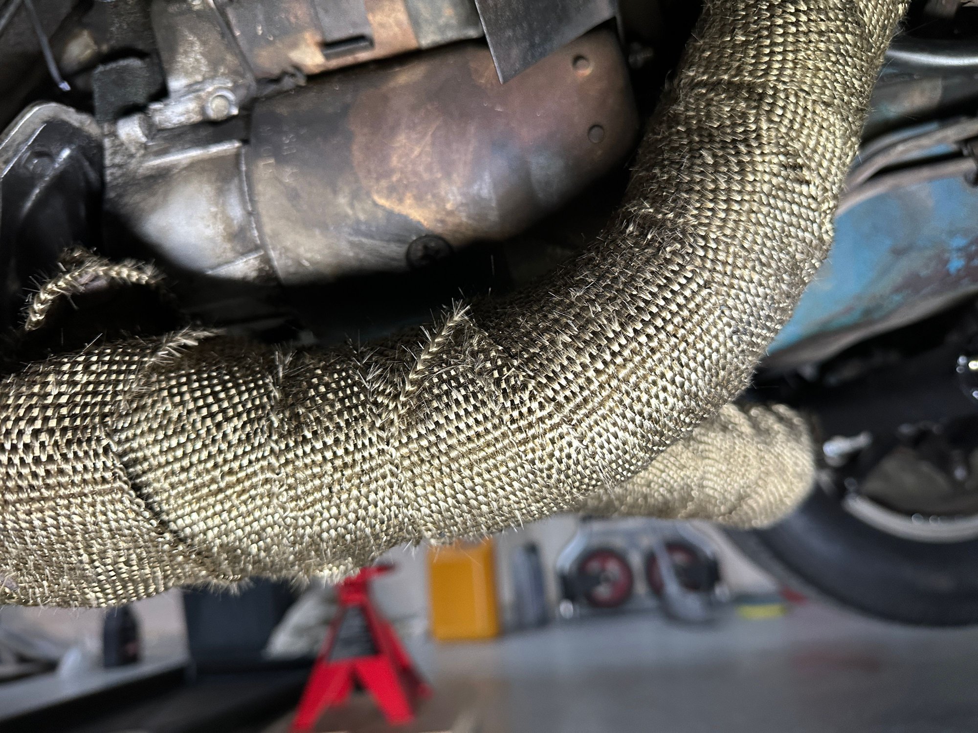

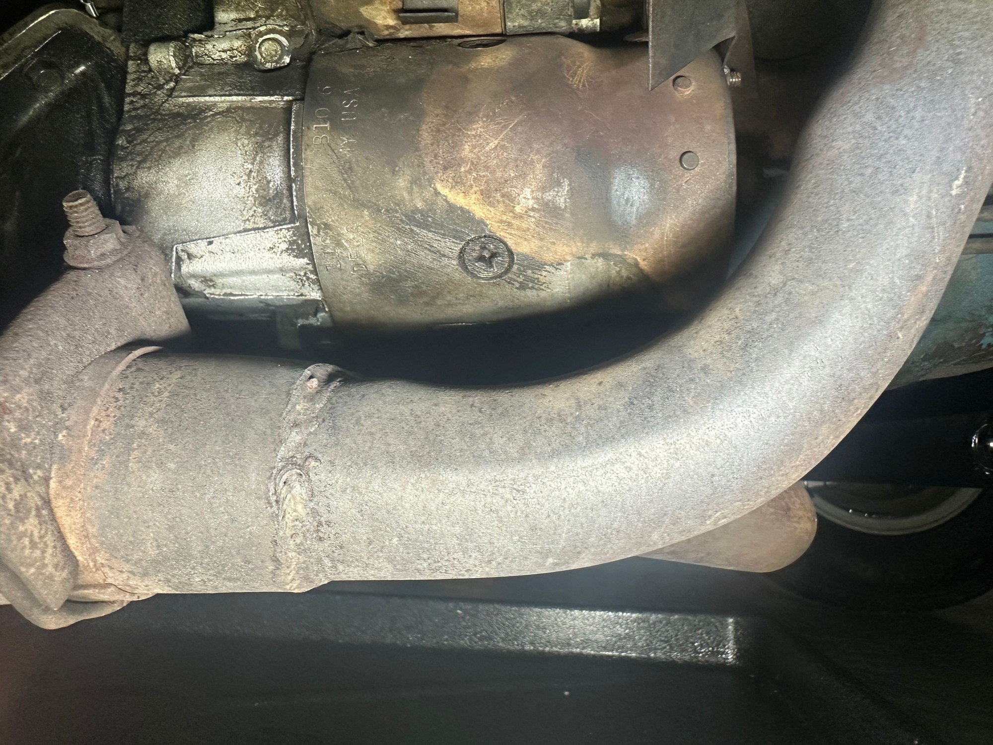

Before you change out starter, it appears that the pipe is very close to the starter. It does not look like OEM pipe bends, you may want to start there.
That DEI wrap does work well, you may even wrap tighter (closer wraps) to improve heat protection as well.

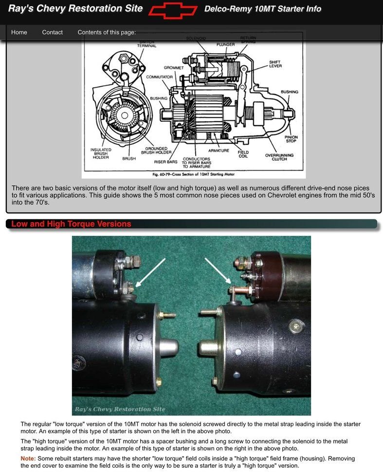

Also note there are brown bakeolite solenoid caps that were OEM and were to be able to withstand more heat i think. Solenoid can be the issue as well..

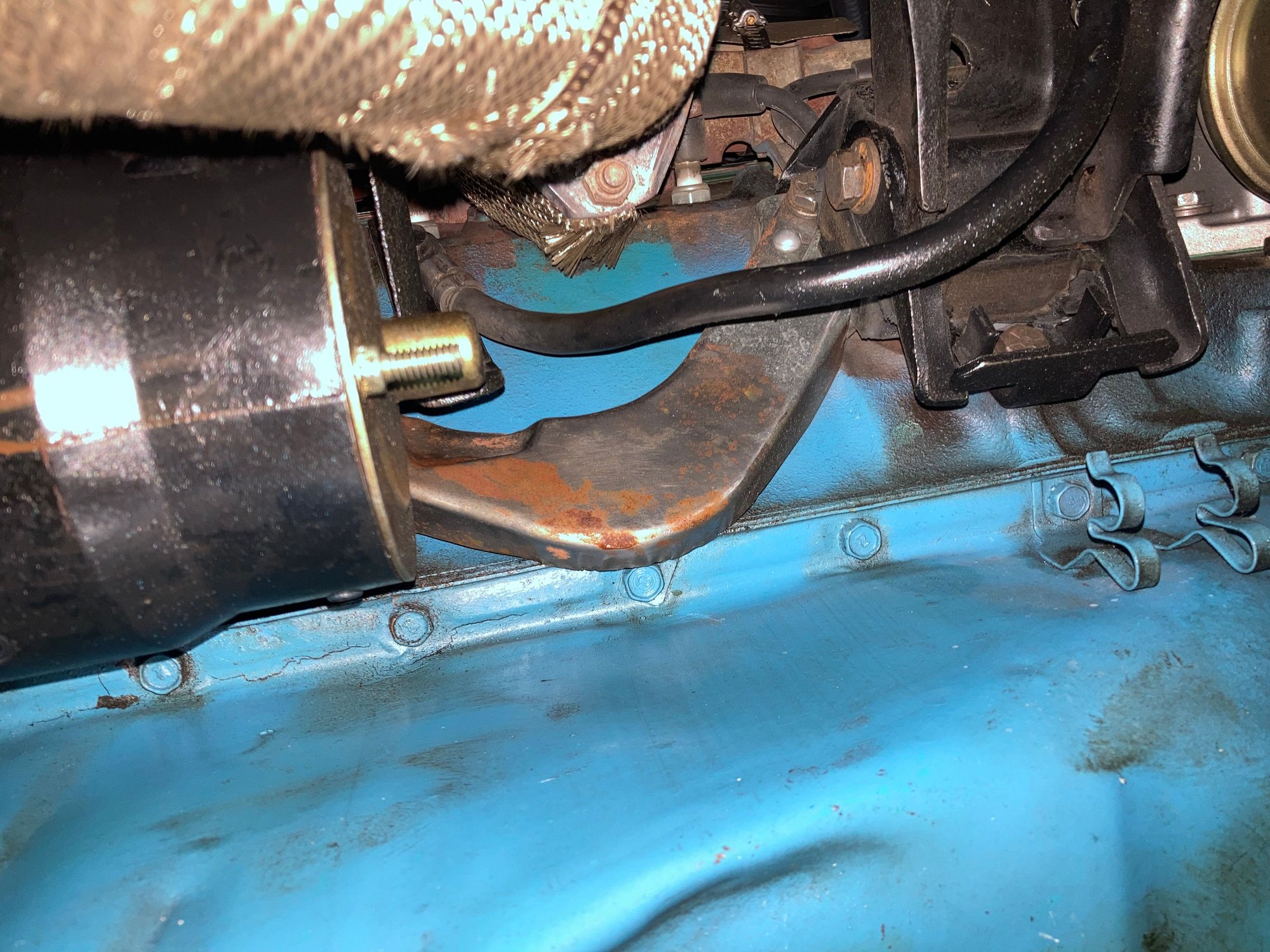

i also took some pictures under car to compare.. forgive the filth, its been about 4000 miles since under body clean up inspection..
I think the L82 got a high torque starter, you can tell if you need a spacer for the hot lead tab into starter from solenoid.

Thanks! yes, I do have the high torque starter. The car is indeed very original in many ways and i'd like to keep it that way as much as possible, but trusting it will start when I need it to is rather important, hence the quest for a more reliable solution (and I wouldn't mind if it was a bit more of a sporty drive ). In a way I'd like to just refurbish the current starter (if needed) and use the DEI wrapping on exhaust and starter if that reliably would solve the problem. (the one I have now came from Amazon here in Spain and is a generic chinese made product). It's not easy here in Spain to get parts and to find a shop that would be able to refurbish a starter is an impossibility. I would need to bring it with me to work in the USA (San Diego) and find a place there that could do it.

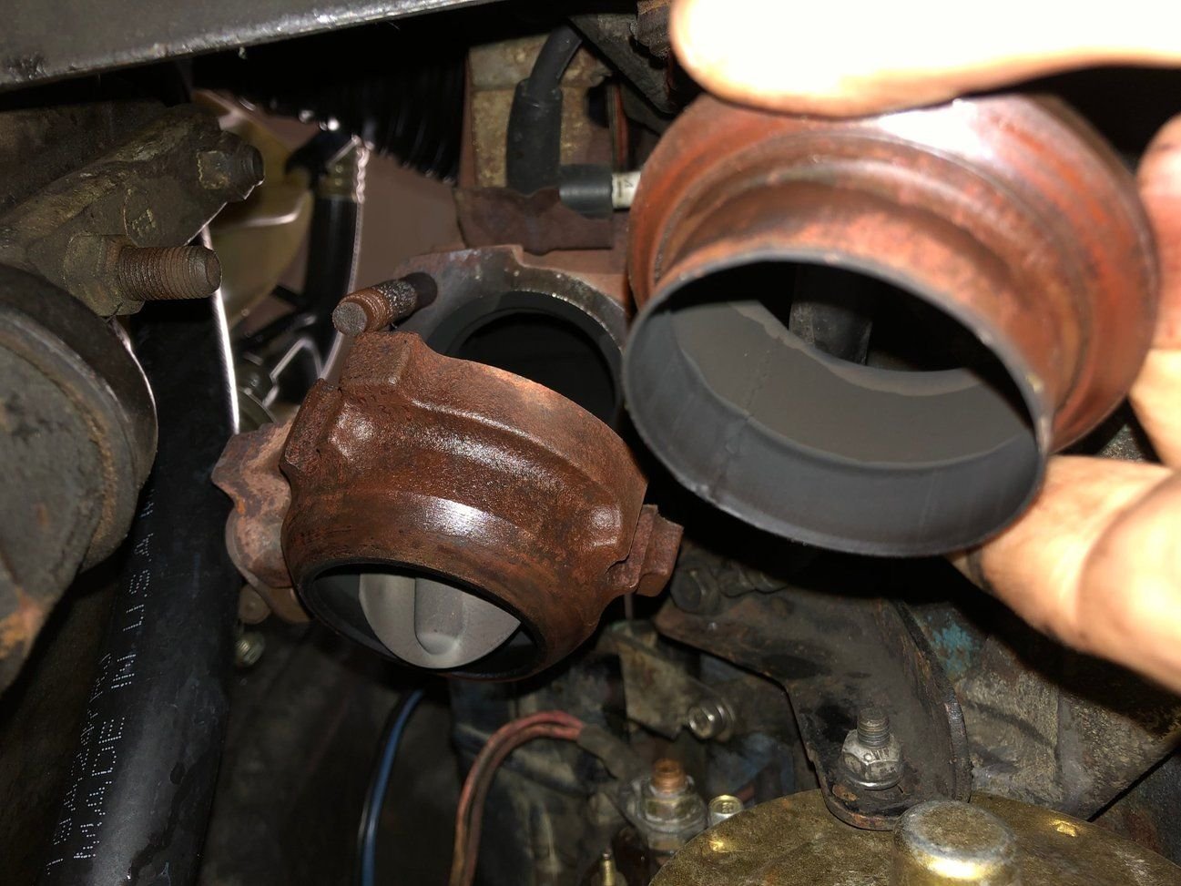

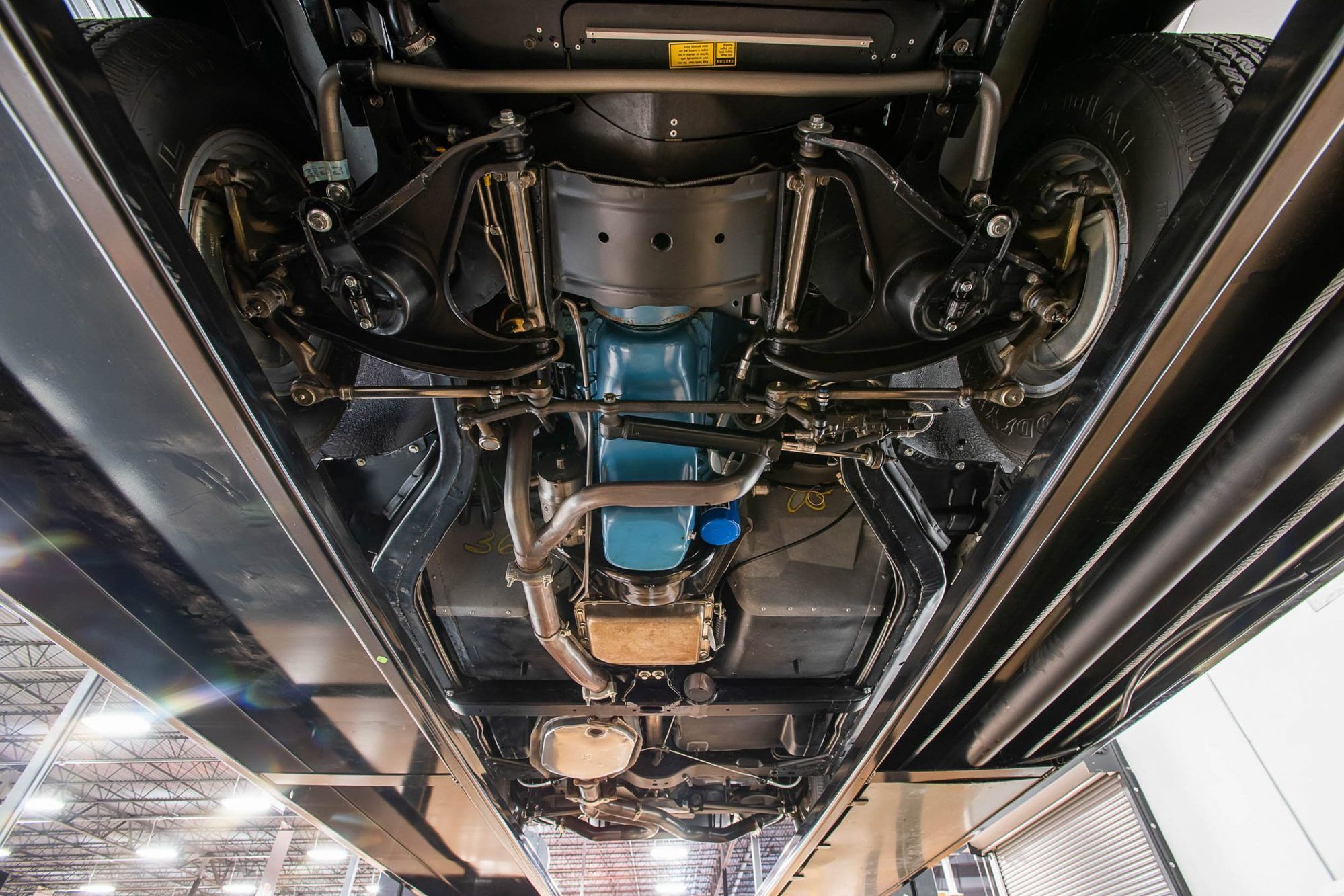

i think you could have someone get that pipe further away from that starter. . A local muffler shop may help here?
pics of entire exhaust helpful too. not sure if you still run CAT or true duals. probably biggest bang for buck would be dual exhaust L82 style and probably fix your heat issue.
NOTE- this thread walks thru my exhaust mod like yours . note the preheat valve was removed and recommend you do as well. since that post i put on a spacer. this allows pipes to sit a little lower away from starter, although mine was fine bolted tight for a while. Duals also eliminate one pipe by starter
https://www.corvetteforum.com/forums...79-4speed.html
should look like this depending on cat or not..
i recommend removing this
this is removed but put spacer in months later for proper pipe alignment as it puts it even further away from starter. note the transition from 2" pipe to 2.5 inches on the L82

I do have the original pipe with cat as shown in these pictures. I did think about the true dual pipe solution but for now will have to put that on a back burner: Importing those into Spain will be rather costly. Based on experience with other, smaller items the cost can easily doulbe or triple with freight, taxes, clearance fees, etc. I also need to look into originality of the car. It is regisered as a 'historico' here and that comes, along with many other things, with the requirement that the car is original without significant modifications. A 'lab' does the research first and documents the car's tech specs. Now I doubt that the exhaust change would ever be detected here since they don't really see corvettes here at all at the technical inspections. If it's not mentioned in the report I'll keep the dual pipe option on the table, otherwise I'll have to forget about it.

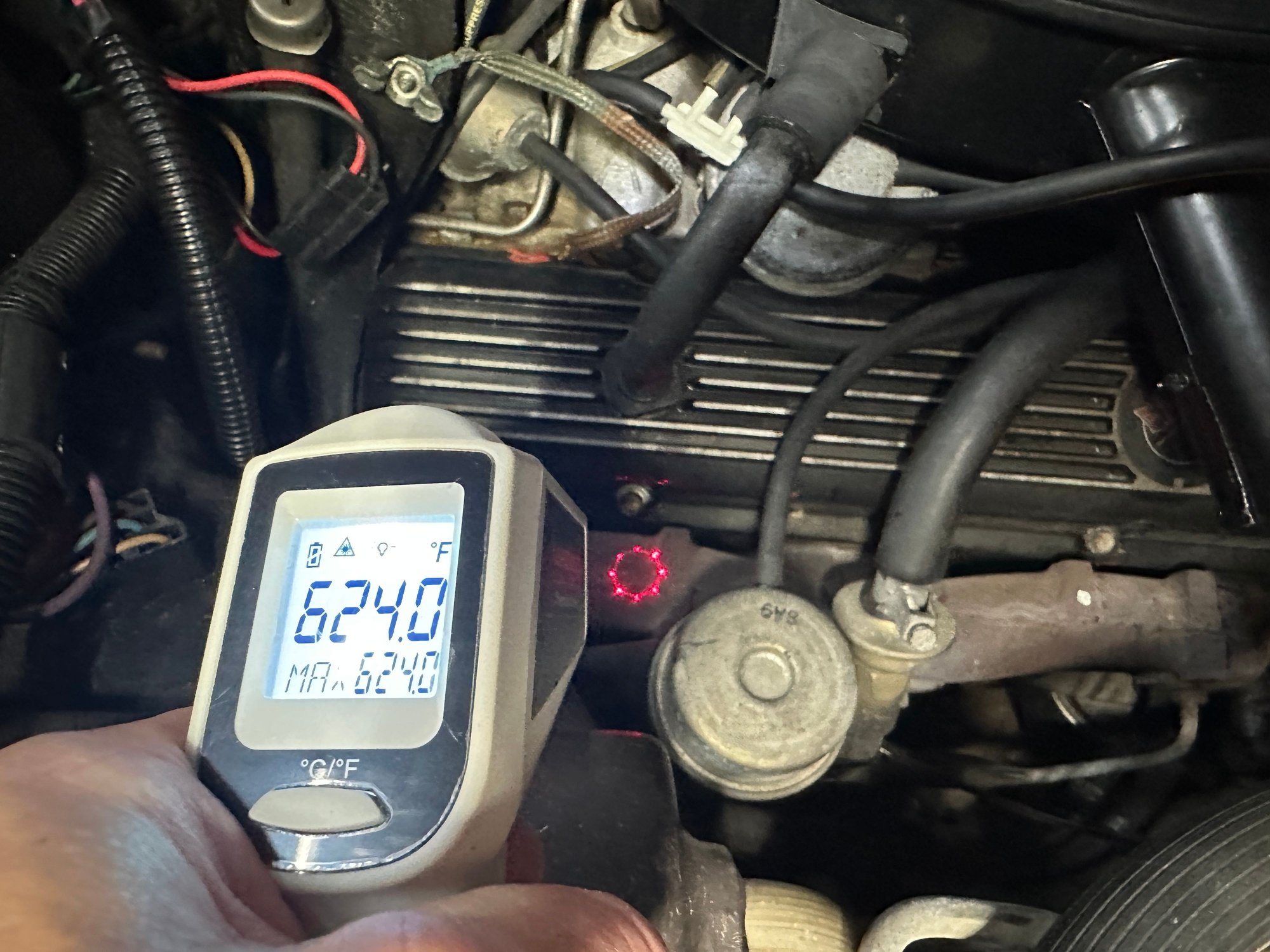

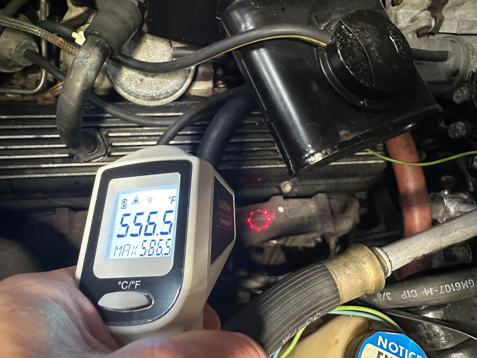

Hi All, thanks for the input on this. I did check the voltage at various points and don't seem to have any significant voltage drop at the starter, grounds etc. I'll be picking up a heat shield and installing that first, see how the car does after that and the already installed exhaust wrap. if it continues, then I'll move towards a GM mini starter I guess.

I find it hard to believe those exhaust manifold temps (600) are normal.
I have headers, so I can't compare. However, each single header pipe runs from 350* - 400*.
Your manifold is so hot, I bet it glows in the dark. I have seen this issue before.
I believe what you are seeing is late valve timing. Basically, the IGN is firing closer to the exhaust stroke.
Maybe too much slop in the timing chain.
Maybe valve-lash set too tight on exhaust valves.
Or, valve seats in the head are burned resulting in leaking valves.

Although I think retarded ignition timing is a more likely scenario. Regardless, if originality is not a big concern, switch to the smaller gear reduction starter. I use the starter out of a 1996 full size chevy truck. Probably the same starter as was previously mentioned for the '99 Tahoe. Haven't had a problem since. As a bonus, it's also lighter than the original, and easier to install since it's smaller.
