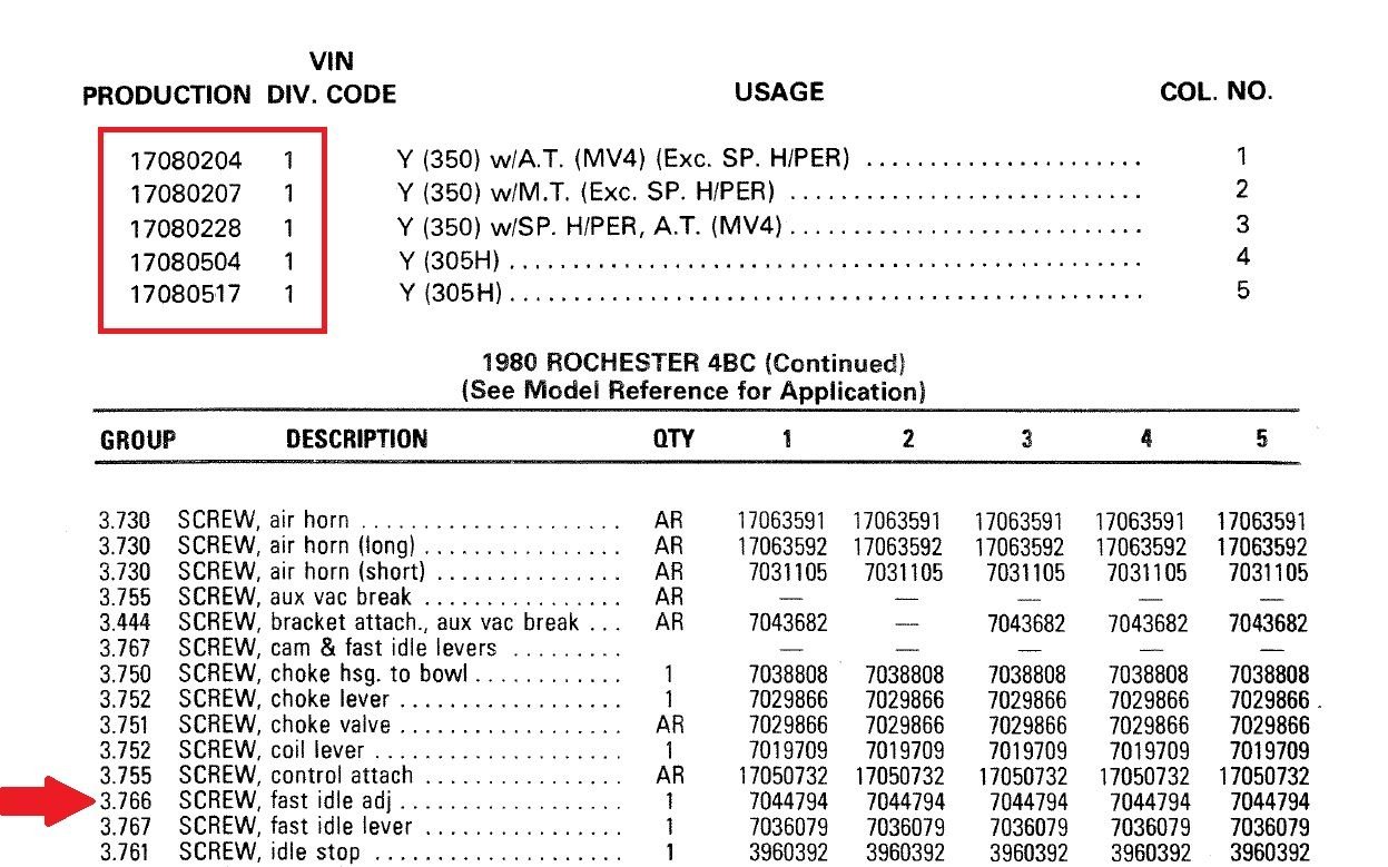

Those numbers are not GM part numbers. Here's the fast idle related parts from the
GM Parts Catalog.

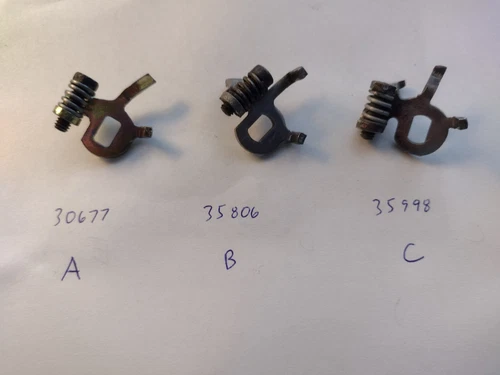

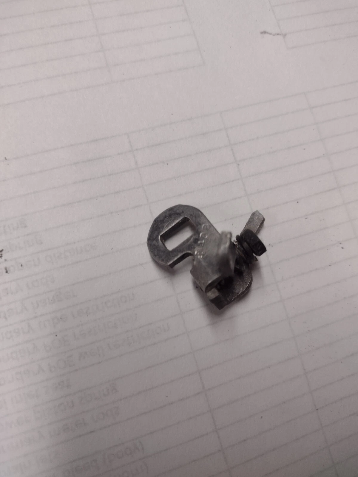

Thank you! Here are the options I found:
https://www.ebay.com/itm/155587601566
Rochester Quadrajet fast idle set screw assmbly - 30677,35806,35998,498 CHOOSE1 - Picture 2 of 5
Rochester Quadrajet fast idle set screw assmbly - 30677,35806,35998,498 CHOOSE1 - Picture 4 of 5
It seems that 498 would be the correct part.

For 78 and newer year models using the Parts & Illustration Catalog you need to go to the end of Gr.3.00
In OP case, the part number for the Fast Idle Adjust Screw is the same for ALL 1980 Carbs.
Normally you would need to record the carb number and then follow the column number 1-5 for the correct GM part number...

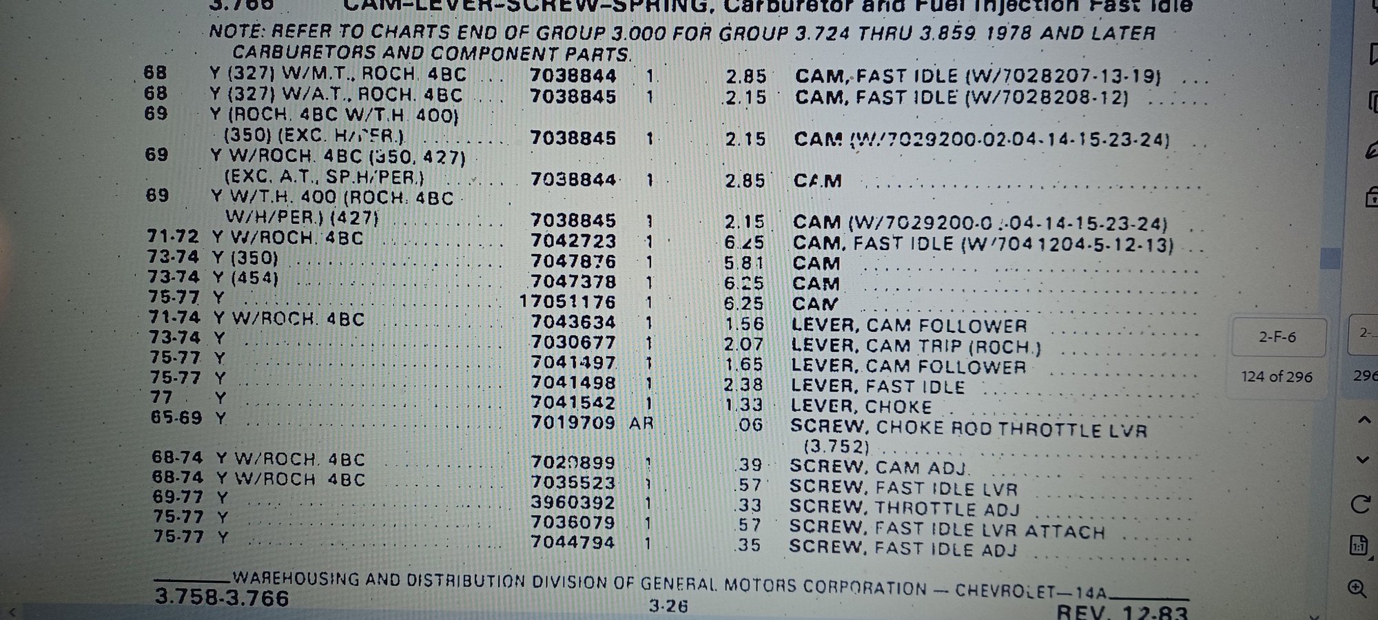

GM part # 7041498 is the fast idle lever for a 1980. And a lot of other Q-Jets.
