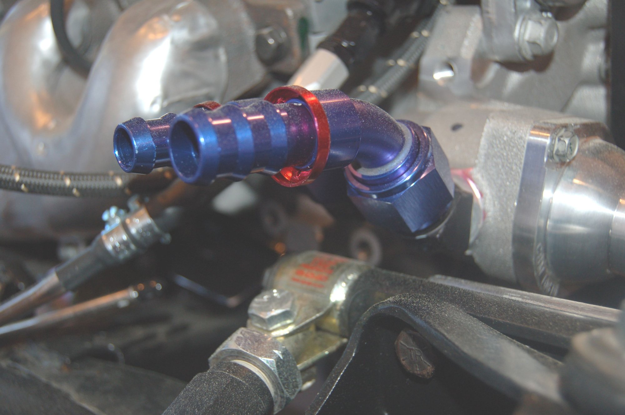

In this picture you can see what i did to the water pump to fit a C3 corvette.

Been awhile but I believe that's the way I did it on my 71 C3 with an LS1 swap but I used hardware store NPT fittings and "stock" rubber coolant hoses.
Do you happen to remember the size of the fittings you used?
