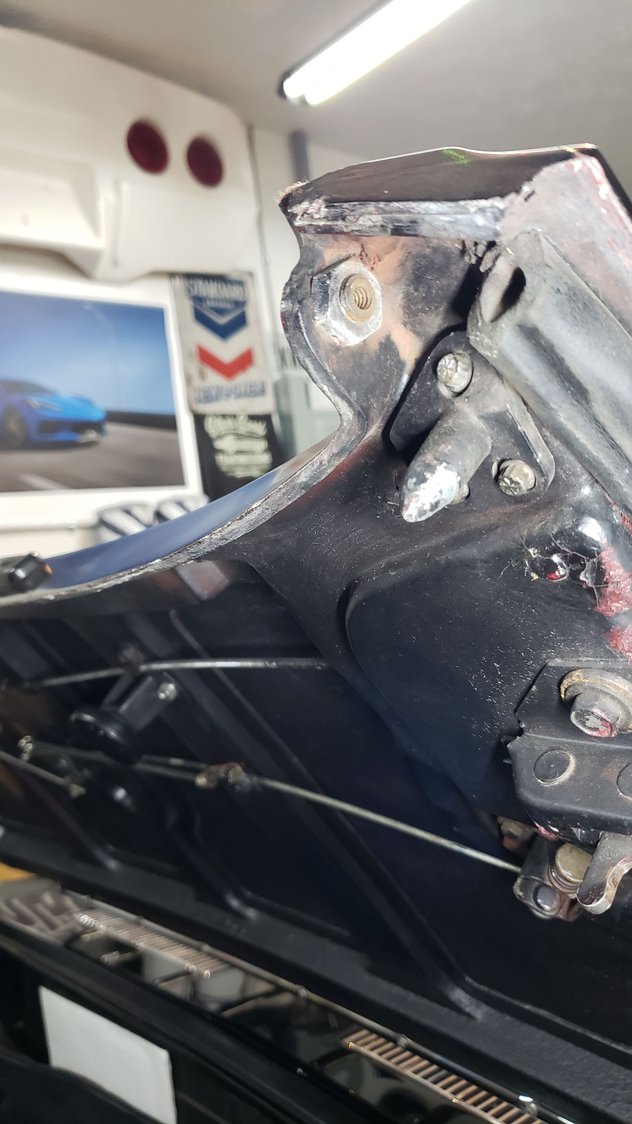

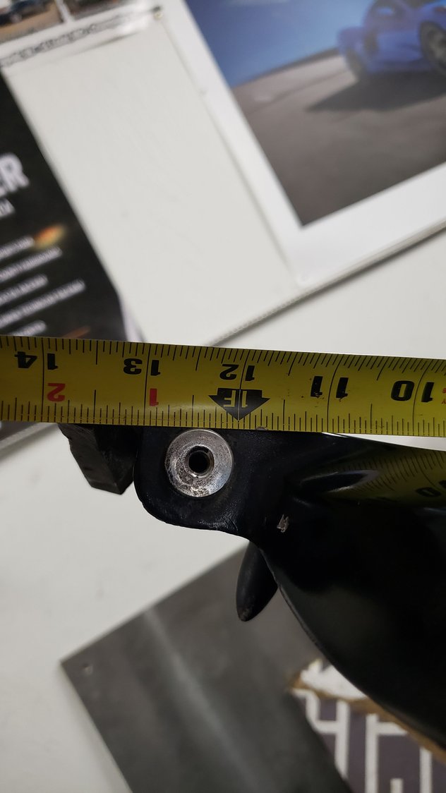

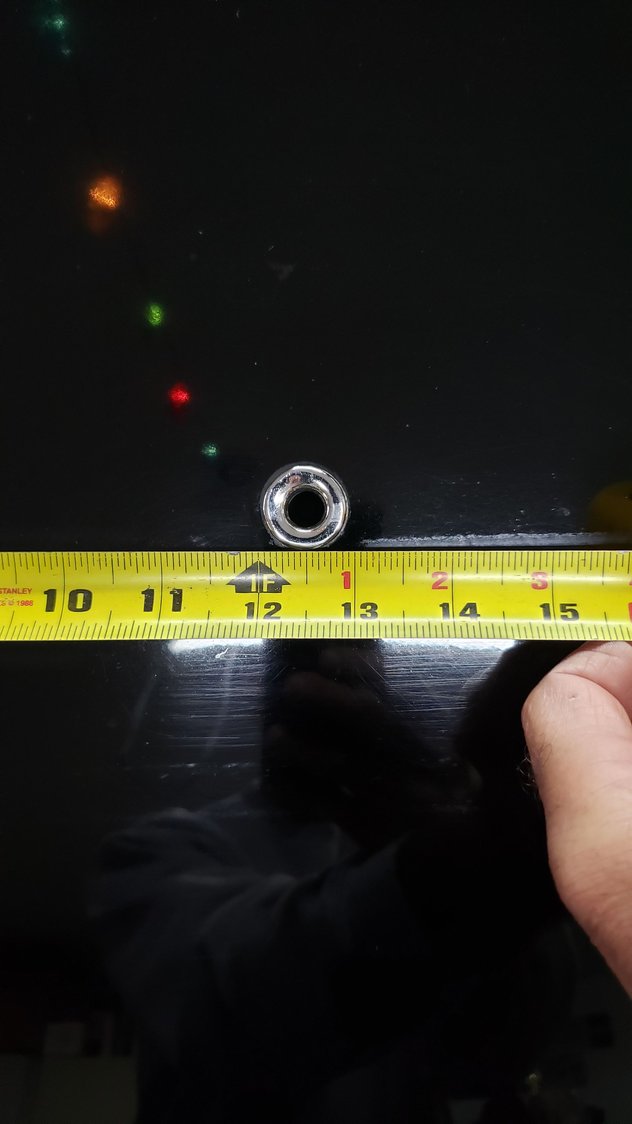

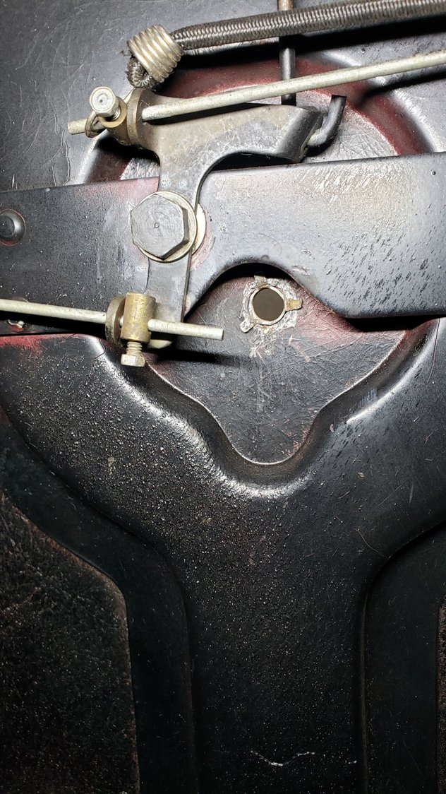

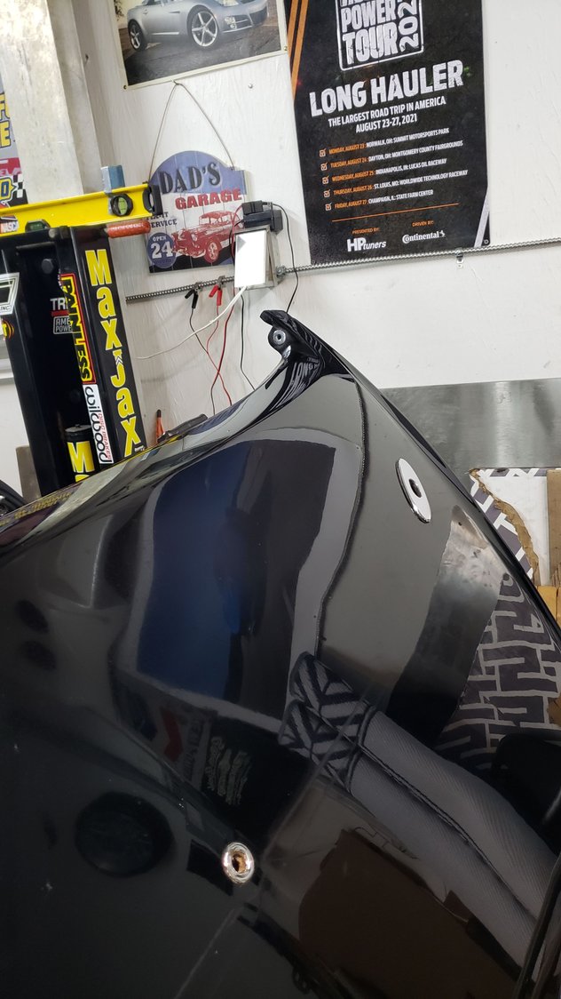

Hopefully this pics can help you visualize what's used.
See the center hole,, right side pin latch,, right side bolt hole.
This is underside of the left side bolt hole showing threads for bolt,,,
Underside of center hole showing the trim hold down tabs.
Top of center he trim,,,
Right side bolt hole,,,
