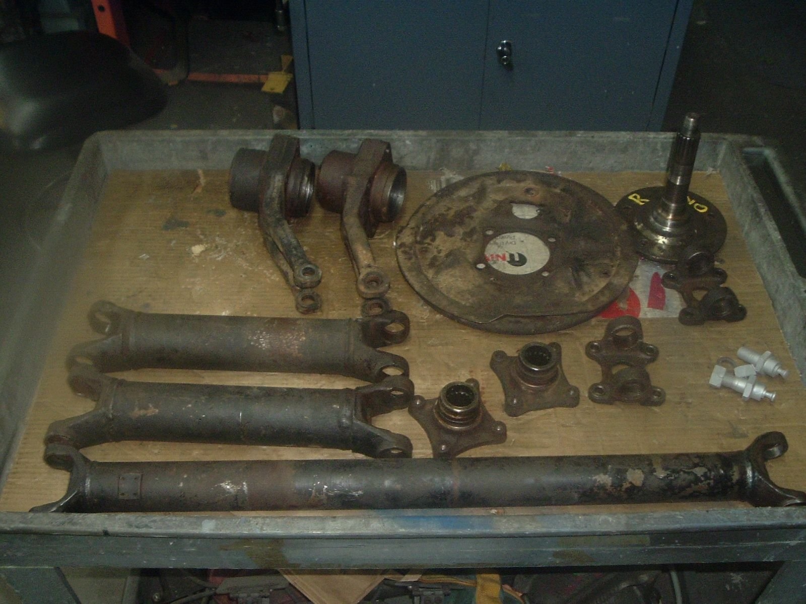

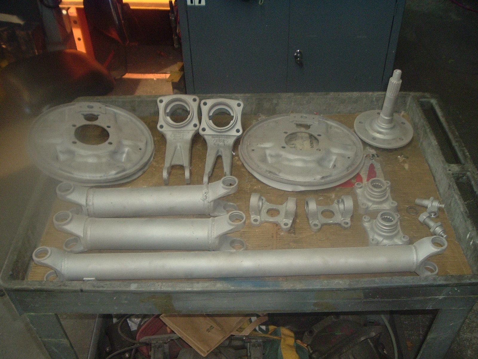

Many times, the joints are really tight in the yokes and flange. Many flanges and yokes have been wrecked by inexperienced people. Using a plate is critical and while not required, using a oxy/ace torch to carefully cut the joint cross out will transfer heat to the caps and they will tap out. Done correctly, there is no damage to the parts, incorrectly and new flanges or shafts may be needed.
I got the shafts blasted and just need to know how the finish is going to be. Originally, they were not painted but for a driver it works best.
