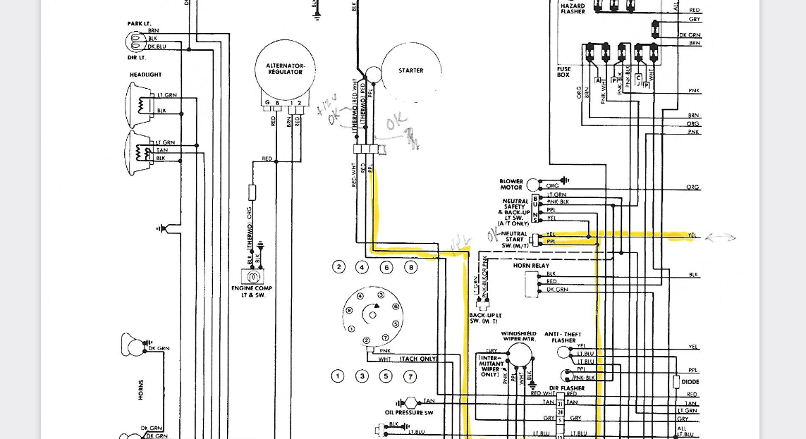

The yellow wire does come directly from the ignition switch, if everything else in the car that requires the ignition to be switched on works then you must have power to the ignition switch. That leaves 3 possibilities
1) the ignition switch is faulty
2) the ignition switch is not adjusted properly
3) there is a break in the yellow wire between the ignition switch and the neutral safety switch (there is a connector for the neutral safety switch wires near the switch, that could not be connecting properly)

Originally Posted by DWAVette
You mention you have an automatic transmission. Is that a “Park” switch? I thought a Neutral switch was for manual transmissions.
Either way, are you supposed to have positive 12v through that wire, or does the Park switch complete a ground for the negative side of the starter circuit (the purple wire on your solenoid)?
I don’t have a wiring diagram for your model, so I am just asking.

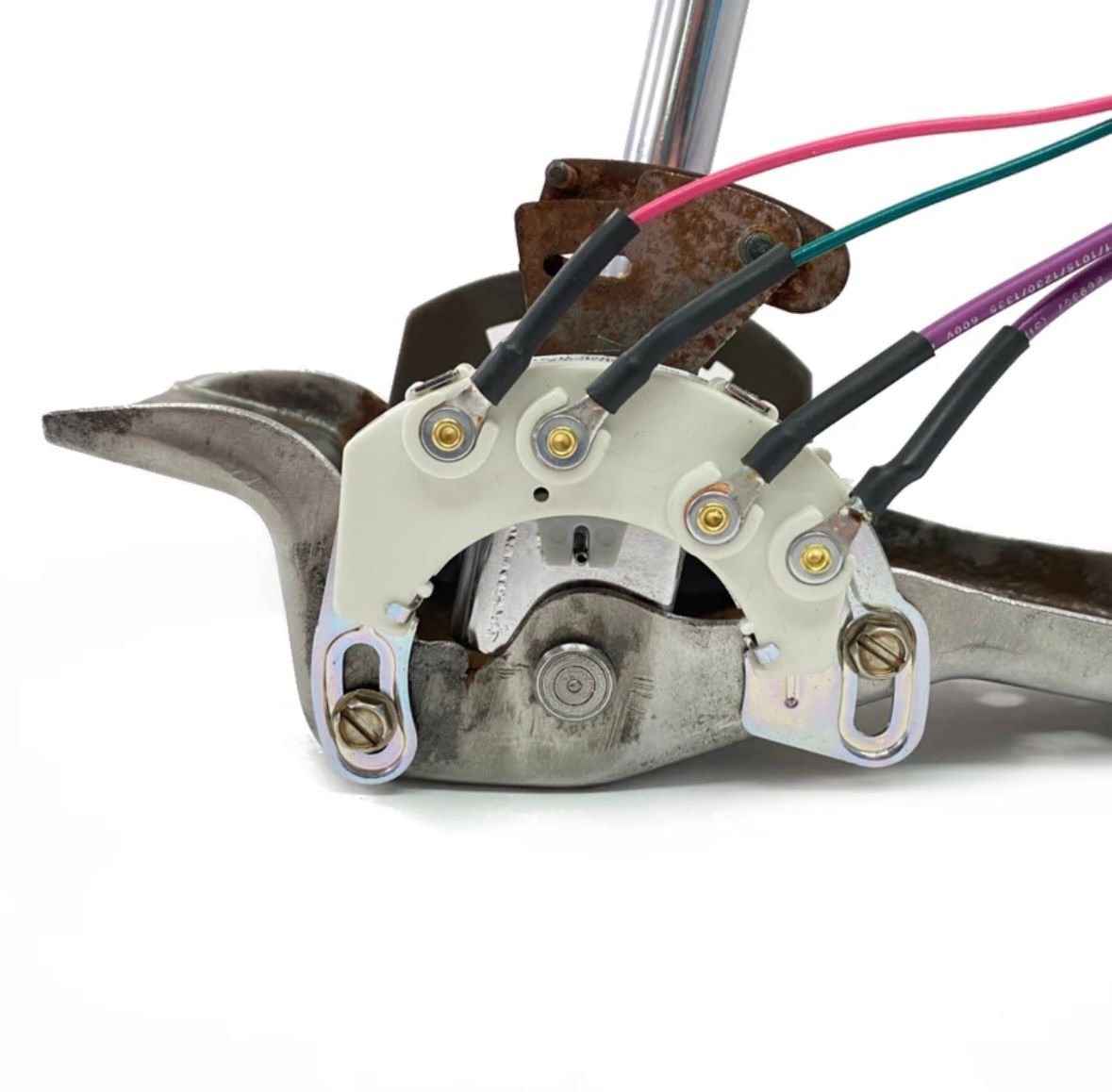

It’s there
Although there isn’t a yellow wire. OP, could you post a picture of where you’re checking?

Originally Posted by Piersonpie
It’s thereAlthough there isn’t a yellow wire. OP, could you post a picture of where you’re checking?
